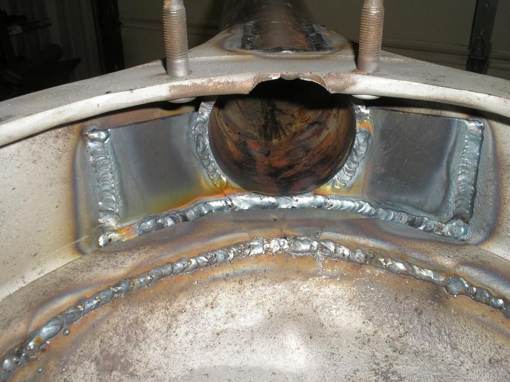

    I didn't get much done in the last few days but I did get the inside plates welded in the housing. They are hard to get to to weld and it was not one of my good weld days anyway.[​IMG]

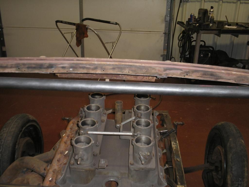

    The housing lined up under the car. The bar from the trans to the housing lines up the pinion ( 2 degrees drive shaft to pinion) then lined up from front to back and side to side. Then I tacked some tubing to the frame to hold in in place while I build the traction bars.[​IMG]

    I used the wheels from my car just to make sure I was close from front to back the tires that were on the Moonlighter were taller, when we get the right tires on it it will fill the wheel opening better.[​IMG]

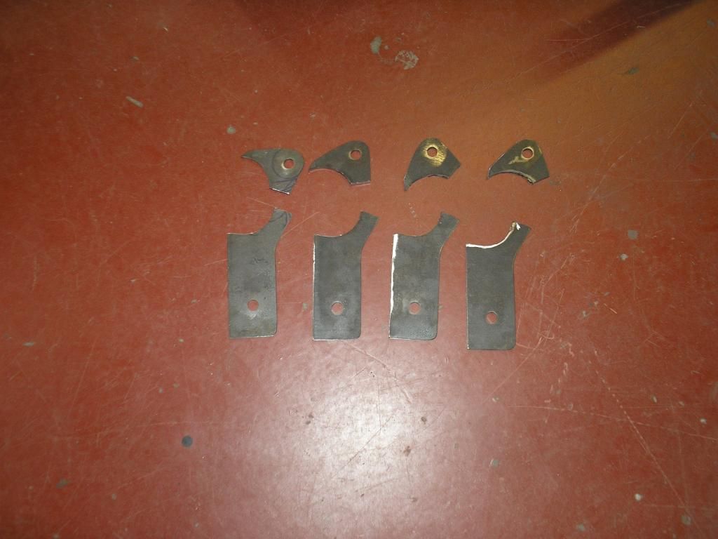

    The brackets for the traction bars.[​IMG]
