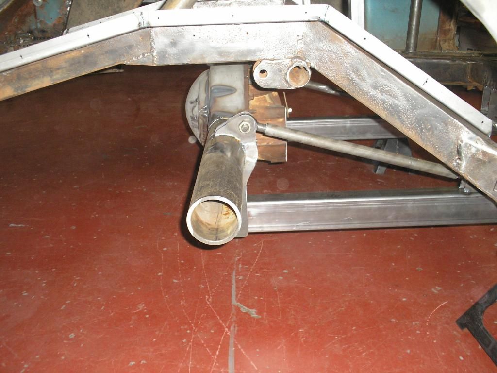

    A rear shot of the back turn buckle brackets welded on to the housing. You can also see that I welded up the housing where The new axle tubes went in so the housing would look old school.[​IMG]

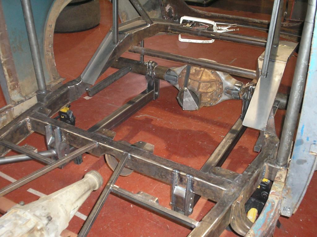

    The traction bars installed all I have left to do on them is the turn buckle and the brace for the front bracket on the driver side.You can see that the tubing is still tacked in to hold the housing in place.[​IMG]

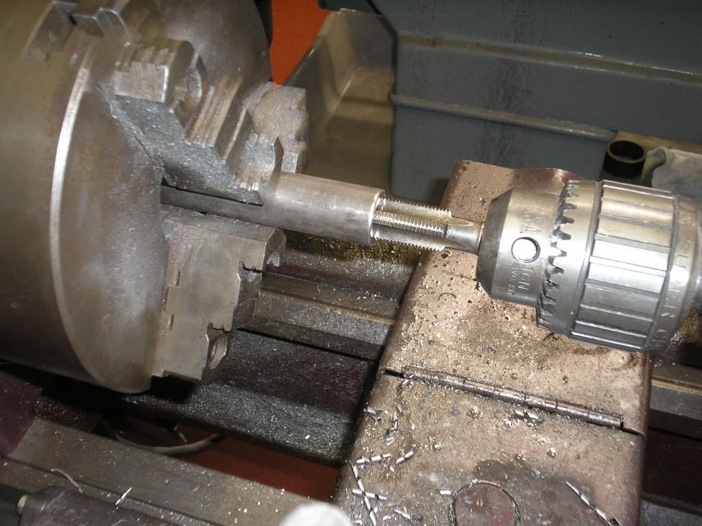

    Threading the tubing for the turn buckle. I used 1' with .156 wall chrome tubing.[​IMG]
