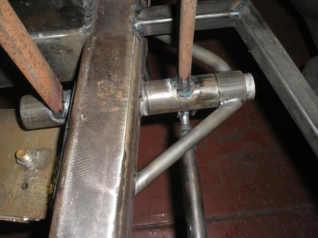

    Now that I know where the steering shaft is going to be I can finish the petals. This is a brace I had to make for the clutch shaft to go through.[​IMG]
  3. Quain Stott
    Joined: Nov 21, 2006
    Posts: 2,068
    Quain Stott
    The braced welded in place[​IMG]
