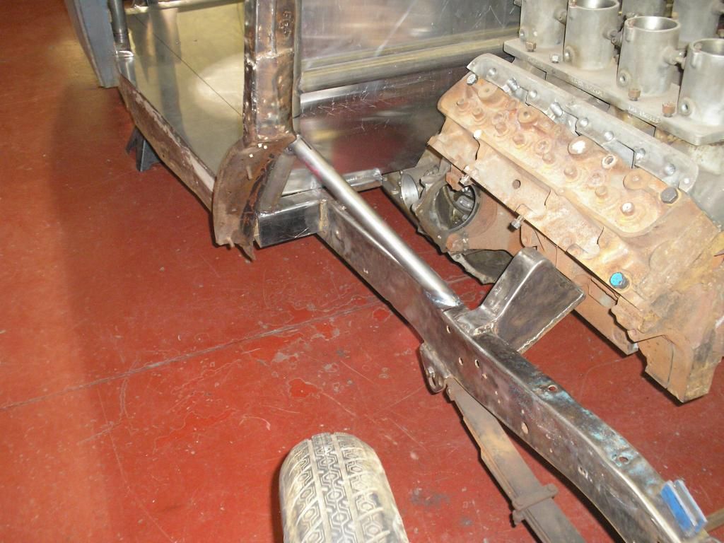

    I added these bars down to the motor mount The NHRA rule book don't require these but they do a lot to tie the ch***is together. I didn't won't to use the new style bar that goes over the top of the headers and then down I think they take a lot away from the look under the hood of a 60s G***er. Plus they don't work as good as this way if there is no x bar in the door area.[​IMG]

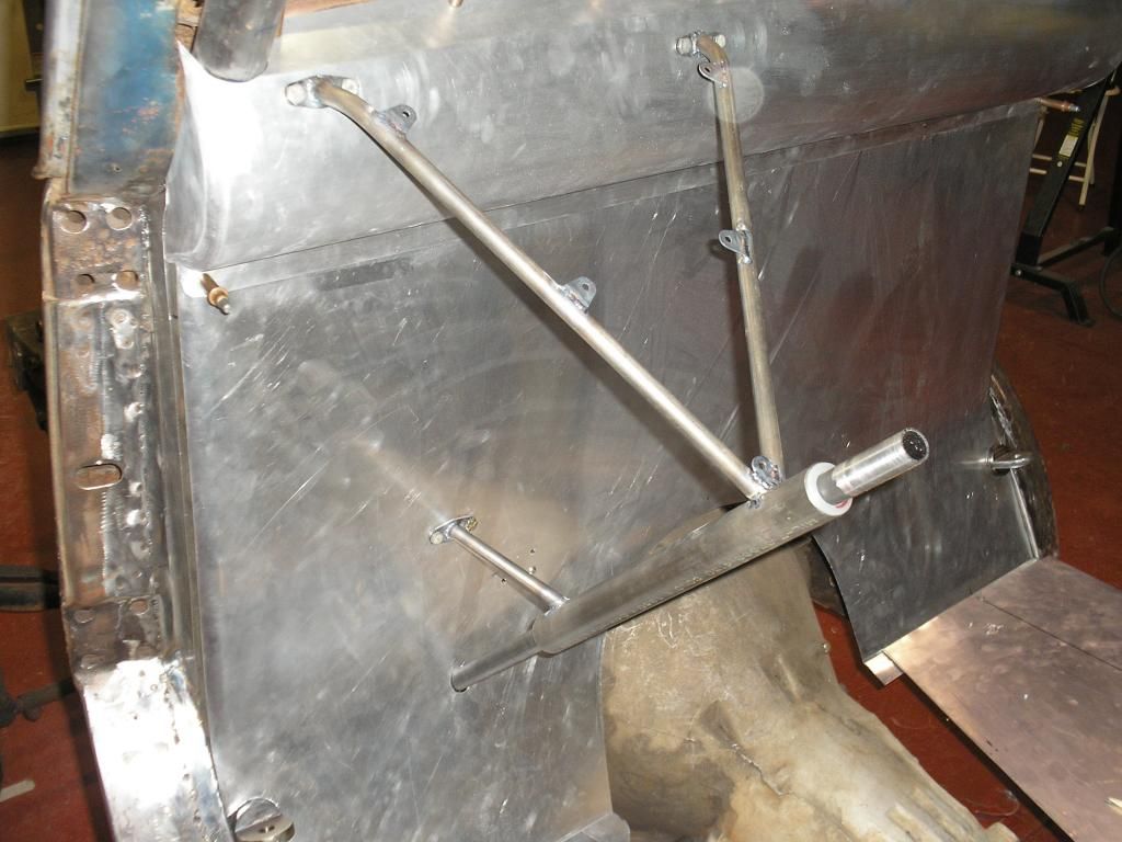

    The tabs for the steering column the ones with nuts tacked on will be a blind hole that you can't get to when the dash and fire wall is installed. I hate making little brackets and then trying to drill the holes where they need to be. You might notice they have a small curve because they have to fit the dash.[​IMG]

    The bracket for the bottom of the steering column [​IMG]

    Welded on the front side of the fire wall[​IMG]

    The lower steering column brace the fire wall is sandwiched between the two brackets. Note I have also welded on the tabs for the gauge mount in the top v support for the column.[​IMG]

    Is there a bushing in that support tube for the steering shaft?
    I've always been a fan of that style steering on old drag cars, and want to use that style on my current project.
  28. Quain Stott
    Joined: Nov 21, 2006
    Posts: 2,068
    Quain Stott
    Yea I'm going to make an aluminum bushing for it later I didn't have any aluminum stock the right size at the time so I made some temporary ones out of nylon to mount it. Don't use nylon for the real ones if it's going to be a street car where it will be used a lot because when dust and dirt gets in there it will embed in the nylon and act like sand paper and wear the steering shaft.
