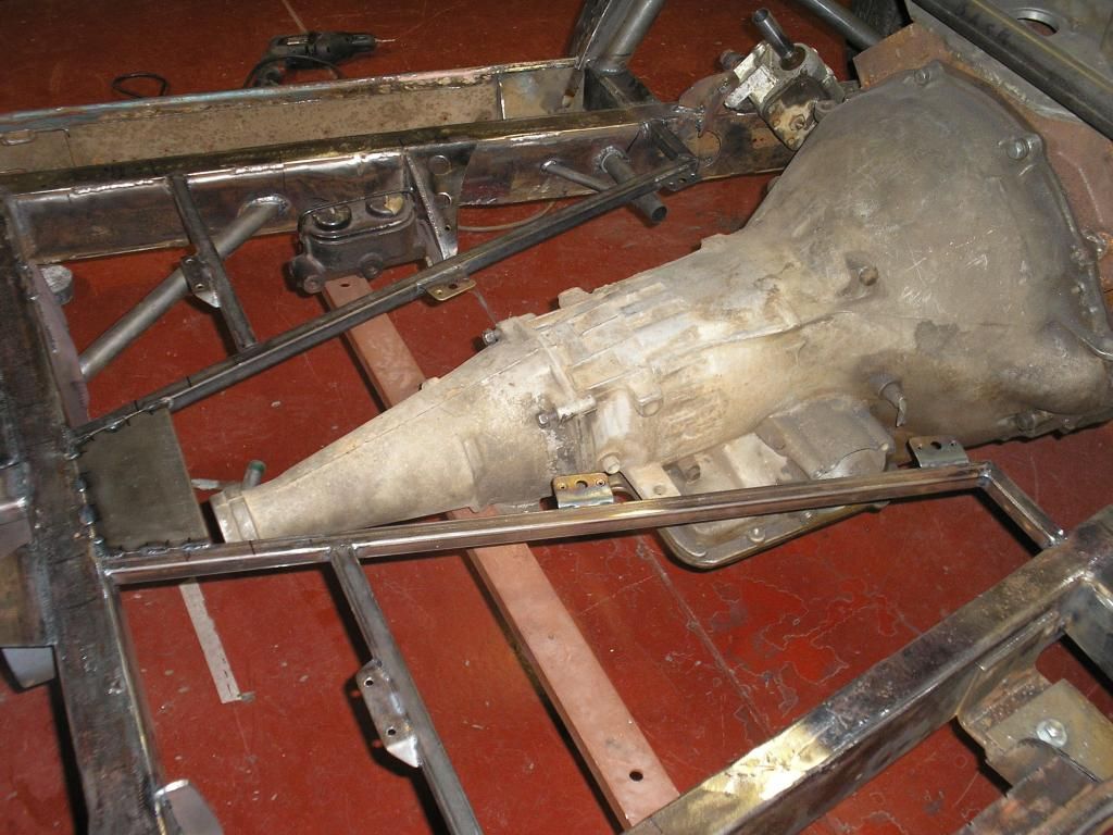

    I'm getting a little work but very little worth posting but here's a few things. This is the seat belt mounts you can see I had to add a bar to mount the inside one to I don't know what it was mounted to before I'll let ya'll guess I don't think safety was a factor back then. [​IMG]

    Belt mounts with the floor pan in place. [​IMG]

    The off set in the fire wall for the trans cover it's hard to see in the pic.[​IMG]

    Chris I promised a close up of the little end of the trans tunnel a few weeks back so here it is. It was to small to get in the English wheel after I got the shape I wanted so it was hammer and dolly time.[​IMG]

    Tunnel in the car the dzus fasteners will be where the clecos are now.[​IMG]

    Dzus tabs welded on. At the rear of the trans tunnel I welded in a piece of sheet metal for safety if the drive shaft ever comes out, it will also act as tabs for the rear dzus fasteners.[​IMG]

    Thanks hot rod but I think the pics are hiding a lot when you see it in person don't look close. I'm now getting down to the little stuff where you work all day then look back and it don't look like there was anything done. Like a carpenter doing trim work.

    Thanks for the picture Quain, VERY Cool trans tunnel!! Ill have to try that end on the next tunnel I do, What Aluminum do you use? I use 3003 -H14 . Be sure and call me if you need anything else! THANKS Chris
