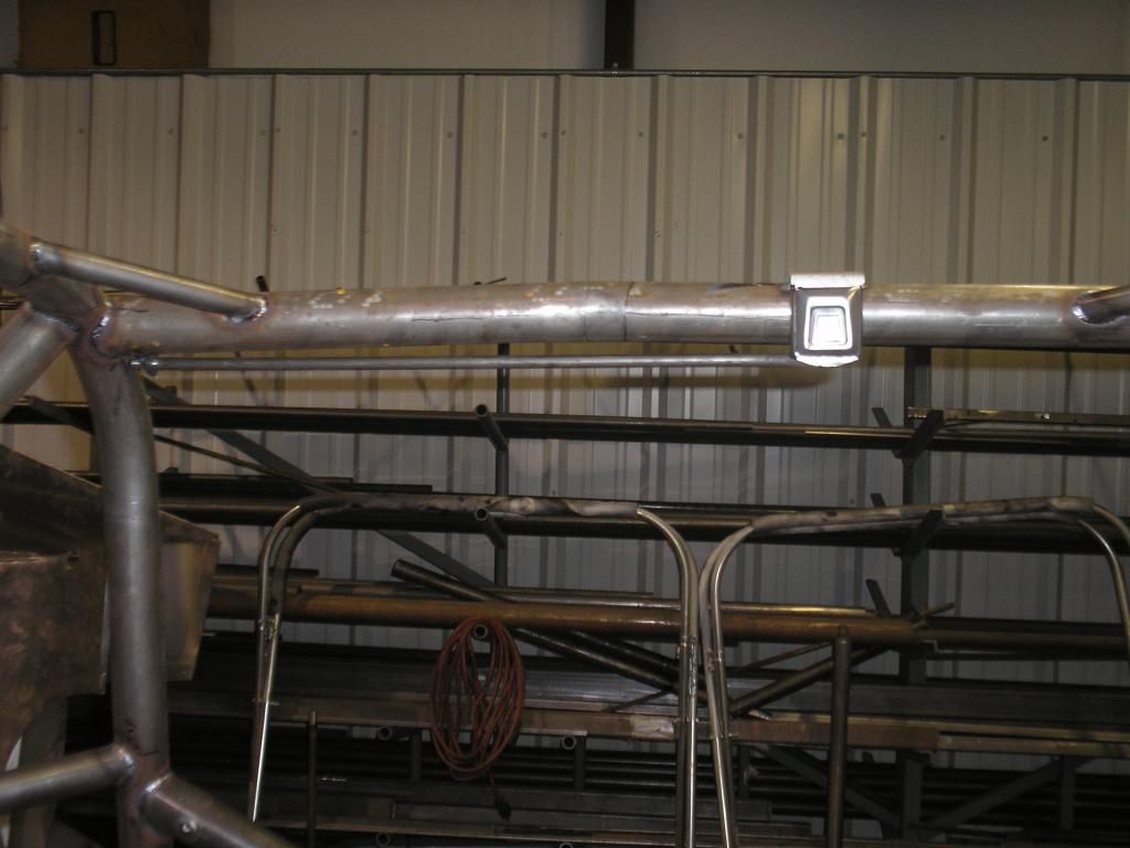

  2. Quain Stott
    Joined: Nov 21, 2006
    Posts: 2,068
    Quain Stott
    This is what I came up with for the top back seat mount. My welding is off worse than usual I have a bad thumb on my right hand today I was grinding to close to a corner this morning (something I know better than to do) and the little 4" grinder hung and kicked back and about took the end of my finger off. [​IMG]
