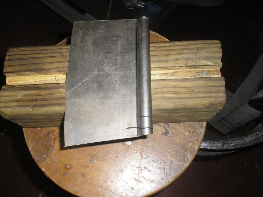

    Like I said a few days ago I'm down to the little trim stuff but I'm taking a few pics anyway. This is a block of wood that I had to cut to form a 1/2 bead in a piece of sheet metal to fix a bad place where the floor will meet the top of the rocker it had been hacked out at some point.[​IMG]

    1/2 tubing pressed in the grove with the sheet metal under it to form the bead.[​IMG]

    The finished piece I will fit it to the car tomorrow stay tuned.[​IMG]
