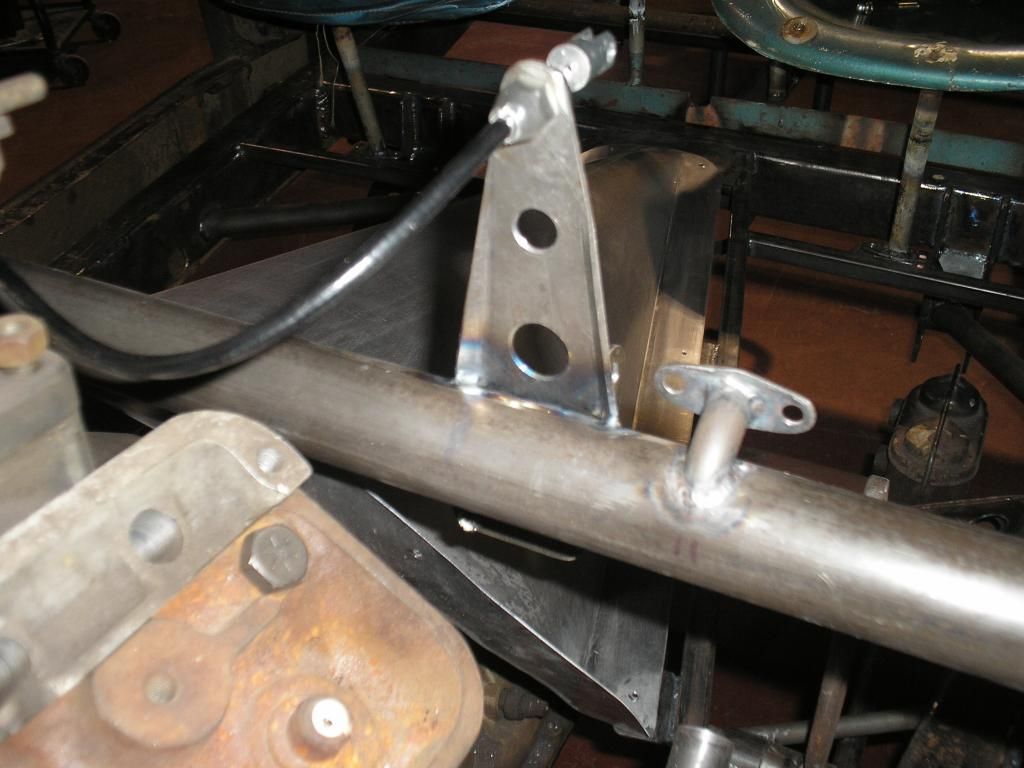

    The bracket for the throttle cable. I don't like to just drill a hole in the aluminum fire wall for a mount it will move around to much this bracket will stop that. We will have to do something with the late model looking nuts that came with the cable.[​IMG]

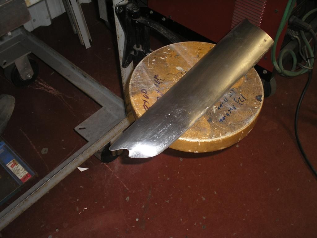

    I started by just rolling a piece of sheet metal[​IMG]

  23. Quain Stott
