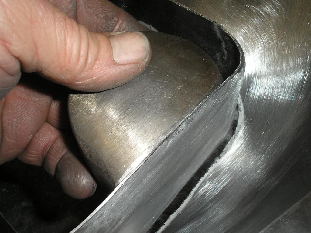

    I've been getting a few emails asking how I made the end caps on the dash so I thought I would show some details on the top for the shifter cover it's going to be made the same way.I have a lot of different dolly's that I have made over the years to do different things this one is round on one corner and has an angle on another for rolling a lip.[​IMG]

    Here's the dolly in being used to roll the lip in the rounded corner. I'm to be the photographer and metal man at the same time.[​IMG]

    The same dolly using the bevel to roll the straight side.[​IMG]

    The finished lip all the way around.[​IMG]

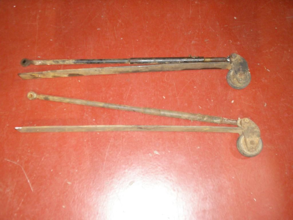

    These wheelie bars were put on the moonlighter around 67 or 68 I think. Gene can tell us for sure. They are made from an old leaf spring.[​IMG]

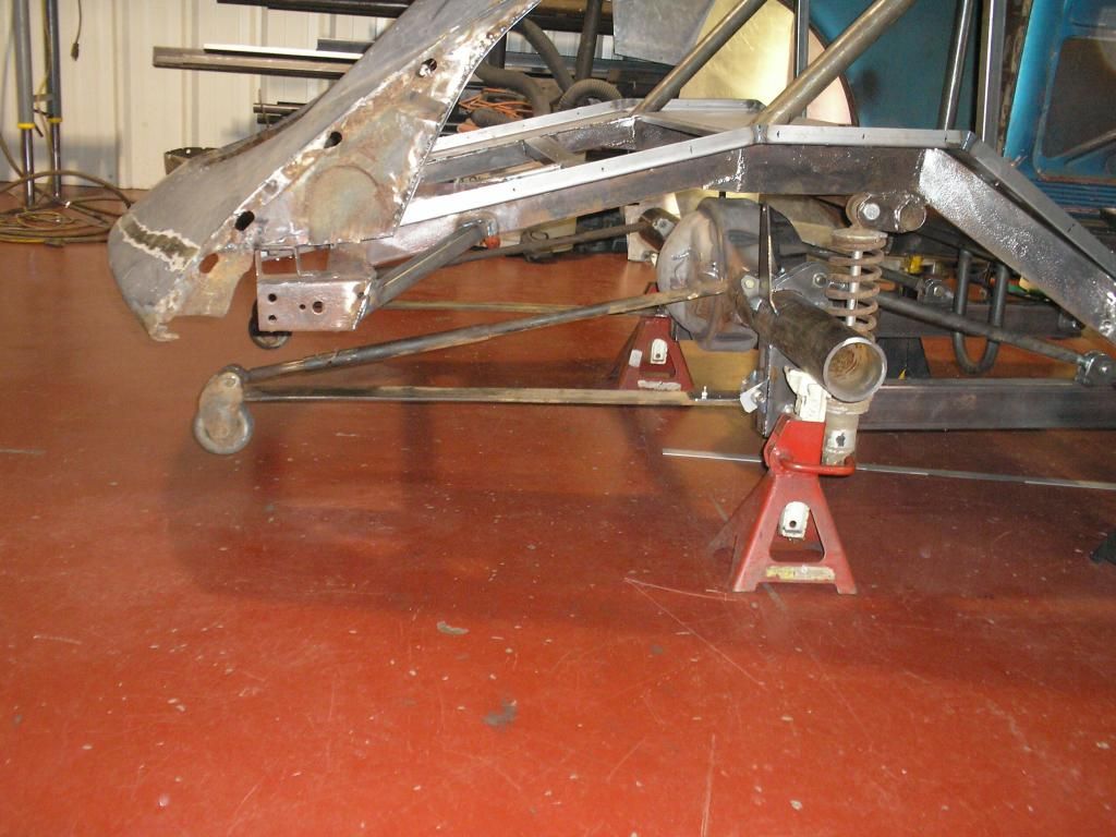

    This is what I came up with to mount them. If we have time we are going to build a set of bumper mount wheelie bars also that way we can set it up like it was in the early 60s for shows.[​IMG]

    It's been over 40 years since these wheelie bars have been hanging under the Moonlighter. Now they are back home.[​IMG]
