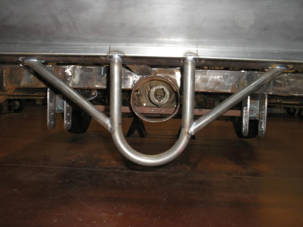

    I haven't posted any pics in a few days because I'm down to the little stuff getting it ready to go to the paint shop. Here a few to let ya'll know whats been going on. This is some side to side braces for the drive shaft loop.[​IMG]

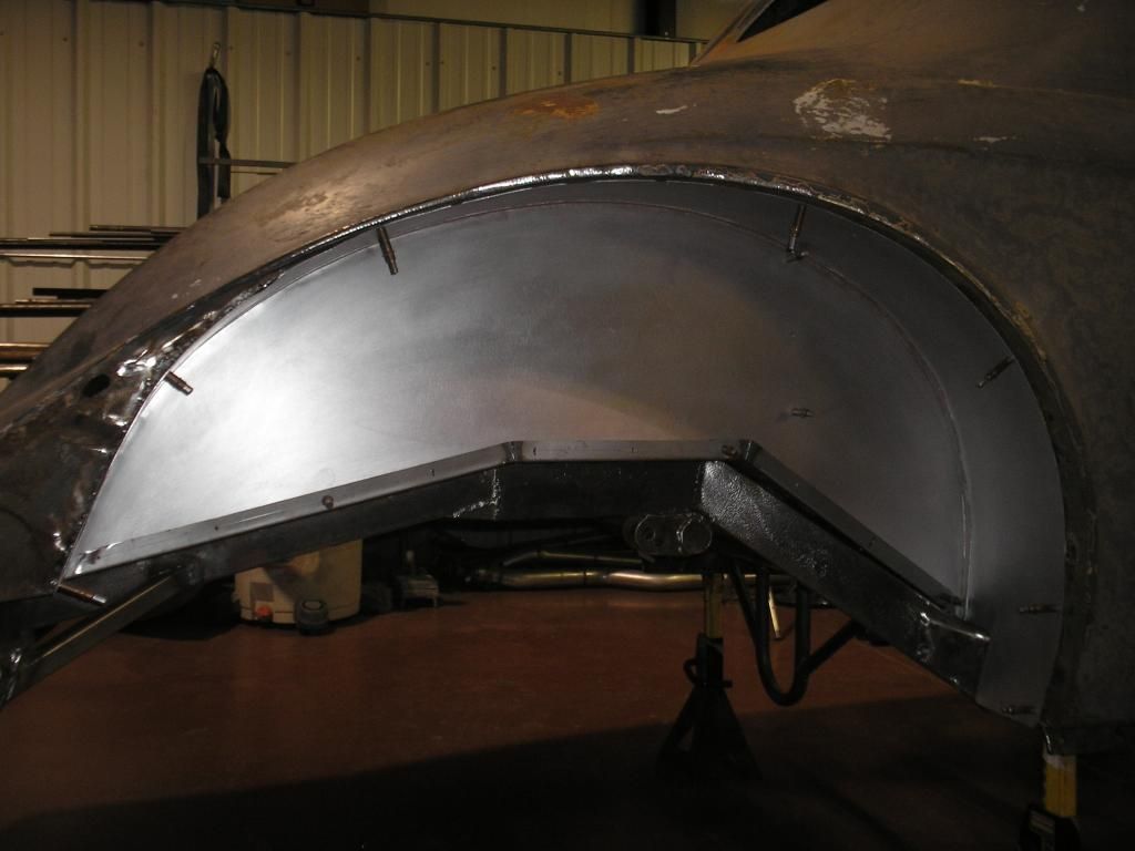

    Another angle you can see that the wheel well is back in the same hole that was cut out back in the day. They are not perfectly round but I wanted them to fit the hole just like they were.[​IMG]

    The wheel well from the out side again you can see that they are back in the original hole.[​IMG]
