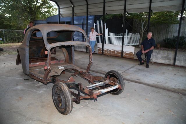

    Cromer is at my shop with the moonlighter today, work should start monday
  19. Quain Stott
    Joined: Nov 21, 2006
    Posts: 2,068
    Quain Stott
    Gene got the Moonlighter to me Monday not much work has got done untill today. I made a road trip with Cromer to pick up some parts that Bogan Renfroe of the Cat Skinner willys g***er from the 60s donated to gene.[​IMG]

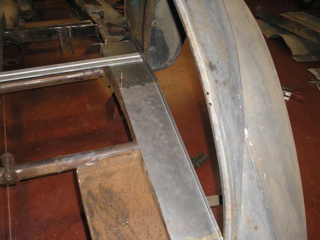

    Here is a sheet metal filler for the wheel tub to rivet to. All this stuff was lost over the years so we are going off of Gene's memory and what few pix's we can find.[​IMG]
  23. Quain Stott
    Posts: 2,068
    Quain Stott
    Another angle of the new filler and a good shot of the original ch***is and shock mounts.[​IMG]

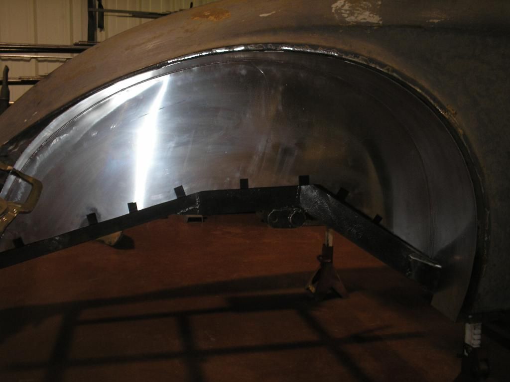

    Right side wheel well ruffed in. The originals are long gone I used the old rivet holes and the cut out as clues as to the way they were shaped when made in the 60s. [​IMG]

    From the tire side[​IMG]
