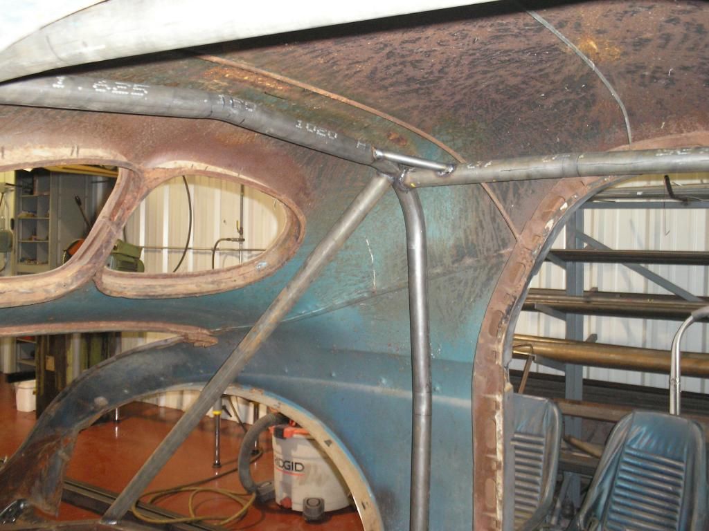

    I know some of ya'll on here is not going to like this part of the rebuild. We are getting away from the original a little bit with these bars going to the front. Gene is planning to run this car just like he did in the 60's he's 80 years old and not as young as he once was so I wanted him to be as safe as possible plus the tracks won't let him run with out them. As you can see they are very tight to the body and will not be noticed unless you look close.[​IMG]
  29. Quain Stott

    This shot shows the safety bar behind the engine[​IMG]
  30. Quain Stott
    Joined: Nov 21, 2006
    Posts: 2,068
    Quain Stott
    Where they tie into the main hoop and the bars going back, the main hoop and the bars going back are in the original location.[​IMG]
