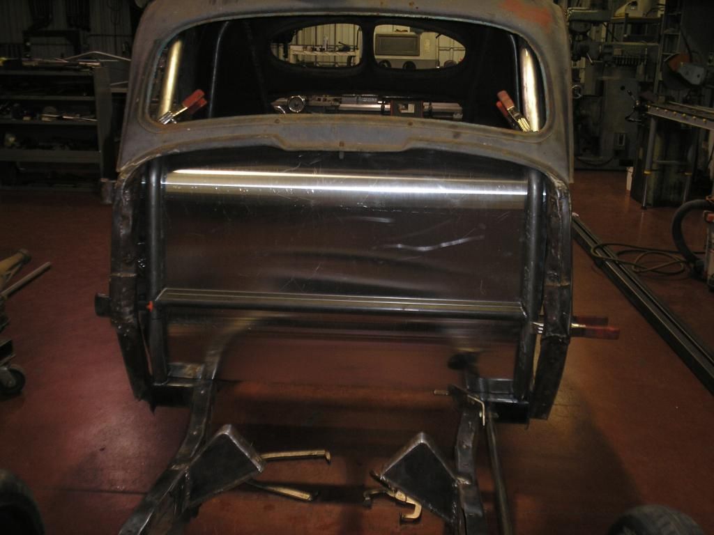

    Rear view of the bars going back to the original ch***is.[​IMG]

    I got started on the fire wall tonight but it's a long way from finished. I planned the roll bars to go in front of the fire wall to hide them from view, the fire wall is as close to it's original location as I could tell from clues that I found and Gene's memory.[​IMG]

    Front view of the fire wall. I plan on filler panels on the side to blend the bars to the door post to hide them from the front. The engine will hide the safety bar. Again I'm sorry but we had to add these bars.[​IMG]
  4. Quain, you and Gene will get no grief from me! I'd much rather see that ole girl dance again, than be and asphalt anchor.
