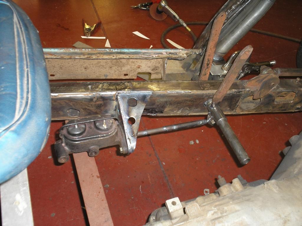

    We are having to change the petal set up the master cylinder and petals were made together and rusted beyond repair plus I think it needs a dual master cylinder for Genes safety and this way I can get him a little more leg room (he's not as flexible as he used to be) We are using a master cylinder from a 67 mustang so we are staying in the era and I'm also using the petal arms from the original that's all you will see when the floor pains are in place. [​IMG]
    kidcampbell71 likes this.

    Master cylinder mount[​IMG]

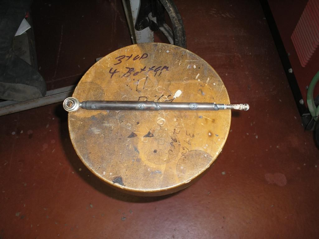

    Quain Stott
    Master cylinder push rod[​IMG]

    All put together now you can see that the only thing that will be seen when the floor pans are in is the original arms[​IMG]

    Another angle[​IMG]
