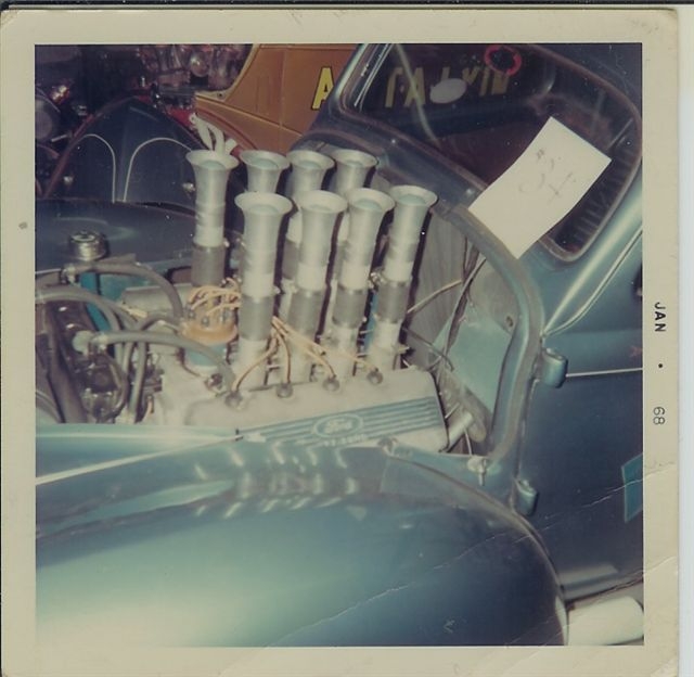

    You want to see it with a cammer, here it is. I've been wanting to try out posting a picture since the site remodel. Moonlighterwithcammer_zps1c1ca86e.jpg

    Do you know where that picture was taken Frank? Almost looks like a car show.

    I believe Gene said it was a car show in Greenville, SC.
