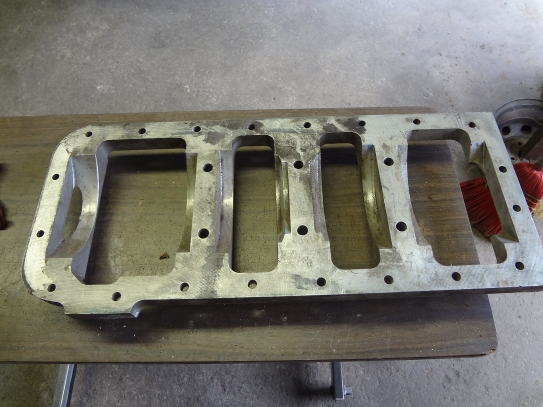

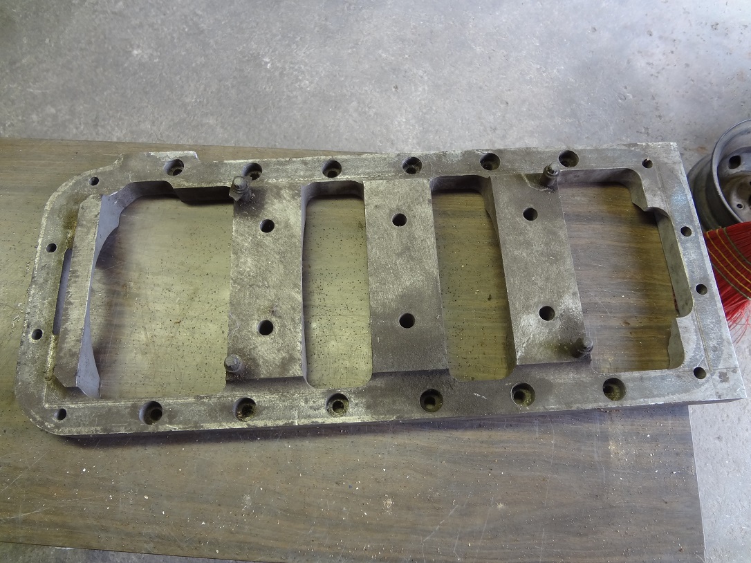

    Think this would help?
  5. Yep, girdles are always better than nothing. My dad had problems keeping the main webs in 265/283 & early 327 blocks. The 3.000 stroke 265/283 cranks didn't have alot of counter weight in them, so when you drop the hammer on one with 60-90 lbs of flywheel, pressure plate, & disc @ 6000+ rpm, the crank would try to "whip" itself out of the mains. Dad first strapped the main caps which helped a little, but the girdle was a big improvement, and adding counter weight to the crank helped even more.

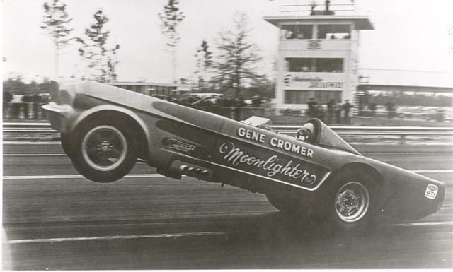

    Since you mentioned the Mustang, Moonlighter Too. Gene shocked me the other day, while talking about the spool in the Willys. He said that he always ran a open rear in the Mustang. He evidently got it to hook. 149043_1503892242546_7783517_n.jpg
    hendelec and racinman like this.
  10. Some of the Fuel Altereds ran open rears back in the day too, it kept from climbing guard rails.
