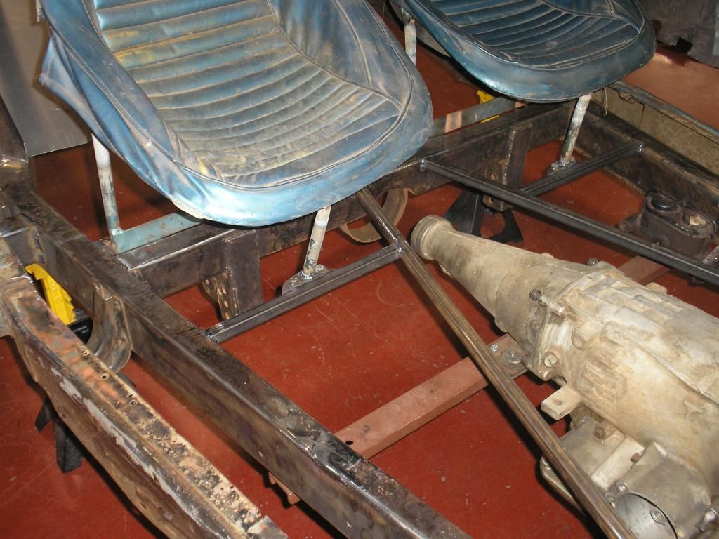

  10. Quain Stott
    Joined: Nov 21, 2006
    Posts: 2,068
    Quain Stott
    The floor support bars and front seat mount bars had at some time been cut out this is what I added back I think it's close to the way it was.[​IMG]

  11. Quain Stott
    Posts: 2,068
    Quain Stott
    Another angle of the floor support bars, you might spot the ford high rise fuel injection intake that we are using to build our throttle linkage. [​IMG]

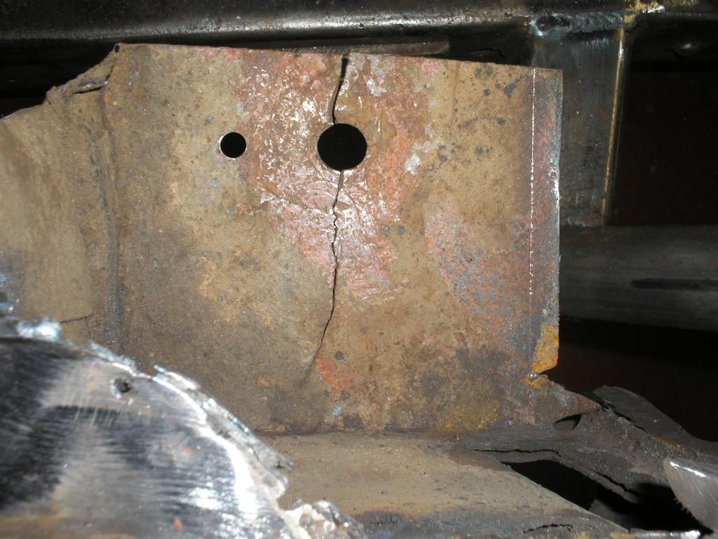

  19. Quain Stott
    Posts: 2,068
    Quain Stott
    A little body mount repair, I'm trying to save every thing that I can that was original. It would have been easier to made a new one.[​IMG]
    Posts: 2,068
    Quain Stott
    After the repair.[​IMG]

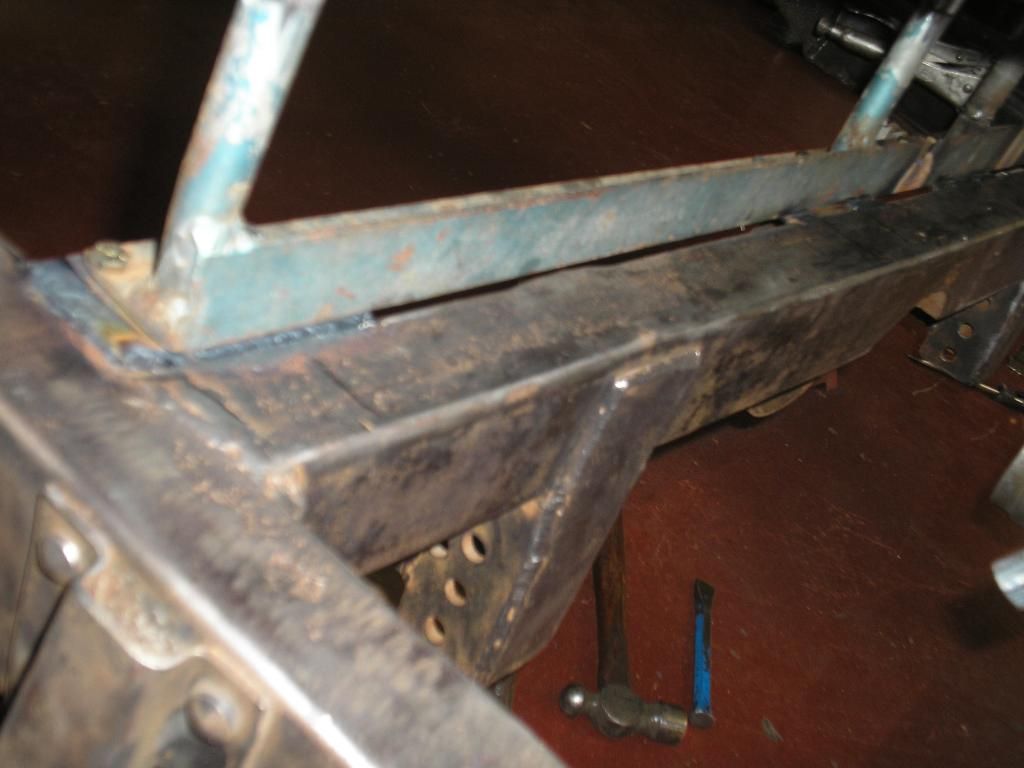

  21. Quain Stott
    Posts: 2,068
    Quain Stott
    Brackets for the front of the seat mounts.[​IMG]
  22. Quain Stott
    Posts: 2,068
    Quain Stott
    Brackets welded in, the alumn. floor pan will be between the two brackets.[​IMG]
