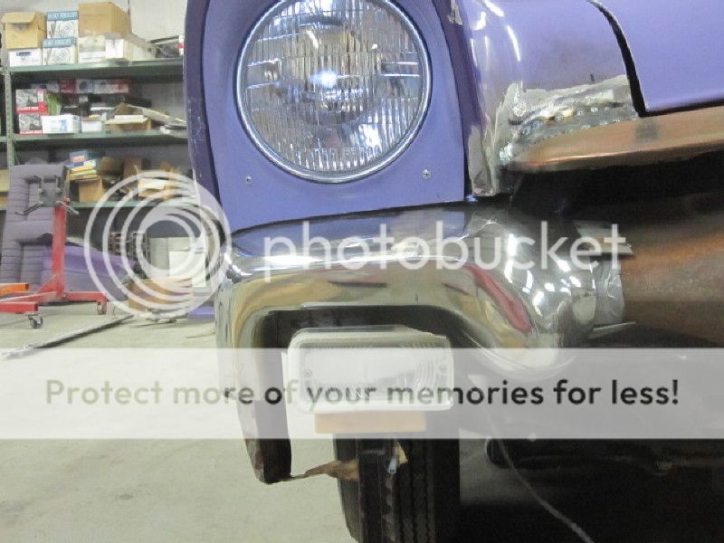

    Okay, after a couple days of R&R it's time to forge ahead. First, to answer a couple questions....The area beneath the narrowed Plymouth grille bars will be occupied by Plymouth parklights, that match the opening well. They will be mounted from behind, so that they "float" in the space.
    The "1950 Chevy" sign is actually a framed information sign that Leland used with the Kruizer in it's only show. This was about 20 years ago, as you can see by the color of the paper.
    I hope the correct pics uploaded, as I'm not Mr. Wizard on this thing. You can see how the lights will fit into the space.
    On New Years day I went to the visit with Leland and his wife, and managed to snag a computer at the facility. With Leland looking over my shoulder, I went through every post, and we talked about every one, who they came from, where they came from, and what every avatar meant. That got a little delicate at times, but we managed through. It took about 4 hours, and was a great afternoon. We laughed, cried, and shared wonderful stories. I asked about doing a video interview, and Leland is fine with that. This weekend, I will make that happen.
    Nick and I are getting together tonight to piece everything together for fit. Then the fun starts, welding it all together. Again, both Leland and Gene are totally in tune with the finish product.
    We are mulling over the headlight bezel situation (chrome or no-chrome), and really appreciate the comment. More, more........Same with the wheel well......
    How 'bout some ideas on color???????

    Thanks for updates. I would say not to chrome the headlight bezel/surround since it is so large. with a new color (?) it will help the grill to stand out like it should.
