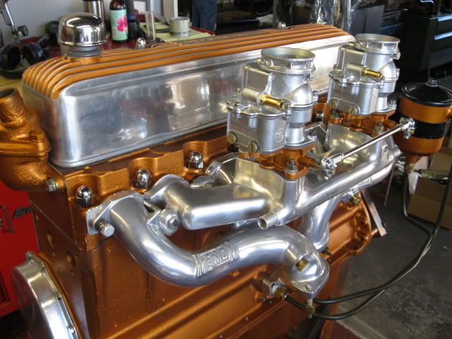

  14. 'Mo
    Joined: Sep 26, 2007
    Posts: 7,419
    'Mo
    Ouch!
    (But then again, the R&C Dream Truck got its V8 transplant in late 1954.;))
    You might find some inspiration from the 216 group linked in my signature.
    Here's one for starters. (Build thread HERE: http://www.jalopyjournal.com/forum/group.php?do=discuss&group=&discussionid=19145
