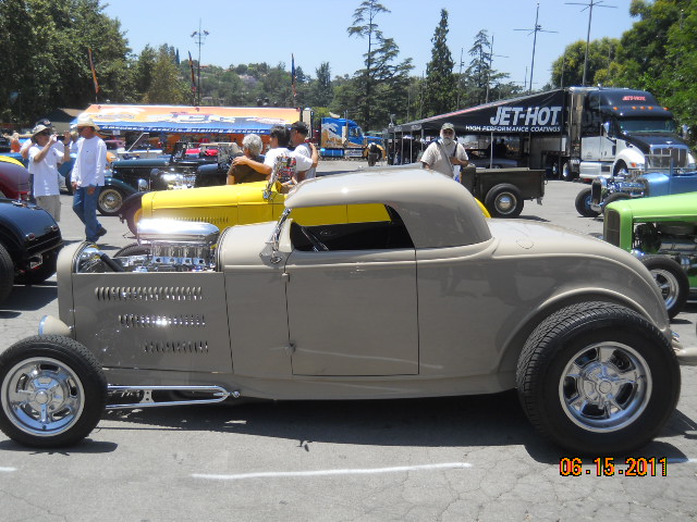

    Buicks are a different breed, lots of good info on here about the little things that are extremely important to a sucessful build. We put a 425 in my friends roadster, and spent quite a bit of time figuring out cams, rockers, hidden oil galley plugs, etc. It's all here somewhere. And we got a lot of compliments at the LARS for the nailhead.
  11. Stock 425 single 4 bbl = 340 hp , 465 ft lbs torque , throw on the dual 4 set up for another 20 hp. Now other than gas mileage, whats not to like about that?

    General Nailhead - a good name for the car.
