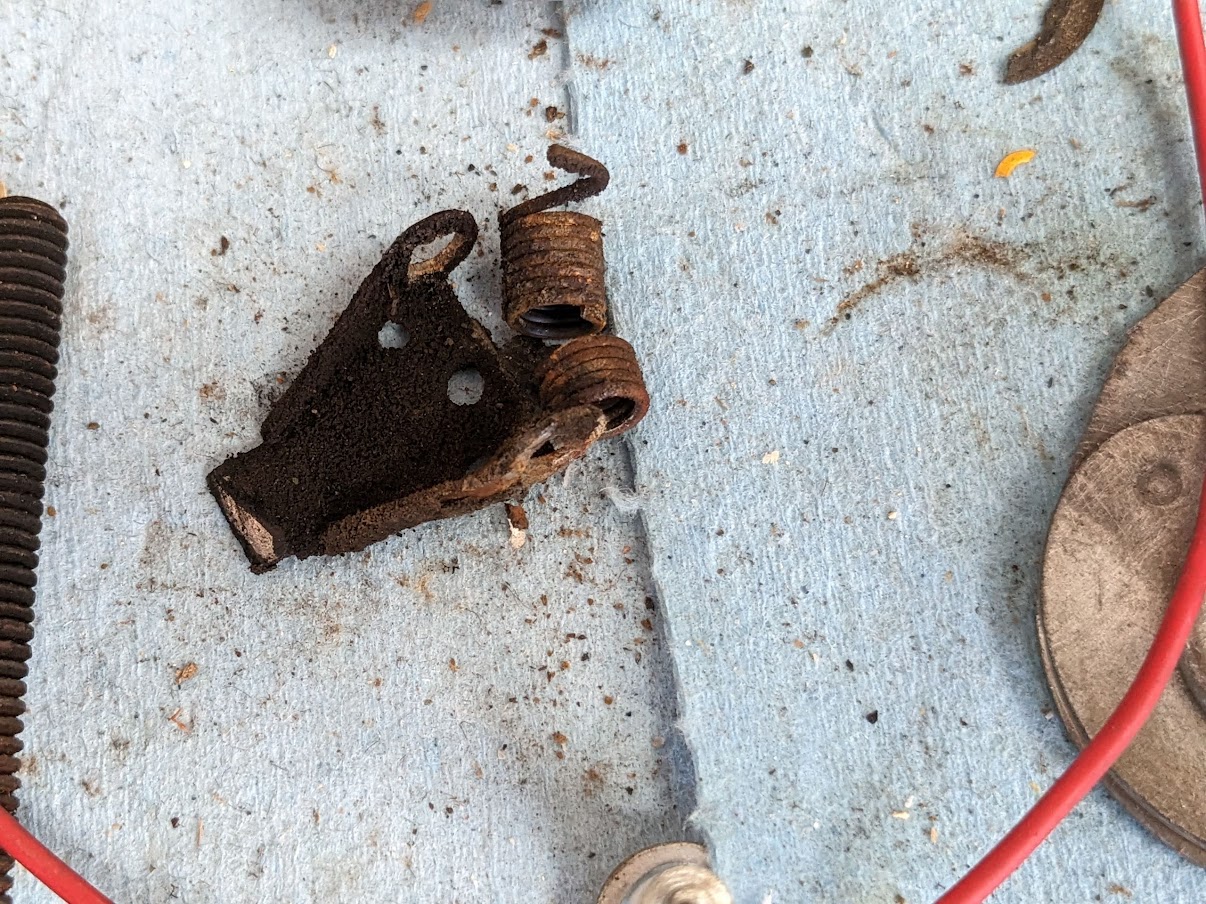

    I'm trying to sell my Rambler, the price has dropped pretty far, and no takers yet...but someone is coming to look tomorrow. I drove it last weekend, worked fine. Fired it up Monday to go on some errands, and the Gen light stayed on after it started...so I took another car instead.
    Today it finally warmed up enough to look at it. I got out the volt meter and measured voltage at the F and A wires on the voltage regulator while it was running, both zero. I did some reading, to remind myself how they work, and decided the generator just isn't making any juice. Which is kind of strange to happen after just sitting a few days. So, I took out the generator, and looked inside. Seems one of the brush springs broke. That's a new one on me!
    They sell them on ebay, for twenty bucks...I don't have any old generators laying around any more, since the big move last year. I guess I'll have to make a spring.

    Regular extension spring, bit of heat and some pliers.

    I looked in my box of springs, and found one extension spring that's the right OD, almost the right wire gauge, but the wrong "handed", it's left hand wound instead of right hand wound. So I had to change the ends a little to make it work. But it's in, and it charges again, and it didn't cost nuthin to fix it.

    Probably 75% of "no charge" problems with old generators can be fixed with a few taps with a ballpein in the area of the brushes. Probably the biggest cause of failure is failing to polarize a new installation. There are also a lot of small-diameter tractor & equipment alternators that can be made to fit inside a generator case

    Sometimes the contacts in the voltage regulator get dirty...especially the cut out relay. That's an easy fix, if you figure out the cause before you screw up other things :)
