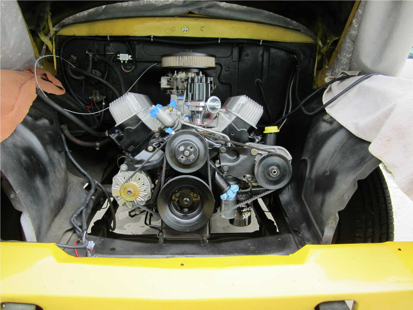

  16. You can either use the regular alt brackets from a later 60's car/truck with a Ford external reg alt:
    Or you can use the early T Bird brackets (65/66?) and mount a GM 10si lower like I did on my '54 panel.

  20. 1oldtimer, thanks for the pictures and part #'s..... good stuff.
