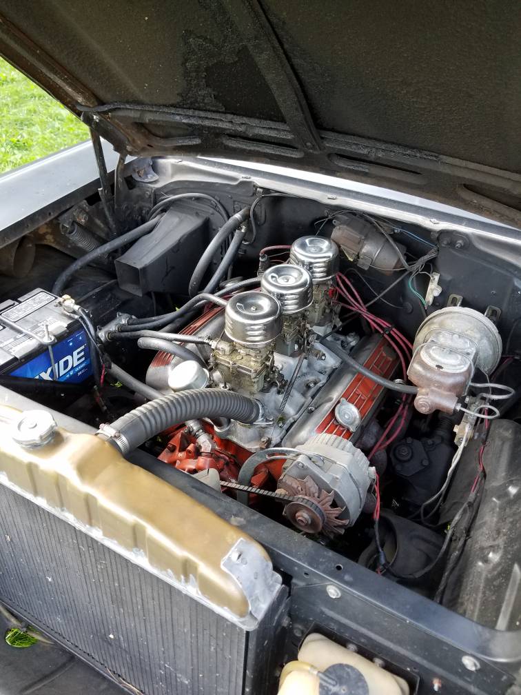

    After you've had a generator "toss it's solder", and short everything out a couple of times, you'll be swapping to an alternator anyway. We really wanted the old time look of a generator on the 51 Chevrolet Bus Coupe, and that's how it started out, but the generator just did't have the dependability of an alternator, so we lost the generator and installed an alternator. We could have bought one of those alternators made to look like an generator, but they are spendy! If you keep the RPM's down, and can deal with the wavering lights at night, a generator will do the job just fine. But if you're at all like me................................I am Butch/56sedandelivery.
