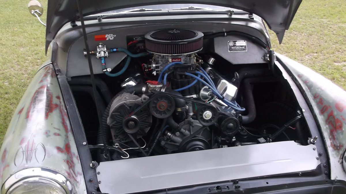

    I would not use a one wire alternator. I would use a 80's style alternator and regulator. You can go to a salvage yard and get everything you need. When I built my Pro street Morris minor I used an 86 Lincoln for a donor it gave me a 140 amp alternator and all of the mounting brackets. Paid 200 bucks for the whole car. Notice my regulator mounting on the tensioner bracket.
    got the motor, trans, driveshaft, all the wiring plus the mounting brackets for my small block Windsor. DSCF0956.JPG DSCF0955.JPG
