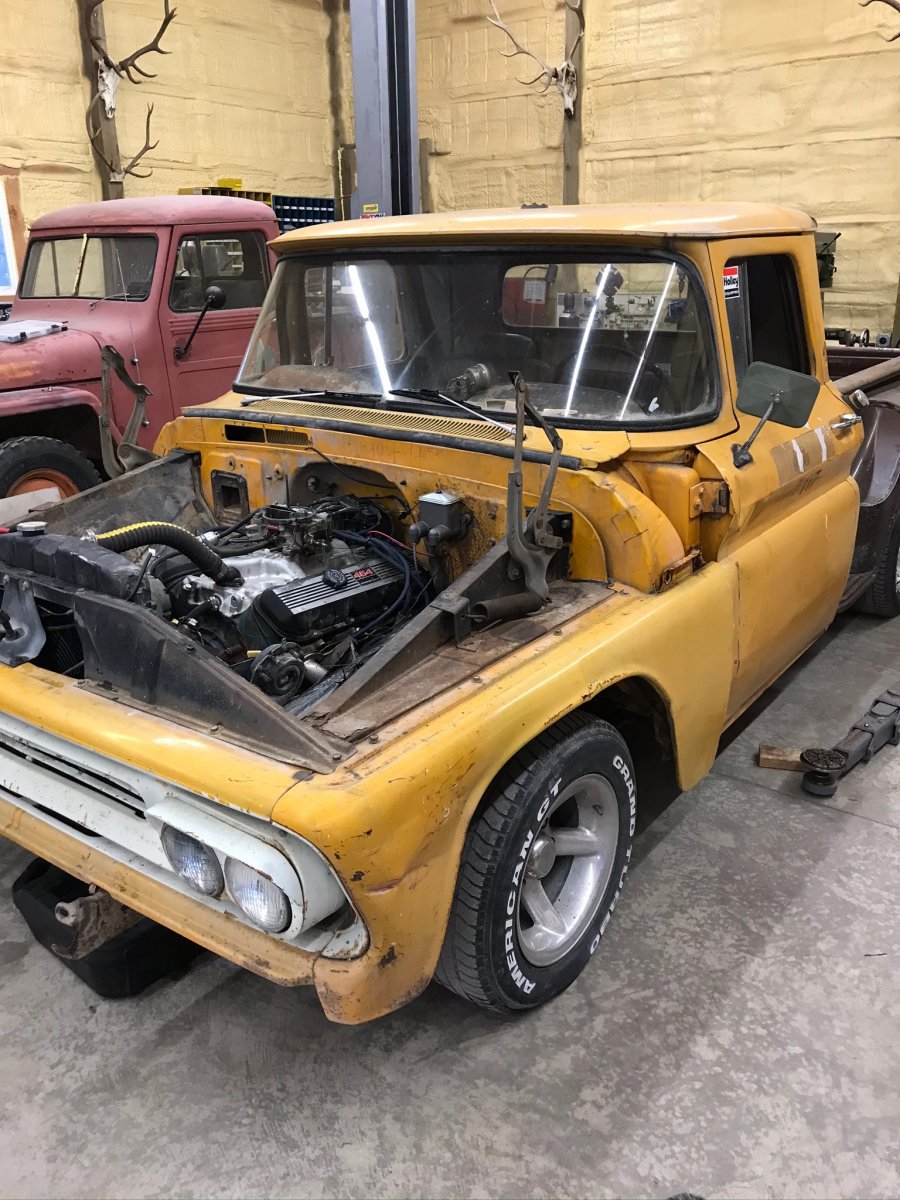

    2FC9E929-A876-4D92-97CD-222C3912C854.jpeg 2FC9E929-A876-4D92-97CD-222C3912C854.jpeg How do I wire the alternator, can I still use the og voltage regulator.
    The regulator only has 3 wires coming out of it and the only other vehicle I have had a
    4 wire regulator to look at.

    Can you take a picture of the back of the alternator that you want to use?
    If it is a 10SI, or 12SI, it as an internal regulator, so no other regulator is required.

    This is the conversion diagram from generator to 10SI (small case) or 12SI(large case). Both of those alternators have the same wiring connections.
    Those alternators look like this:
    The 12SI is identical in appearance, just enlarged in diameter a bit.
    An externally regulated GM alternator is an 10DN, and looks like this:
    If you really, really want an 10DN, and a functional regulator, this is the wiring diagram:
    Be aware, 10DN alternators, in virtually all stock configurations are very low-output alternators, by today's standards.

    You can’t use the generator regulator for an alternator...if you want...you can leave it in place and tie the output of the alternator into the original vehicle wiring so things function and look original by using the old regulator as a junction block.

    Well, he could, if he used the right alternator, but there is no reason to do so.

    It has a 454 with HEI in it, he needs at least 55A of alternator....
    I like gimpy's explanation.
    although I have one of those early alternators with the external regulator in a car I drive and race a lot. It doesn't have any power accessories, nor HEI, so it does just fine. And looks like 1966.

    As the others said, if you plan to use an "external regulator" you have to have an external regulator for an alternator. The one for the generator won't work.
    I've got one diagram here that shows leaving the generator regulator in place and wiring up a 10 or 12 SI internal regulator alternator that might help The regulator just serves as a bus bar that way. https://s173.photobucket.com/user/mr48chev/library/ALTERNATOR WIRING DIAGRAMS?sort=4&page=1
