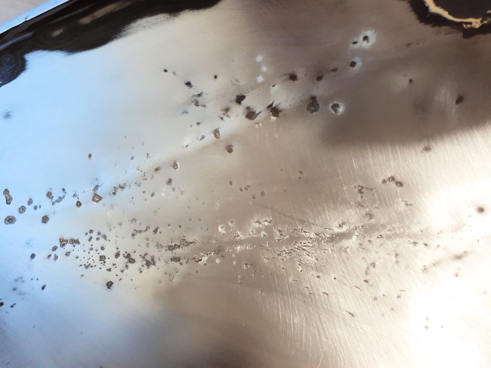

    In general, once I got the paint off, the fender looks pretty good. There are numerous small indentations from 88 years of stones and other debris. I think body filler will take care of them. The one real problem is a crack at one bolt hole where the fender attaches to the frame. A friend has given me a suggestion on how to fix it. I will lay a small piece of 1/8 inch music wire on the inside radius and carefully weld the outside ( one short shot at a time). For the bolt hole crack I will back that up with a 3/8 washer and fix that crack.

    Unfortunately, because of the shape of the fender I can only use the DA sander ob about 1/3 of the inside of the fender. The radius is too tight for the 6 inch wheel to fit. At this point it looks like I will be hand sanding two thirds of the inside of the fenders.
    On the inside of the fenders there are many deep dents. They appear to be from old body work. The outside of the fender is smooth because it was apparently tined after the body work, 20231015_160630.jpg 20231015_161024.jpg
    Many of these dents are quite deep. I am not sure I can completely remove all of the old paint and body filler. Is it Ok to just spray epoxy primer over the ones I can't get completely clean?

  8. If that was mine, I would melt out all the old lead. You can then work out those dents with a hammer and dolly. On our '38, there was rust forming under the factory lead just waiting to cause problems after the new paint was applied.
    Also, it may be worth p***ing over some of those dents and pits with a quick dusting of a sandblaster to clear them out. You might be surprised that some of the deep pits quickly turn into holes...which you will want to address before moving forward.

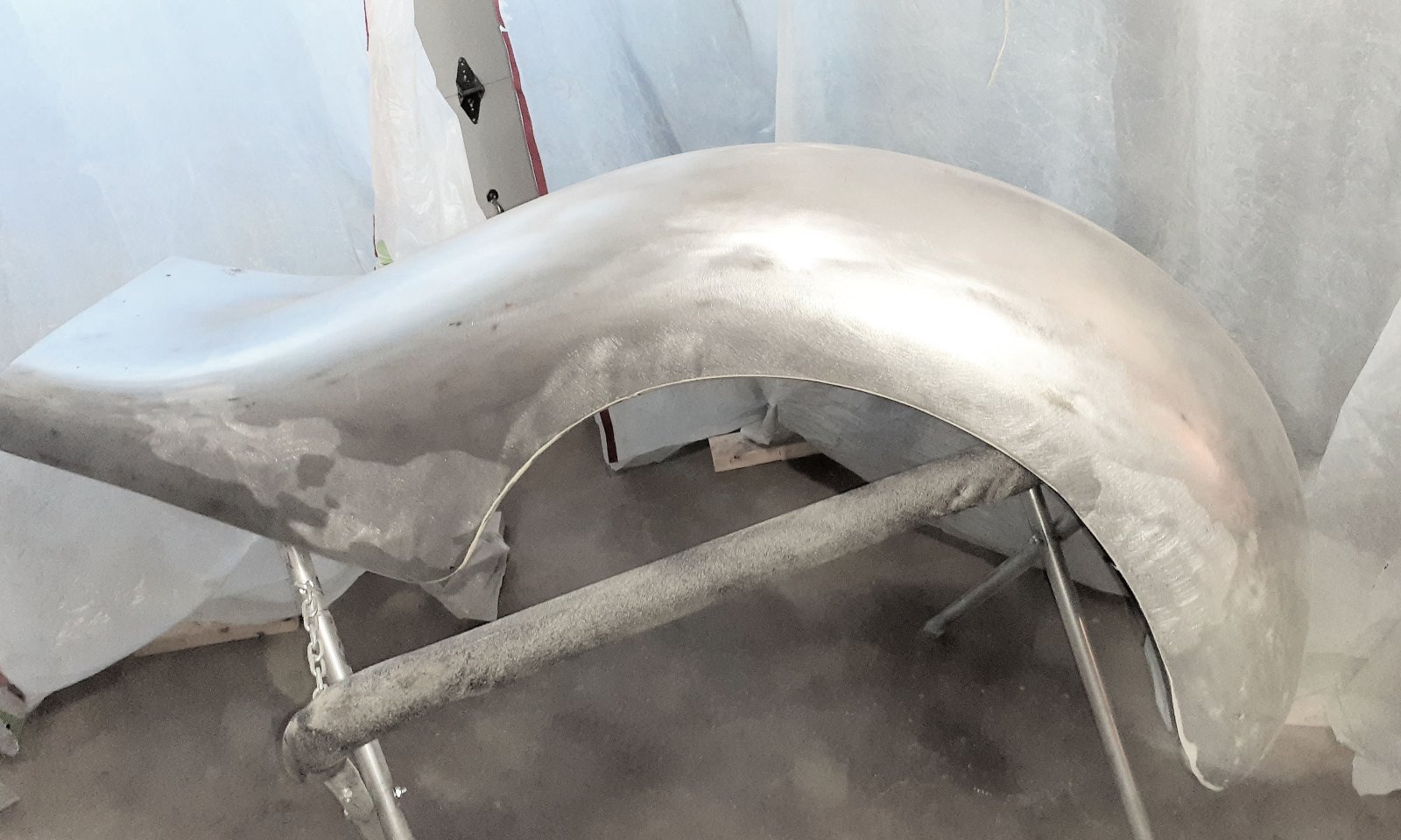

    The sand blaster idea didn't work. My friend either gave away or threw away his old blaster. I tried a cheap one from harbor freight but with 100psi air it very slowly removed some paint. That was if the blaster was pointed up. When it was pointed down all the beads poured out before I could pull the trigger.
    Plan B worked much better. I used a rotary file on a die grinder that quickly cleaned out the larger dents. The dental pick followed by a wire brush on a drill cleaned up the rest.
    I welded up the two holes that had cracked where the fender bolts to the frame. 20231008_170151.jpg
    There are two small holes towards the bottom of the fender where someone had added turn signals. I have decided to weld these closed and get headlights with the turn signals built in.
    Other than welding these holes, I think this fender is ready for primer. However, every morning I find something else I missed. So we'll see.
    Just for the heck of it I took a picture of all the tools I used to remove the paint from this fender. It was one air powered with one bit. Four electric powered with 9 attachments. Nine hand powered, a lot of sand paper and a vacuum cleaner to clean up the mess. 20231108_144104.jpg

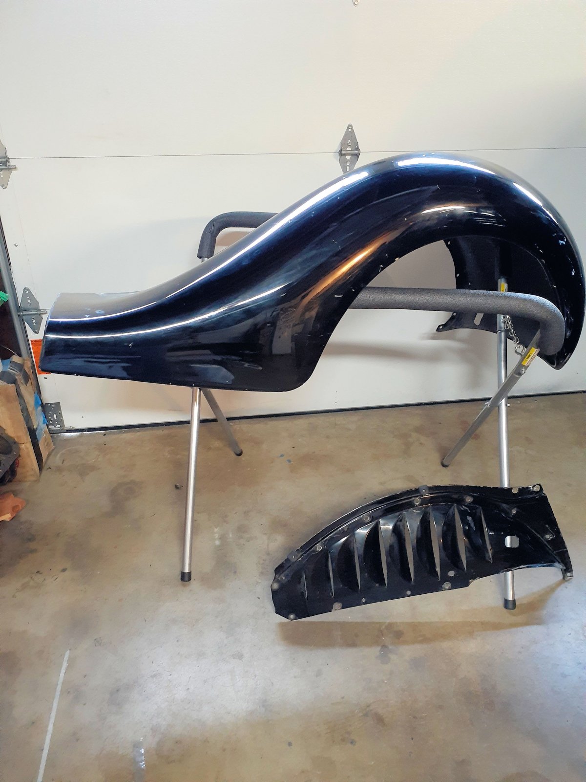

    It’s been a while since I’ve posted anything. So I will try to catch up.
    I have stripped and painted two fenders so far.
    Once stripped, I found the right rear fender has had extensive bondo repair sometime in its past. When I cleaned out all the old body filler, I found several areas at the bottom of the fender with significant holes. Even though there wasn’t any sign of them before removal, I decided to reinforce the area before I painted and added new body filler. On the advice of a friend, I tack welded a 5/16 inch rod to each area with a large gap. The idea is to give a more stable base for the body filler to prevent future cracking.

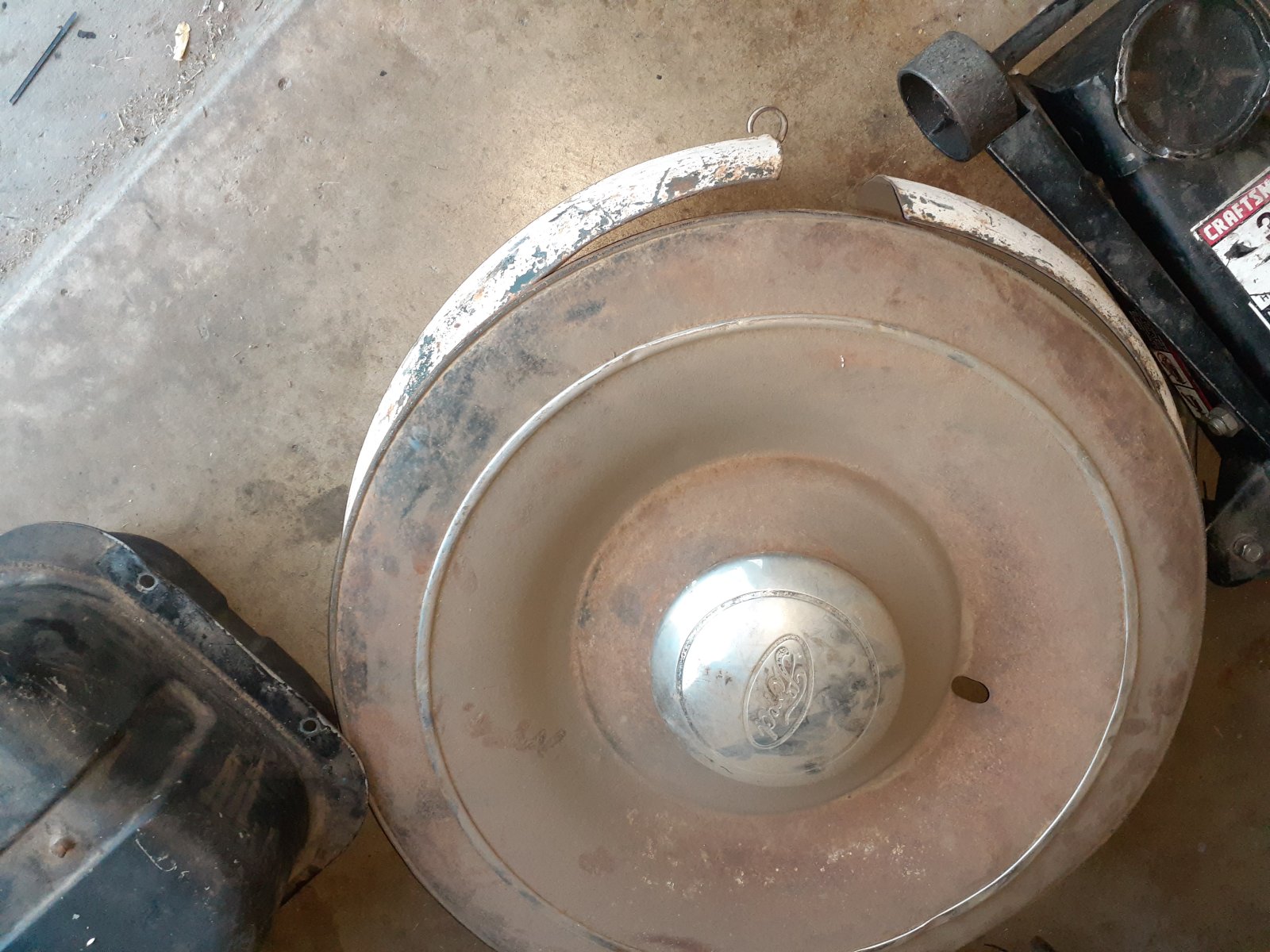

    There is not much to talk about or show. So far I have removed the starter, alternator, compressor, carburetor, radiator, grill and pulled the engine and transmission. I have also removed the seats, steering wheel, fuse box wires and gauges from inside the car. Next will be the shifter, the carpeting and upholstery.

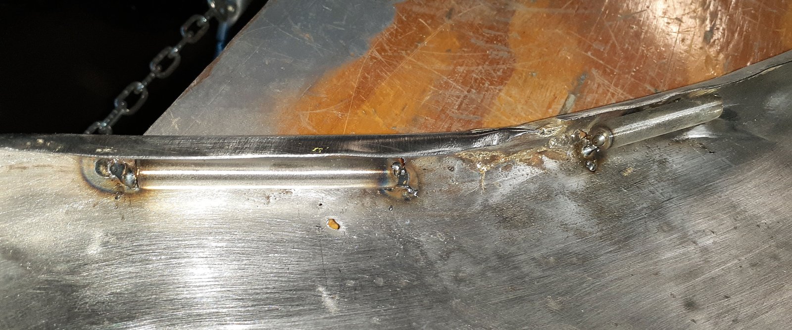

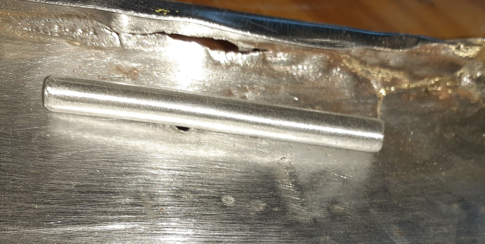

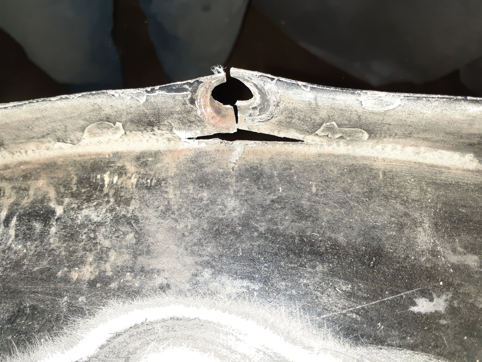

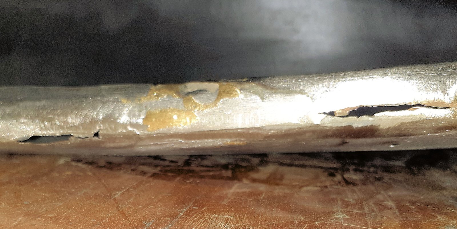

    I see yellow metal (brazing br***) in your fender lip with the cracking. It has had some issues for a while. Truly the best would be to cut it out, make new pieces and weld those in. But I get that shaping the pieces is beyond what many folks have the skills and tools to do. Those sticks of metal you welded in will not help all that much being they are straight and not curved to match the fender opening. Thin wall tubing, think electrical conduit with the zinc ground off or similar that fits inside your rolled over fender lip, can be split in half with a saw or grinder. Then it can be given a curve to fit inside the rolled over metal of the lip using hand pressure and something to bend it around. They should be welded all around on the inside as they are moisture traps. Then weld through the cracks from the outside into the half tubes to make it all strong and water tight.
    winduptoy and anothercarguy like this.

    Crusty Chevy,
    I agree that the methods you pointed out are the best way to go.
    However, although it doesn’t look like it in the photo, the rods I tack welded are a pretty good fit at the root of the fender lip. Also, since I’ve had the car for 25 years and until I removed all the old paint and body filler there was no sign of the old damage. For that reason I’m pretty confident that after filling the area with new body filler it will last another 25 years.
    Thank you for the suggestion. I really appreciate the input I get from you guys with a lot more experience than I have.

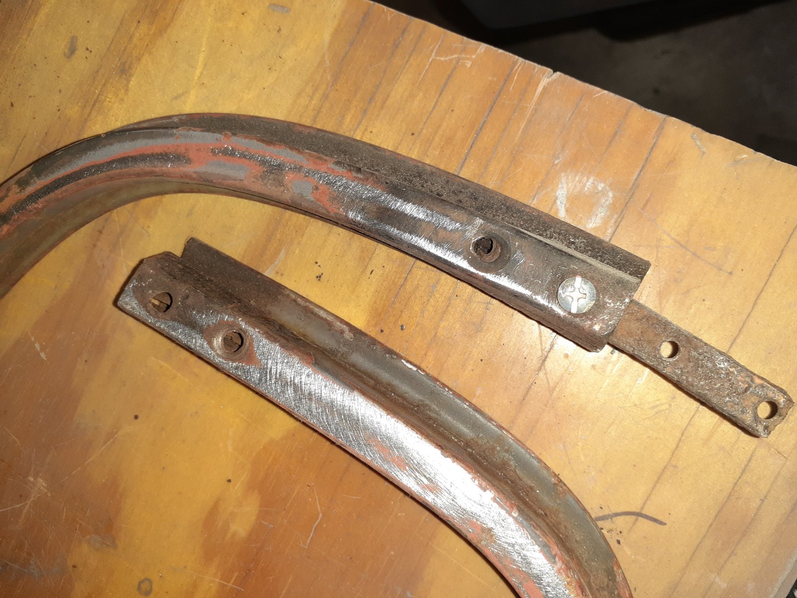

    My windshield frame has been in bad shape since I bought the car 25 years ago. I showed it to a friend to get advice on how to repair it. He said he wouldn’t try. The extruded material was too thin to be able to repair. Fortunately, many years ago I purchased a frame at a swap meet. It is in rough shape but I am sure I can repair it and get it plated.

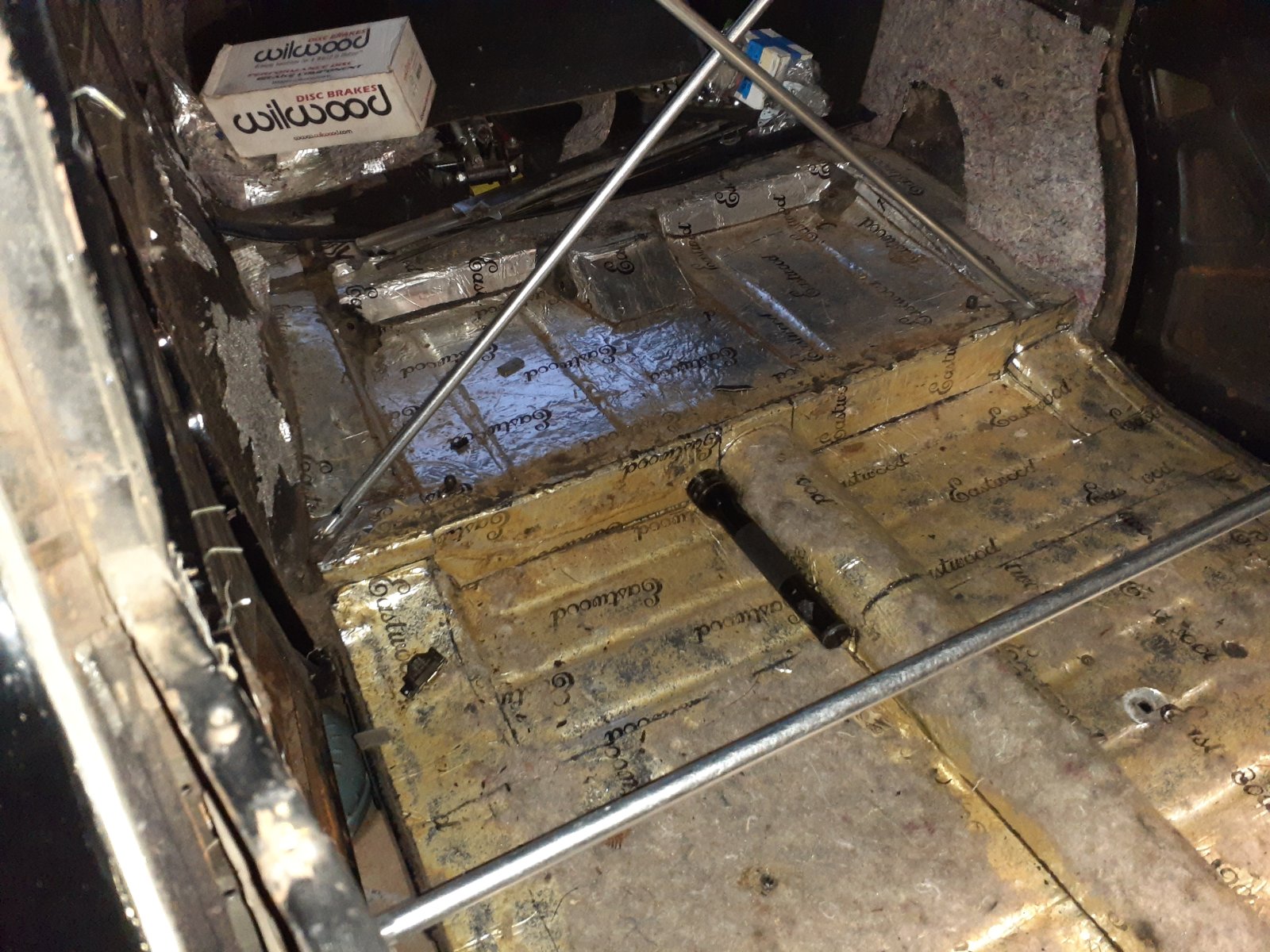

    To get ready to remove the body, I welded in some bracing to help keep the it straight when I remove it. The body seems pretty stiff now. However, I plan to cut out the firewall and recess it by 3 inches. I think the bracing will be necessary then.

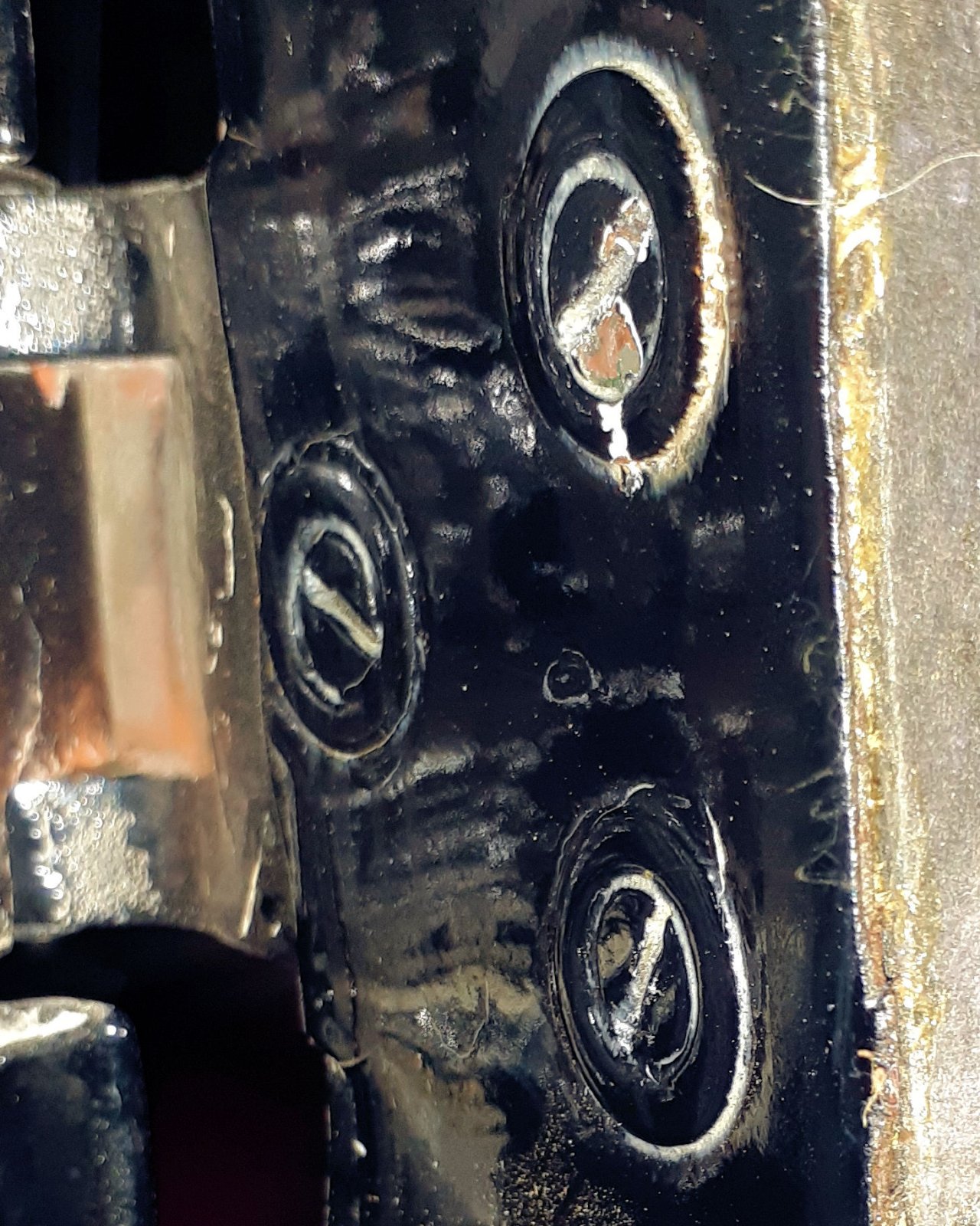

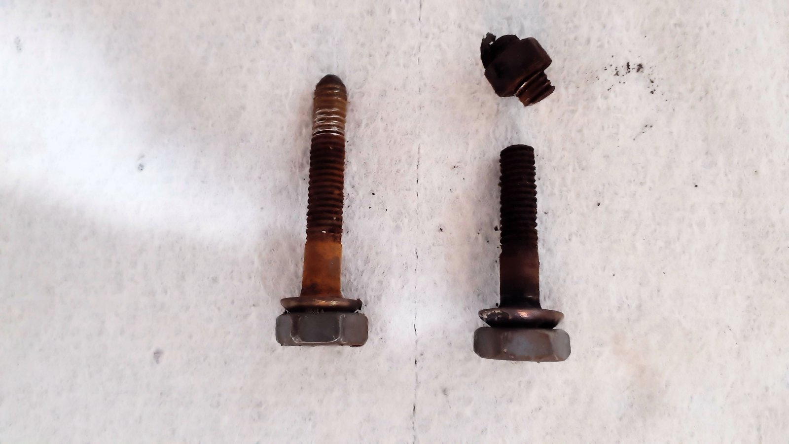

    My latest challenge is removing the door hinges. Each door hinge is held on with three 5/16 flat blade screws. The front hinges have nuts holding them and are round head. The rear hinge screws are flat head and screw into threads attached to the door frame. I welded 7/16 jam nuts onto the front screws. I was able to either unscrew them or break them and remove the two halves.
    Front Hinge Screws
    The rear hinges are next. Since they are flat head and they don’t have nuts, I will go very slowly and see what happens.

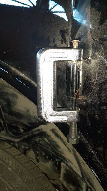

    I found a hinge removal tool from Bob Drake. It worked great on all but one hinge. That hinge broke the tool. I tried drilling out the pin with a carbide tip drill. unfortunately the drill slopped off center and I still couldn't get the pin out.

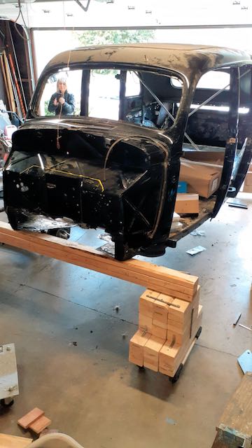

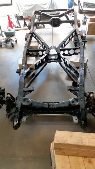

    I finally got all most everything off the body. I jacked up the body and separated it from the frame. I then built some wood supports and placed them on hardwood dolly's to support the body and frame.
    I got word from Fatman that my new frame is ready. I sent a check and am now waiting for delivery.

    I like the improvised body mount/dolly. Where there's a will, there's way! Some folks jest at Home Depot or Harbor Freight for car projects but in many cases their components get the job done.
    Always a pleasure to see nuts and bolts progress. Keep on keeping on!
