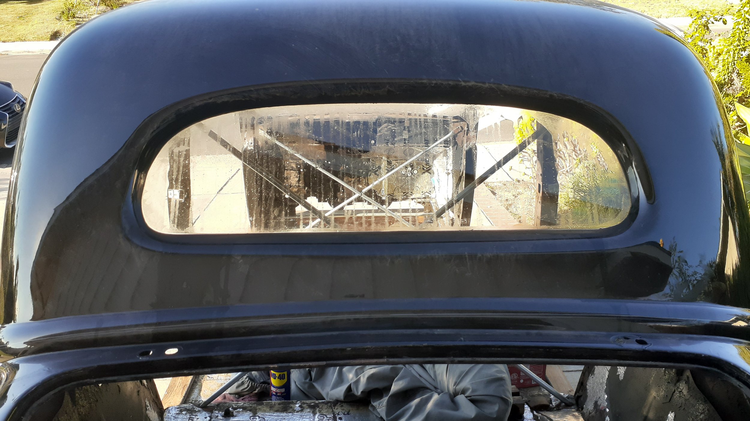

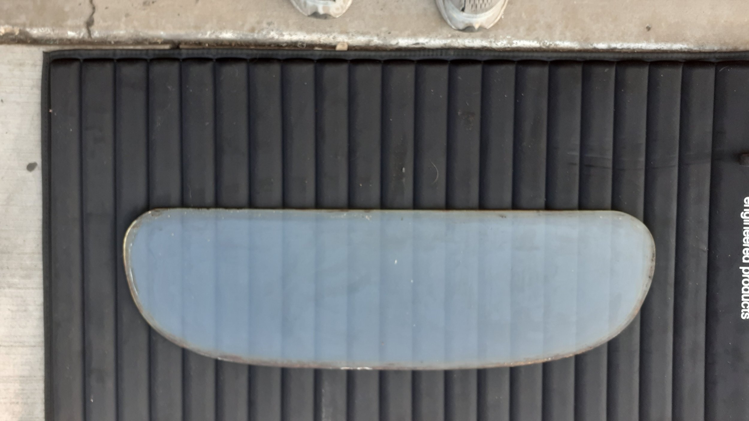

    I am getting the body ready for media blasting. I ran into some trouble cutting through the rubber holding the rear window in. The rubber was hard. I think it was installed about 45 years ago but it might be the original 90 year old rubber. I called Steele Rubber Products for advice. They suggested spraying the old rubber with WD-40. It worked great. I let the WD-40 sit over night and in the morning it was soft and easy to cut. 20250109_151159.jpg
    After cutting the seal I discovered that the window was painted in. However a little work with a razor blade and the window came right out.
    I have had the body sitting in my driveway since I took it off the frame. Next week I will rent a 6 x 12 trailer and take it to the blaster.
