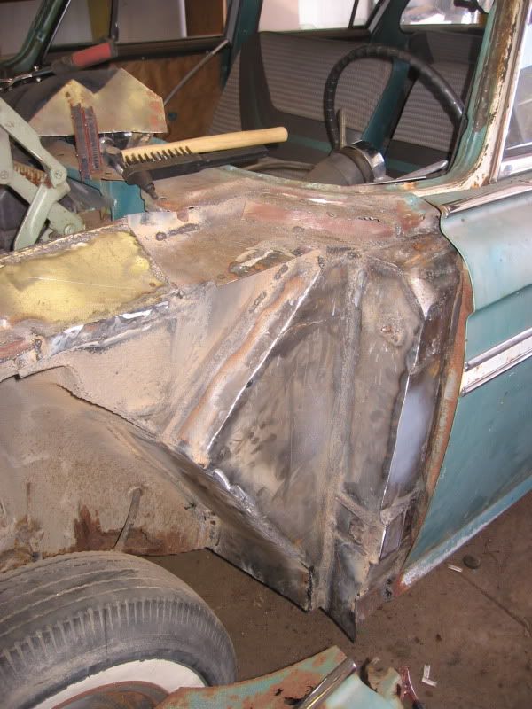

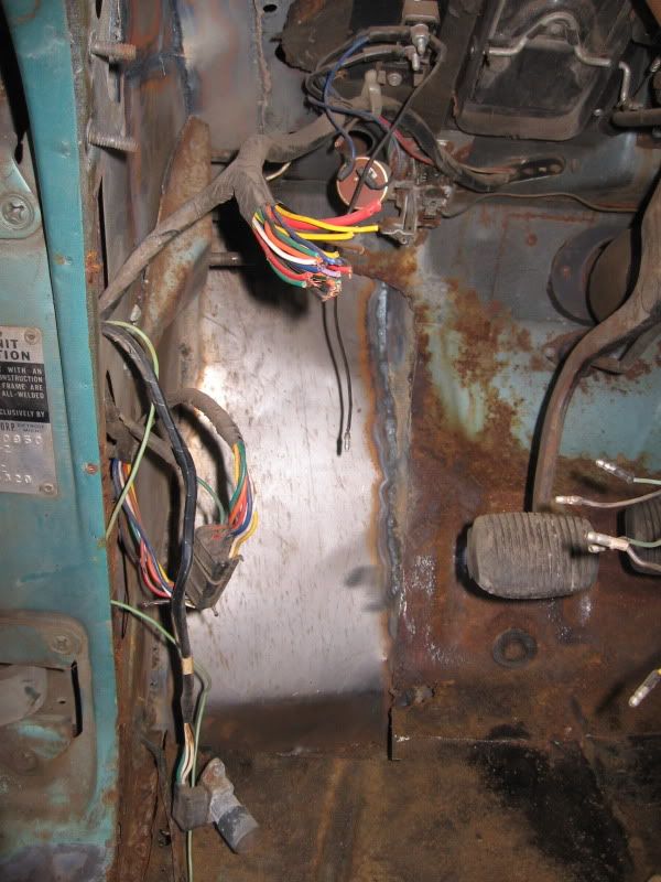

  20. Gerg
    Joined: Feb 27, 2006
    Posts: 1,828
    Gerg
    It's about damn time for some updates! Here we go got the fender on today along with the door and guess what ! it fit on the first try since this is my first major fab i am pretty happy about it. so here we are onto the pics~
    fender on and fitting
    what you can see inside the fender
    couple of glory shots or gory shots depending on how you look at it yes i know it needs some finishing but the basics are most definitly there
    This one is from the inside i have noticed that there is a hole in the floor yet no worries thats next to tackle
