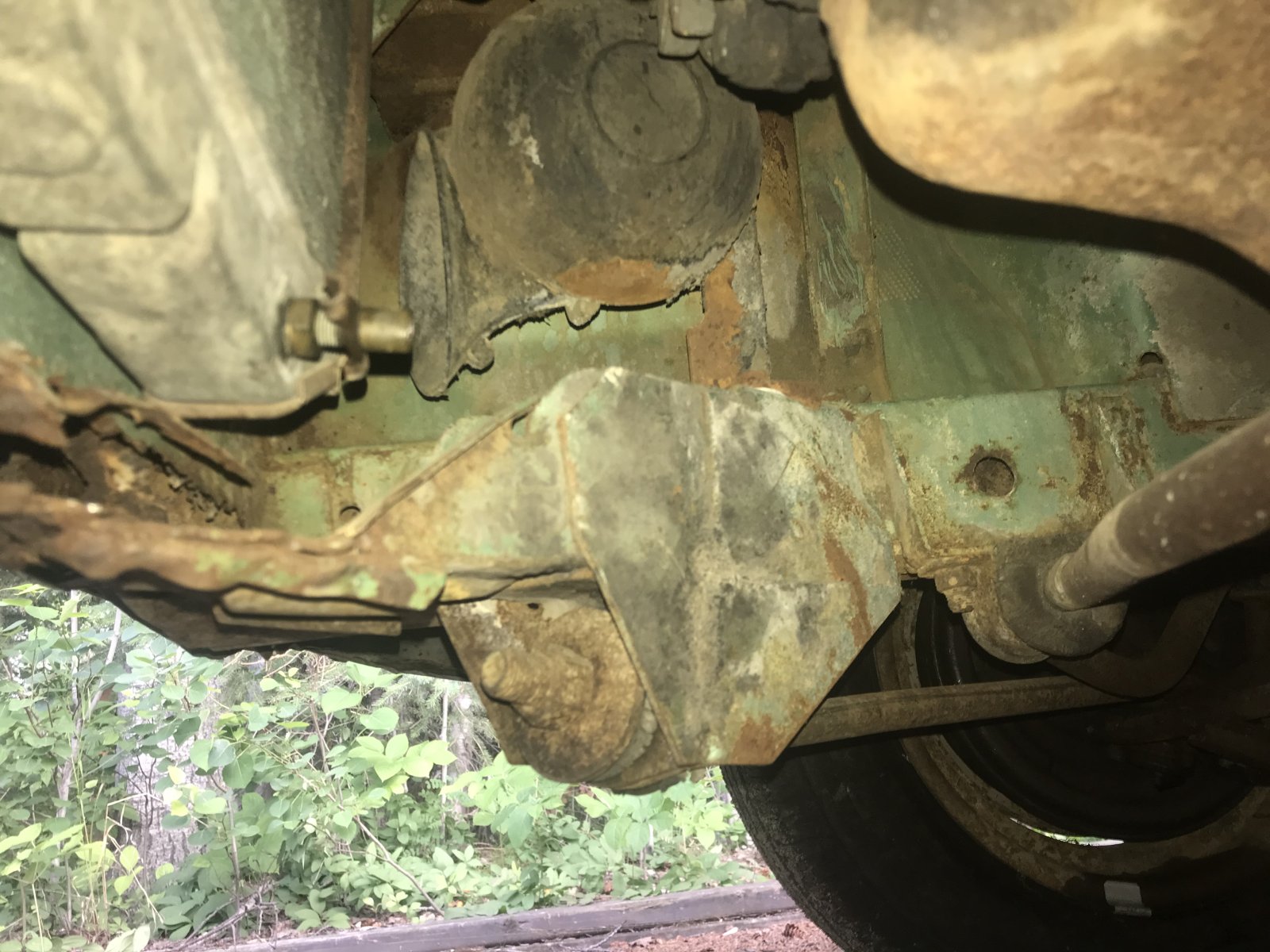

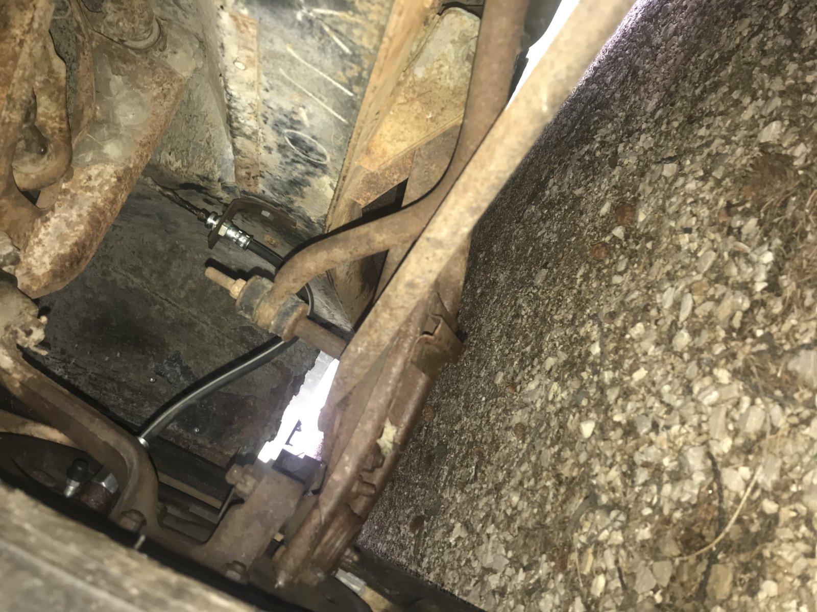

    However I took it for its maiden voyage test drive today and now that it’s back parked in my driveway I can see that the front subframe / crossmember piece that the adjustable strut rod attaches to has BROKEN OFF from the rest of the rad support!
    Now, I have a ‘61 Falcon deluxe parts car. I know that they will have the same piece. It appears like this is a bolt-in part of the car - is that true?
    I know that the entire fromt suspension is going to have to come apart to get at this thing, along with the radiator and probably the grill and fenders. While im down there rooting around, what are some things I should or could do for major benefit? Shelby drop is on the mind, along with going to ‘65 mustang control arms.
    Any and all help and badgering is welcome.

    It looks like it got smacked real hard with a rock or something at some point (many years ago) and then now has rusted out and snapped since the car was driven.

    Thats the part we’re talking about, but mine has cracked right underneath (and in line) with where the rad sits. The strut rod is actually sitting at at weird angle because its broken above where it sits in.
    Besides the massive break in the frame the test drive went well - its a 170 that someone put in instead of the 144, and it scoots pretty good for a little car.

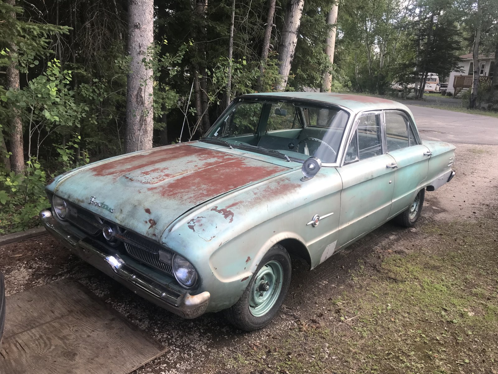

    I will have to wait until tomorrow to get a picture.
    Im not sure if the car is in original paint or not , I think it’s been repainted at least in places due to old bodywork where the bondo is peeling off and cracking. Most of the car is unfortunately bondo lol.

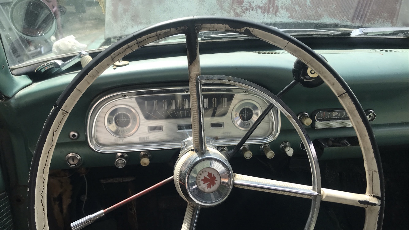

    The car was originally “Meadowville Green” so yes a light metallic green. The insides of the door jambs and trunk have preseved their color really well. Luckily the parts car was the same color originally!
    Here are some pictures i took today. The cockpit view and the car hiding.

    After a closer look and comparison, that is exactly where it broke.

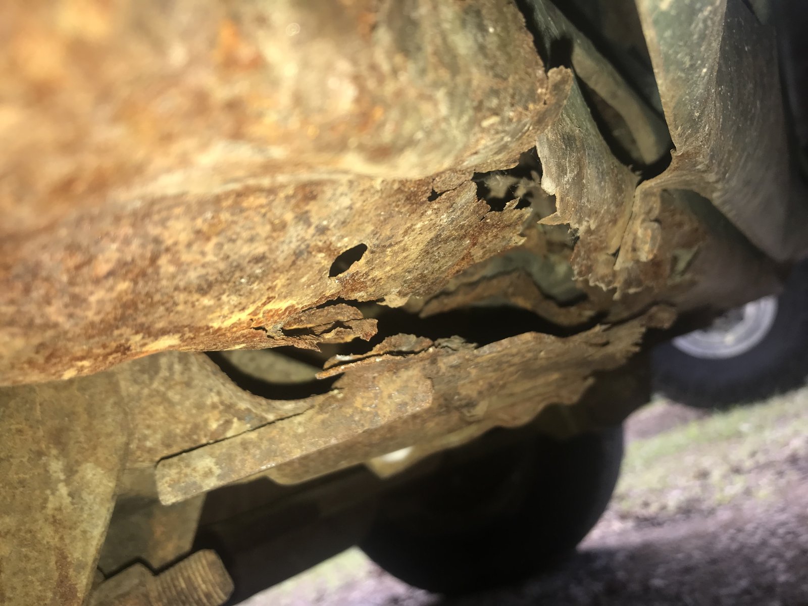

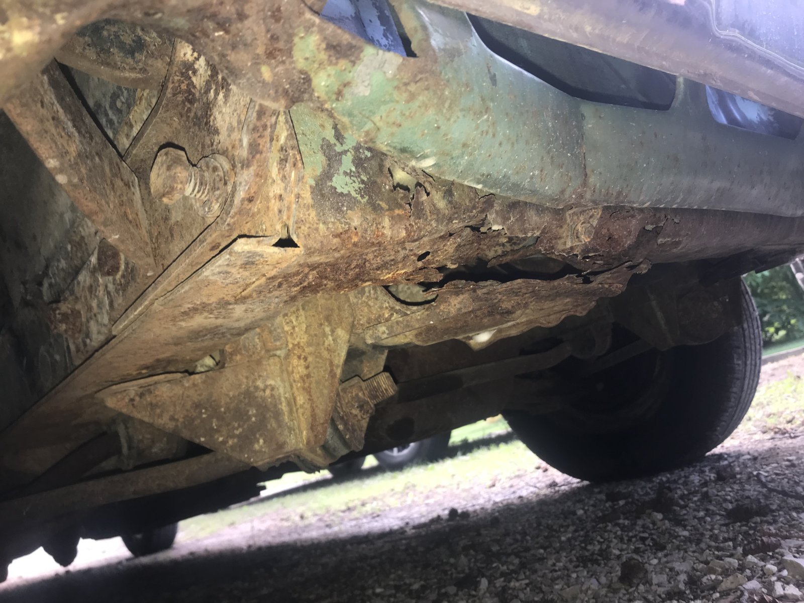

    Here’s some pictures of the poor Goose as it sits: You can probably see the issue. Most definitely rust was thr main cause of death.
    sgtlethargic likes this.
  23. FlinFlonFrontenac
    Joined: May 5, 2023
    Posts: 26
    FlinFlonFrontenac
    The other side is solid as a rock Smacked it hard with a hammer and everything. The only other rust spot was on the rear drivers side subframe rail, just before where the bumper bolts. Fixed it already, I’m guessing it kept getting hit with rocks from the wheel and rusted out over 63 years.
    Floors are brown, but solid. Most of the car is still undercoated, with the steel still solid underneath. As far as I can tell this is the only structural damage to the car, which is what makes me think it was damaged at some point and amplified by rust over the years.
    It was not a smart idea to drive the car with how this area was looking beforehand, but we live and we learn.

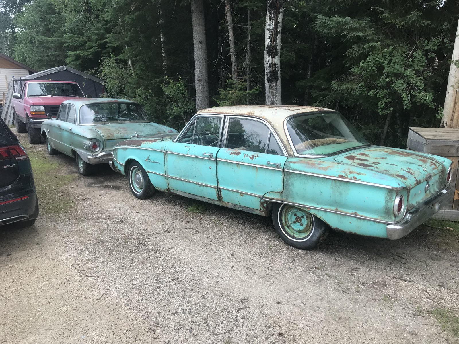

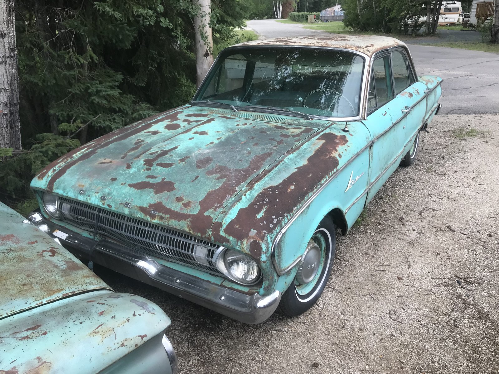

    Parts car has arrived today. Anyone know anyone looking to buy Falcon Deluxe decals or trim? Will probably make a new post or put stuff up on ebay.
    I got 2 horn rings and 3 hub caps. All the trim seems to be there along with the trunk handle and stuff. Need none of it for the goose

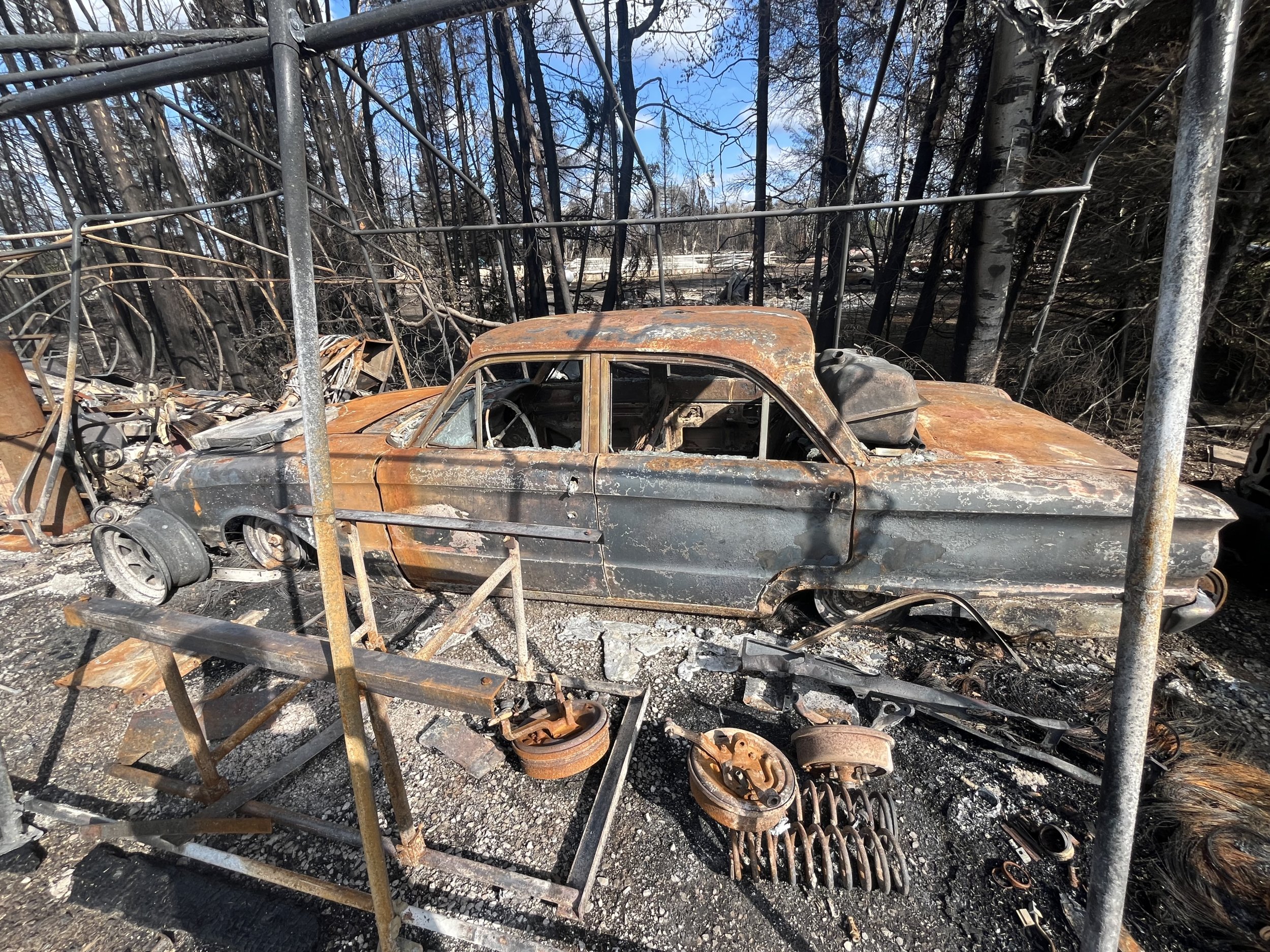

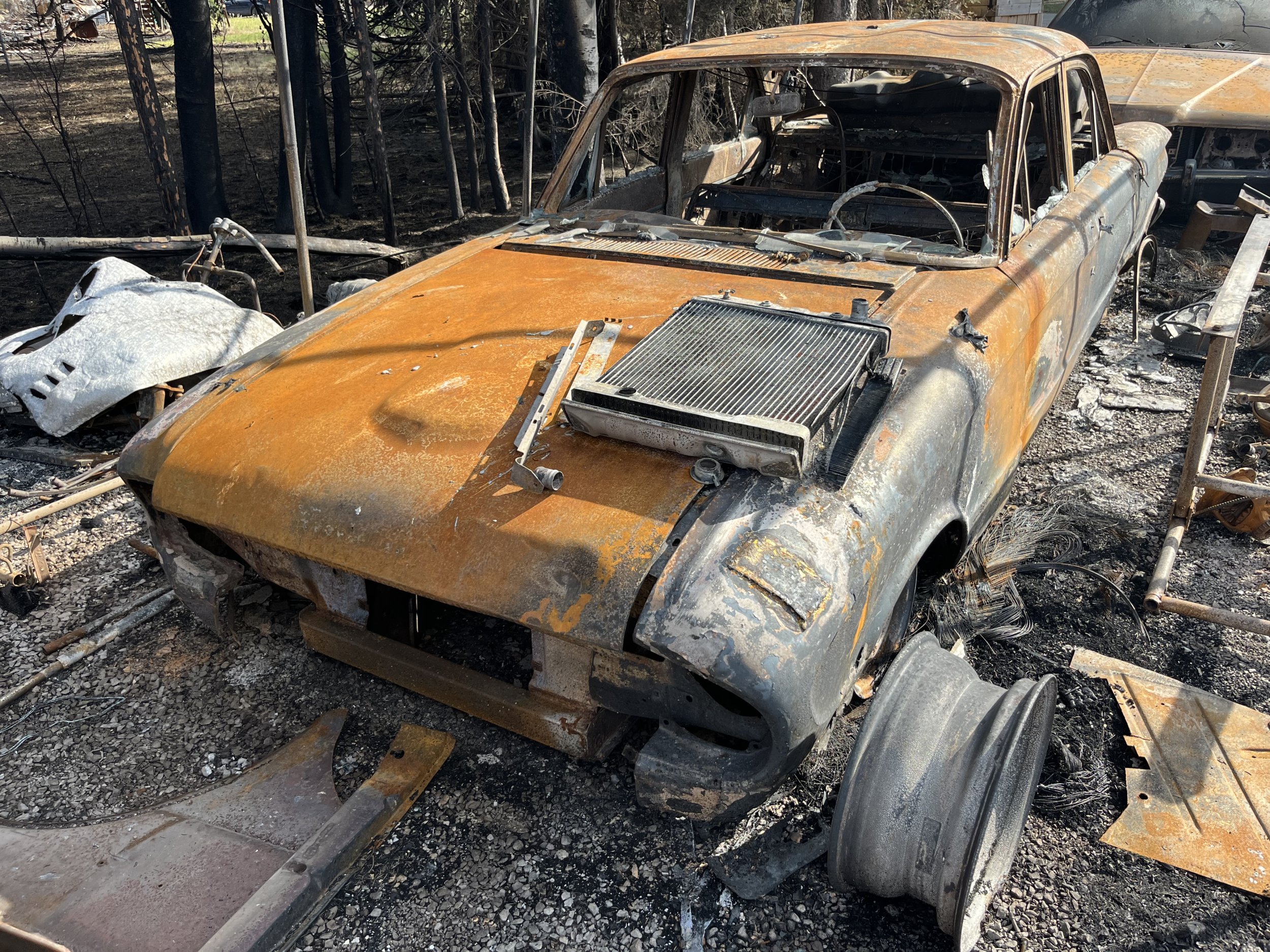

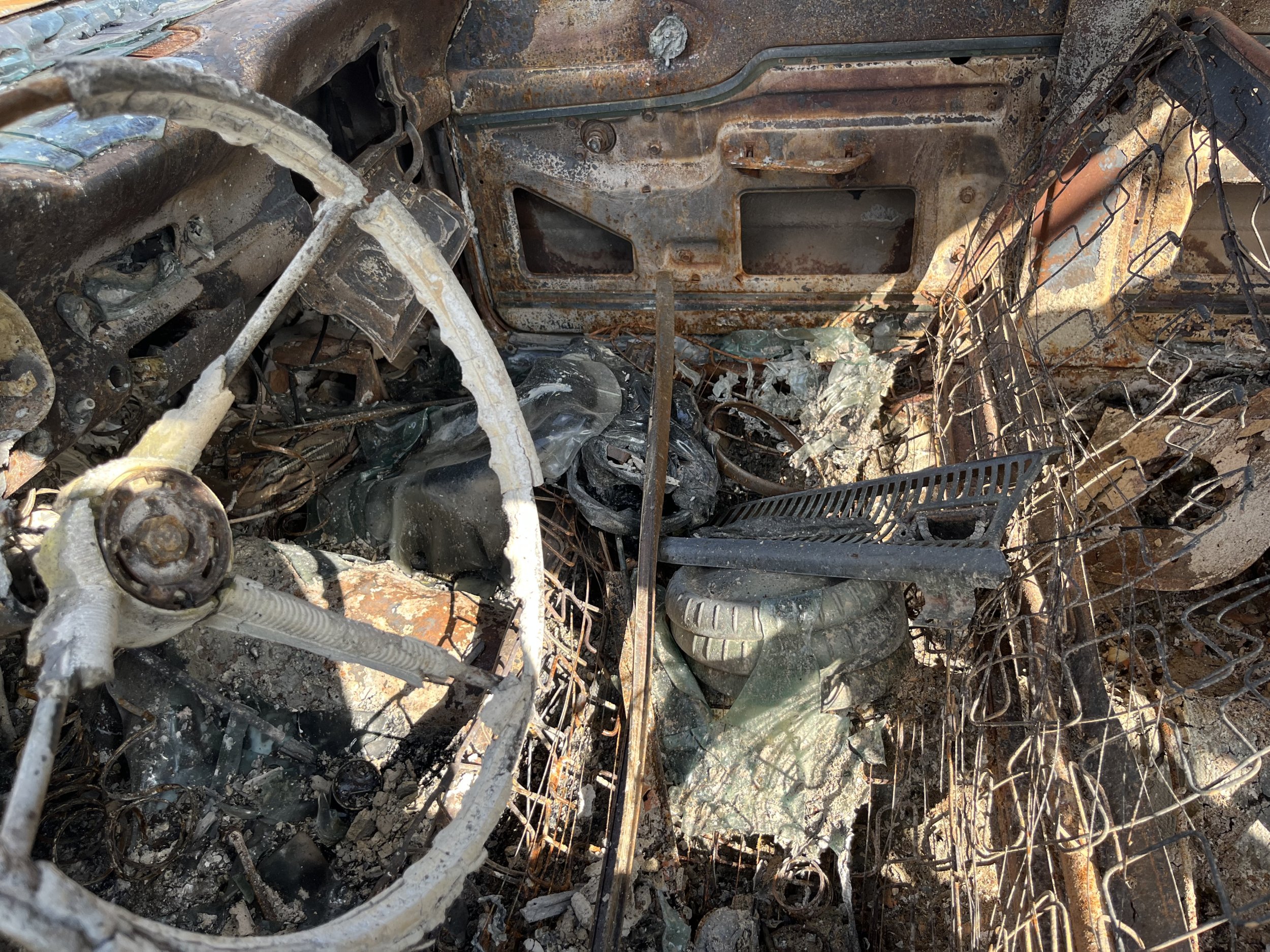

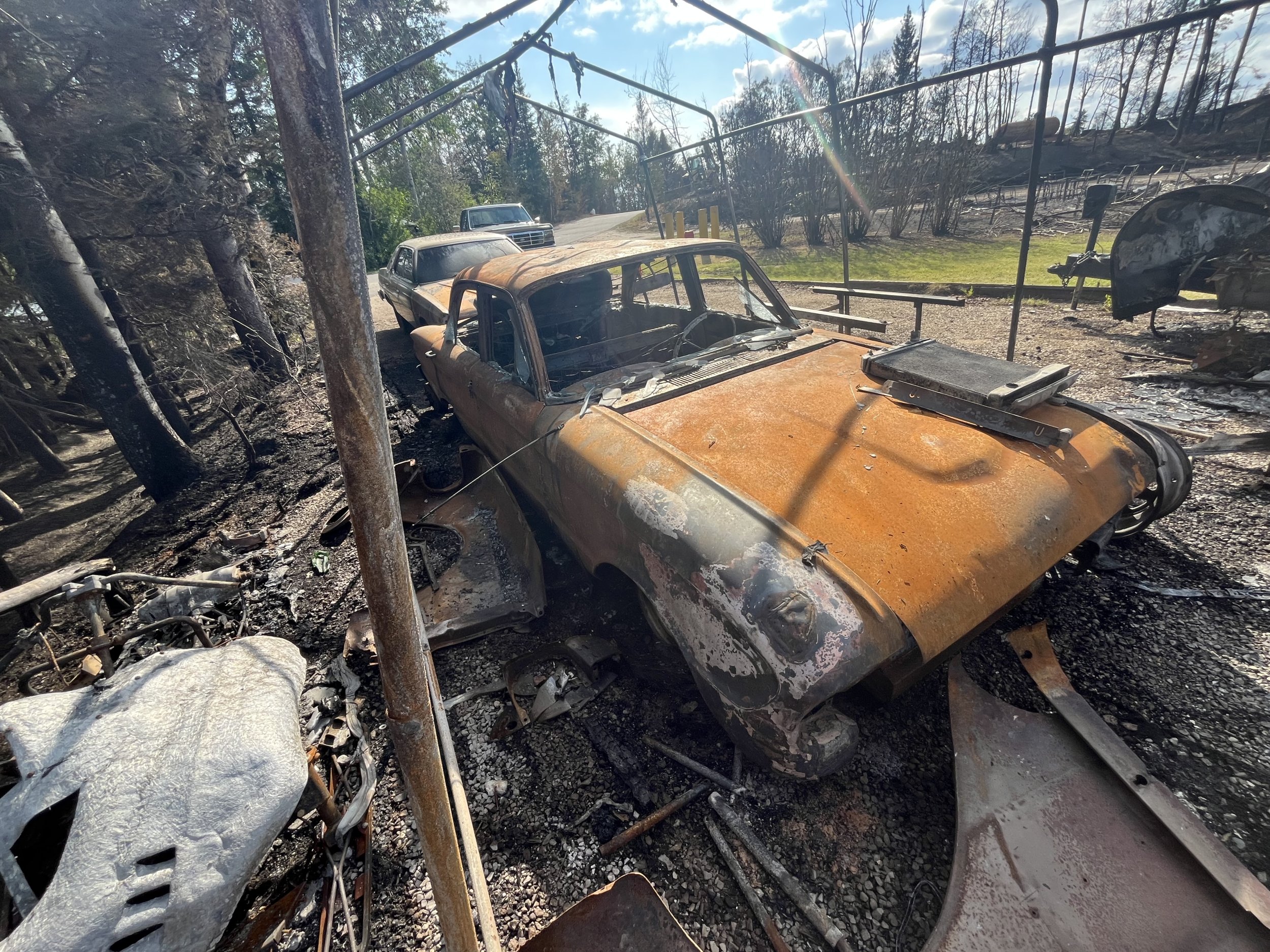

    Hey guys little update for you all.
    Wildfire season has been pretty rough on us northerners and despite the best efforts of me and my firefighter brothers a class-6 wildfire has flattened 80% of my hometown, including my own home. And so the Frontenac is in quite a sorry state.
    Anyone know anyone who’s got a Frontenac for sale? And/or knows what fire does to a cars structure.
