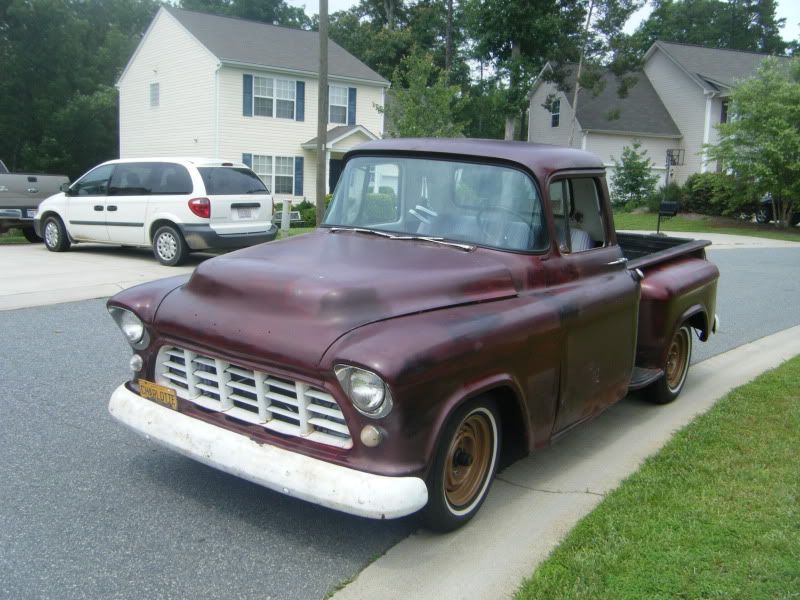

    A(L)TITUDE ADJUSTMENT...
    Before...
    After...
    Before...
    After...
    I took three leaves out of the front. It dropped it a total of 3". The center of the front fender was 31" from the ground, now it sits at 28". Still got a couple of inches of travel with the bumpstops cut in half. It rides pretty good and only barely hits on the biggest of bumps.
    Seeing it after taking the leaves out was a major boost! The next week or so will bring big changes. I'll have the back end totally lowered and the Wayne set on the engine. I can't wait for that drop axle! I did some measuring and it's gonna be SUPER LOW front and back. Four more inches in the front from the drop axle will have the fender just barely above the whitewall stripe. Six inches in the back from the mono leaves and drop shackles (they'll be here Monday) will have the fender even or below the top of the rim. I can't wait to see how it turns out! It should be about as low as you can go with stock type suspension and without altering the frame with notches and still be able to be driven just about anywhere...which is the way I like it!

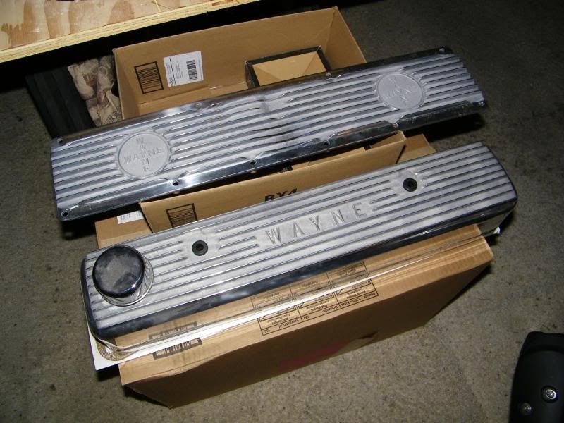

    I got the Wayne valve cover on today. Once again, not without issues. More on that in a bit.
    It comes nicely polished. So the first thing I did was give it a good touch up polish with my buffer and some Mother's aluminum polish.
    Then, off with the old. Man, that's ugly.:eek:
    Next, it's time for a test fit. Here's where the issues crop up. The thermostat housing in the front of the block interferes with the new valve cover. The included instructions mention this and say to grind off carefully some of the thermostat housing. Here's where you need to remove material...
    Once that's done and checked for fit again, I ran into another small problem. The included nuts in the kit were the wrong thread. Nothing a little trip to the local hardware store couldn't fix though. Once that was sorted, I tightened down the cover, installed the breather and acorn nuts. And here's the final result, 1,000% better...:D:cool:;)
    Although I got this in a trade with my buddy Delton (he got it from somebody on the hamb), Patrick's Antique Auto sells the valve cover and side cover as a complete kit. Included was a new valve cover gasket, breather, and all the hardware for the install. Keep in mind, I didn't get a side cover gasket and the nuts mentioned above were wrong. Just something to keep in mind and something you should check before you get too deep so you can have everything you need. I like to support businesses like Patrick's (even if second hand, lol). He is a cool guy and passionate about what we do. He is the one that makes this stuff and Fentons.
