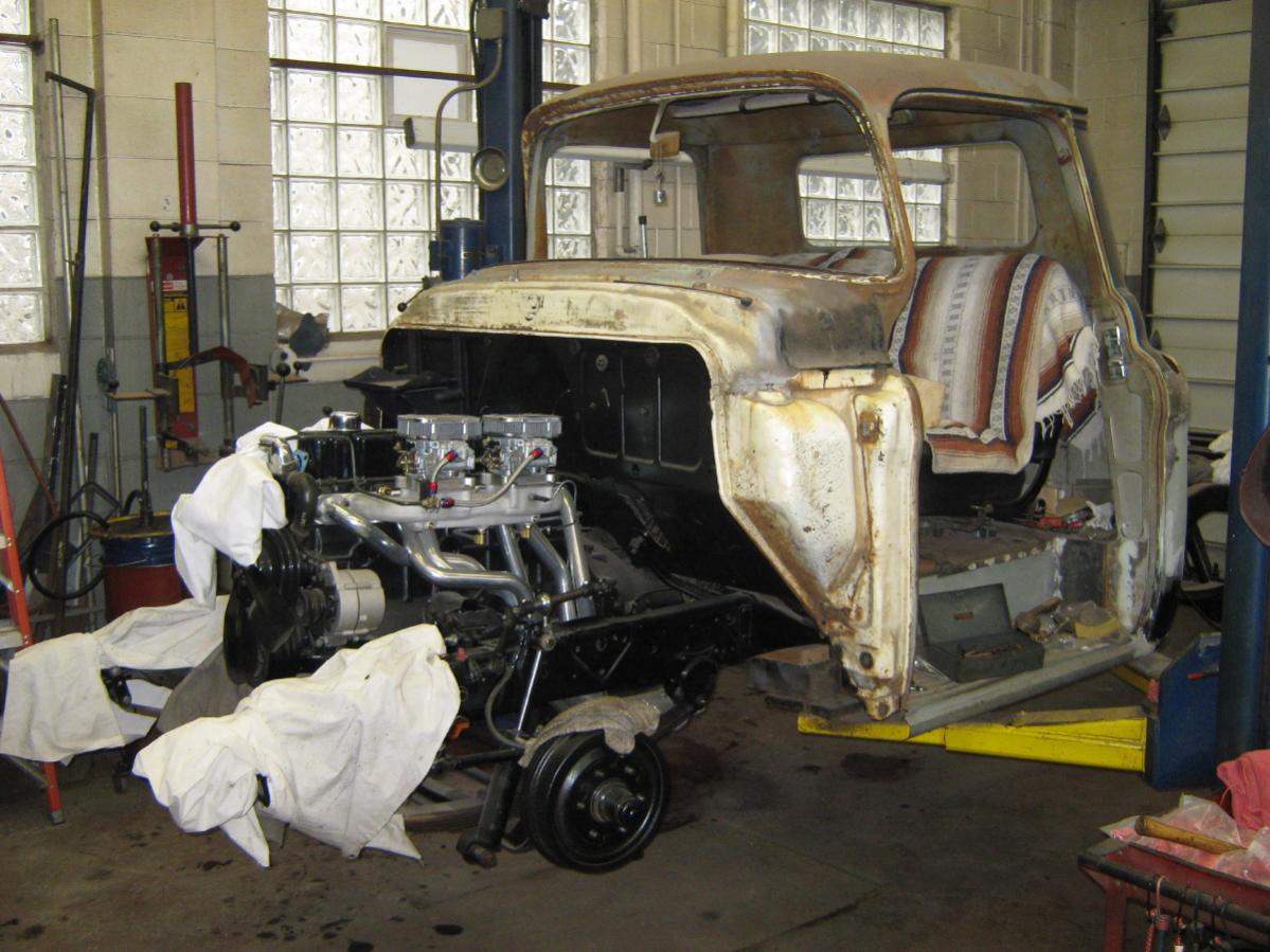

    Ok, it's been a while. But I've been busy with a total rewire on King Of Trucks. I ended up going with a factory style replacement harness with all the connectors. It was a little more expensive than a Rebel or the like, but easier to deal with. Some of it has been ridiculously simple. Some of it has been cornfusiner'n'hell. The truck had extra relays which took me a while to figure out it only came with one. It took me about a half a day to get the gauge cluster out. Turns out it has a tiny lip that gets hung up. Then it took a while to figure out how to get the headlight knob out (there's a little spring thing to puch in behind the dash on the switch). Then the switch itself wouldn't come out because someone previously screwed up the retaining nut. Oh, and I busted a terminal on the generator just by taking a nut off.
    All in all, rewiring has been a giant h***le but a great learning experience. I now have a much better understanding of how the circuits work by knowing the routing from this to that. I've still got the tail lamps/turn signals to wire up and it'll be driving again.
    I sold my '63 and have begun the search for hop up parts for the inline. I've got a line on a two pot intake with new carbs and linkage locally and am waiting to go check it out. I'm looking for some chrome steelies and a split exhaust manifold. I'm also going to check out a big window parts truck to see if there's anything I can use. I'd love to have the big back window cab. We'll see...
    So here it is in print, my plans that is...
    Stage One: Tune up and fluid change.
    Check
    Stage Two: Rewire to keep from catching fire.
    Almost check
    Stage Three: Lowering all the way around with dropped axle/flipped rear.
    Getting ready to order from Sid's
    Stage Four: Engine Hop Up with two pot carbs and split exhaust manifold with dual exhaust.
    Actively searching for parts
    Stage Five: Full on semi-radical interior. Flaked dash, lots of white, very bright.
    Looking at all the pics of flake I can find to find out what color I really want (leaning towards Roth mind splitter or bong water or maybe a bright blue)
    Stage Six: Full on exterior paint and new chrome along with painted or chrome steelies.
    I have only begun to think of outside colors. Suede or shiny? If I go with mind splitter on the dash, maybe gold exterior. With green on the dash, who knows?
    I'll get some new pics up as soon as I have some progress. I'll probably order my lowering stuff on Monday and get to installing it right after Thanksgiving. I'm sure it'll be just as much of a h***le as the rewire job. That's how it goes for me, lol. Thanks for this awesome forum and thanks for the inspiration.:D

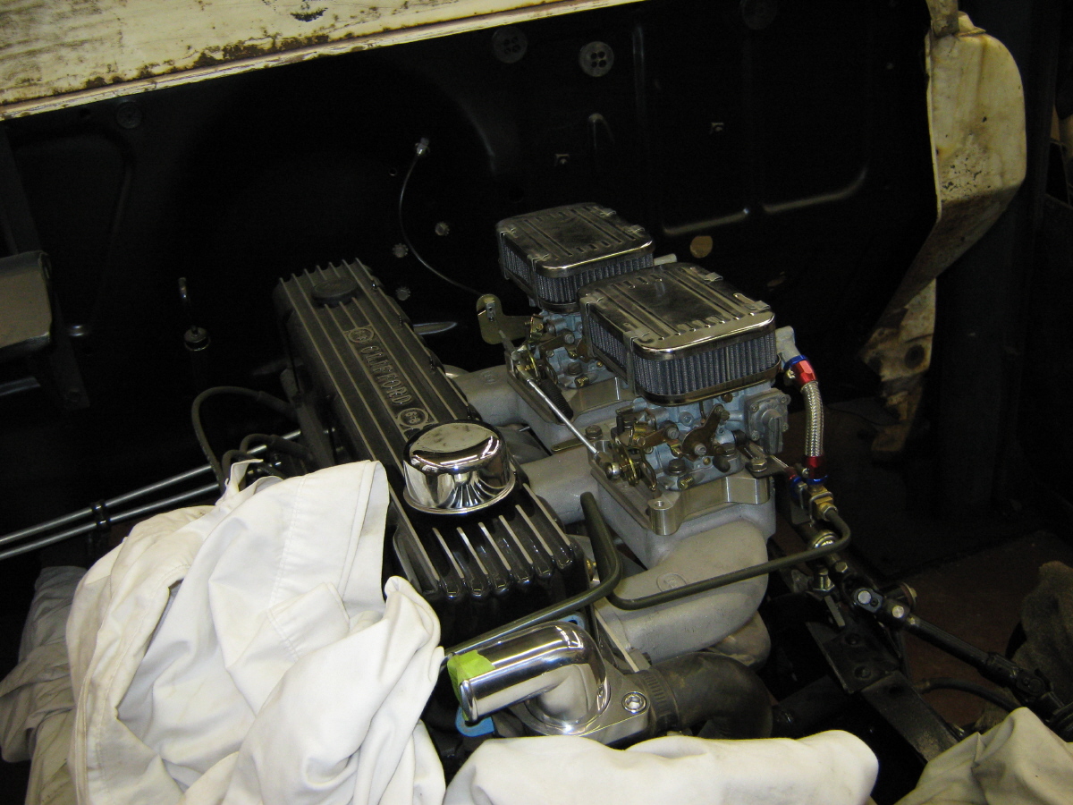

    Still fighting this wiring. It is whooping my ever lovin' ***. :D I am making progress though. Also today, I picked up a brand new offy two pot intake with two new carbs and all linkages and lines. So there is some good news. All I need to find now is a good split exhaust manifold and the engine will be done. Well except for some paint and some chrome under the hood.
    Here's what I got today...
    Two brand new factory rebuilt carbs, one is an automatic choke and the other is a conventional cable choke. It's a progressional setup with one carb working all the time and the other coming on for full throttle. I'm not familiar with multi carbs, but I've been reading and learning as much as I can.
    Here's the intake, it's an offenhauser. I also got offy linkages and fuel lines, all gaskets and risers, and even a fuel filter with the deal. Should be pretty much bolt on, tune, and go. I also got a setup VHS video that came with it. I don't even know anybody with a VCR anymore.:D
    This setup was purchased as a "complete kit" by a guy who bolted it to a rebuilt, never run 235 and has since sold the car it was going into. I picked it up off of craigslist. The engine is still for sale. It's got three sleeves and a mild cam and "professionally" rebuilt and has not run since it was rebuilt two years ago. If you're local, I can put you in touch with the guy, PM me.
    I can't wait to get done with this stupid wiring so I can start setting up those carbs and working on a decent exhaust. I'm now actively searching for a header and some cool air cleaners, PM me if you've got a 235 split manifold you keep tripping over. :D

    Well, the rewire job fought me every single step of the way. I broke a terminal off of the generator. I pulled the back plate off to fix the terminal only to realize one of the brushes was blown out where the wire goes in. Hopes and dreams (and spider webs) must have been the only thing keeping it together so it would run. I got a used generator in good shape off a runner for $20 and swapped that out.
    Took me half a day of careful prying to get the gauge cluster out. Took me another half a day to get it back out when I realized I forgot to screw on the odometer and oil pressure gauge fitting. My truck had three relays under the hood, I only need wiring to one. Took me a while to figure that one out too. Same with the ignition switch, the one in the truck was aftermarket and only had three terminals. I needed way more.
    Just when I got rolling good, I had to stop to go out of town for Thanksgiving with the family. When I get back, all the momentum I had gained was lost and then some. That's just a small taste of the heartaches I've been through.
    So I finally finish up everything today, well almost. I still have to wire the turn signal lever to the harness. Have to wait on special terminals and a connector in the mail, $8 shipping for $4 worth of parts, lol. But anyway, I can drive it. Well, almost. I go to crank it up this afternoon after finishing swapping out the generator and the ****ing battery is deader than disco. It's three years old, so it was bound to happen sooner or later and with the cold weather we've been having lately it's really no surprise. But ****, all I've wanted to do the last month was drive my truck.
    I'll have to wait one more day. It was too dark and too cold and raining like hell tonight to keep messing with it after I got the new battery. I did get it to spin over a couple of times before the old battery went totally dead. At least I know I should be driving tomorrow. We'll see...
    And if all that wasn't bad enough, I bought a factory split manifold. Great, right? Wrong. It got here with the extra outlet broken off and a giant crack in it. Fuuuuuuck.
    But progress is progress. And I'm making progress albeit ever so slowly. Realistically, it'll be New Years before I get a replacement manifold and get the carbs installed and tuned. With my luck, it'll surely take longer. It's never easy over here, but I always learn a lot. So I guess I can't really complain. I want to call Stage Two done, but I won't until I've actually driven it and find everything working. :D
