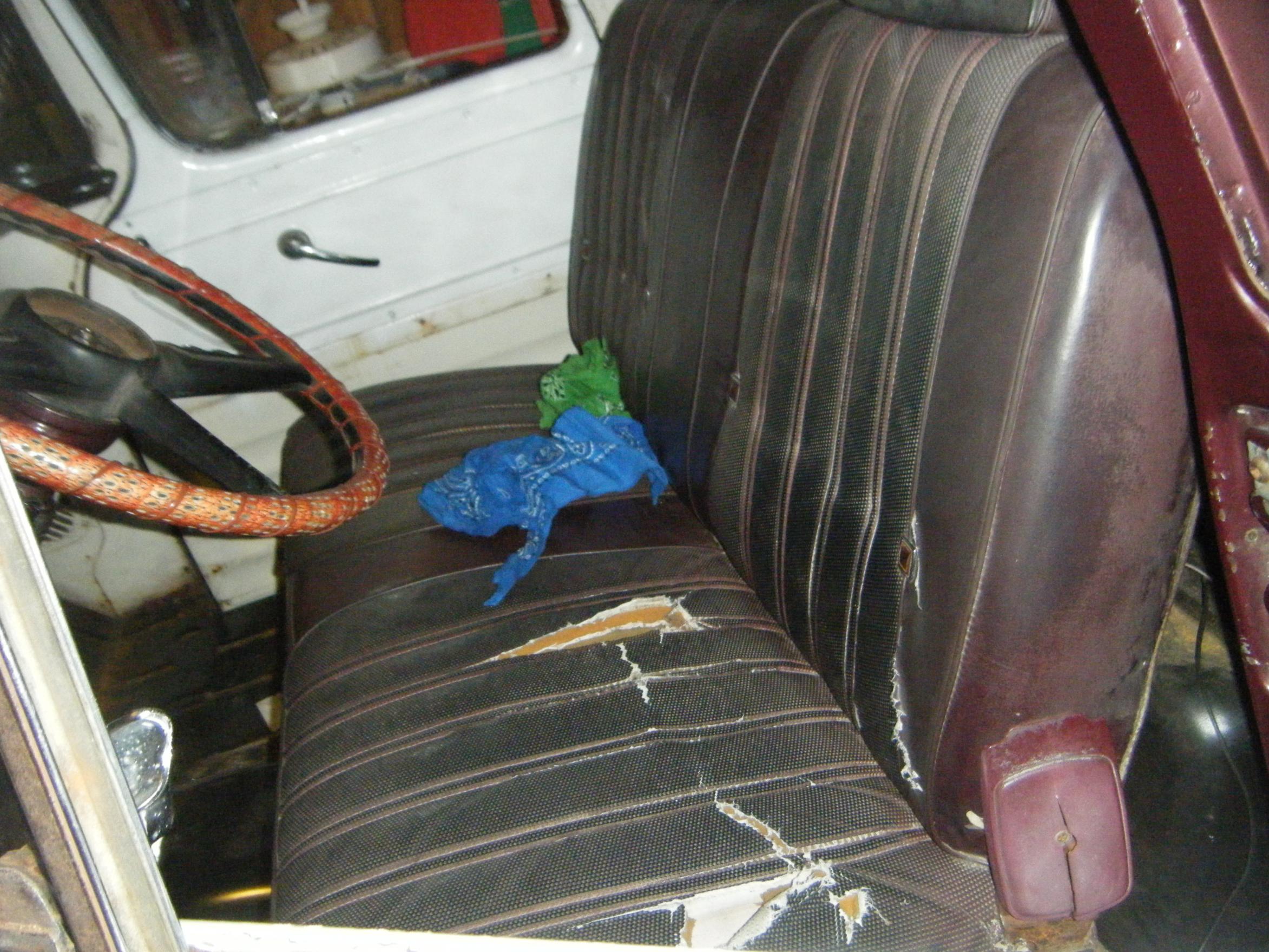

    I'm picking up a proper seat soon. It's out of a '60 apache and folds forward. The one in it now is from a '70s car, is totally ugly, has ugly plastic, and doesn't fold forward. When I swap the seats, I'll get the fuel sender wired up and grounded. That's the last hurdle to finish up the rewire. No gas gauge til then.

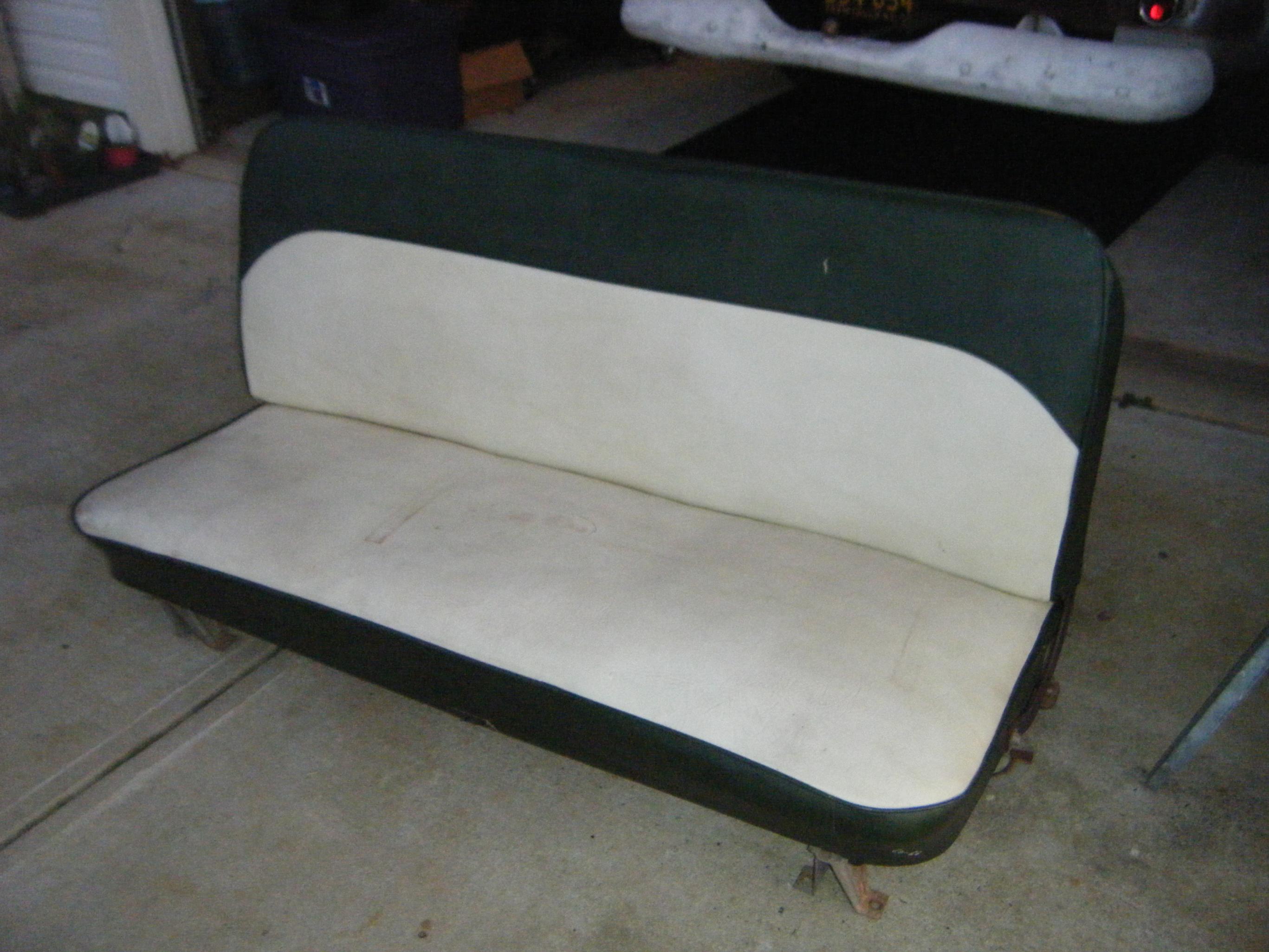

    Now on to better news. The truck came with an ugly, no make that hideous, old car bench seat. It makes me sick to even look at it. Not to mention the springs are worn out and it's terribly uncomfortable along with plastic pieces and headrests. It doesn't slide and it doesn't fold forward, lots of rips and tears as well. It's totally wrong in every way. I picked up a seat out of a '61 Chevy truck today. It's in really good shape and sits really nice and comfortable. The best part is it looks so much more period correct. The color is wrong for my final plans, but it will certainly do for a good long while until I get to stitching up a new cover on down the line. All in all, an awesome score for $60.
    I also got a slow leak in one of my tires fixed. It was leaking around the bead and at the valve stem. Just another small headache cured. The seat came around at just the right time too. I was going to have to pull the other seat out to get to the fuel tank to check the sender and hook up the sender wire I never got to during the rewire to make my gas gauge work again. Perfect timing, although I'll likely have to drill a couple of new holes. It's gonna be super cold around here for the next little bit but I'm going to try and get the seats swapped out along with the sending unit/fuel line deal done over the weekend. Keep your fingers crossed for me.
