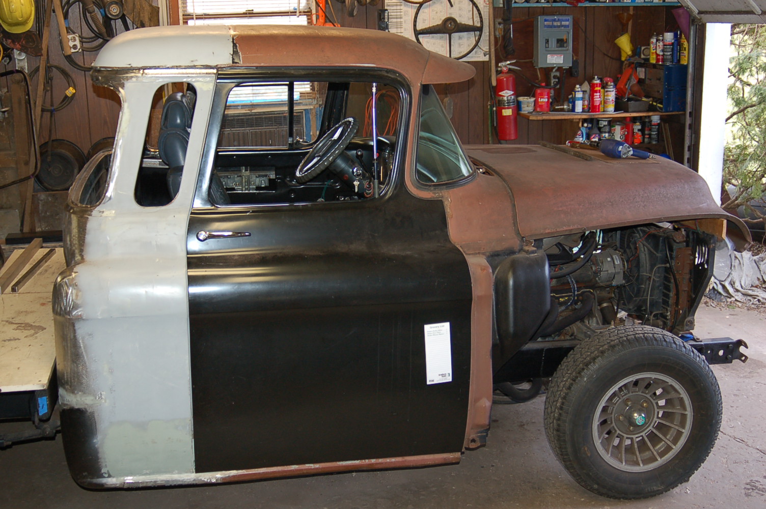

  10. Here's what's keeping the sport coupe project on hold.
  11. terd ferguson
    Joined: Jun 13, 2008
    Posts: 3,734
    terd ferguson
    Is that one of those repop doors? How do you like it? Would you buy them again, are they worth the $500 each?
  12. It's my 75 yr old playmate's truck. He got the repop doors and front fenders from a California vendor, I'll have to get the name. Fit is excellent, we were able to get a constant gap all around.

  16. The doors and front fenders came from"Truck Shop" in Callifornia.

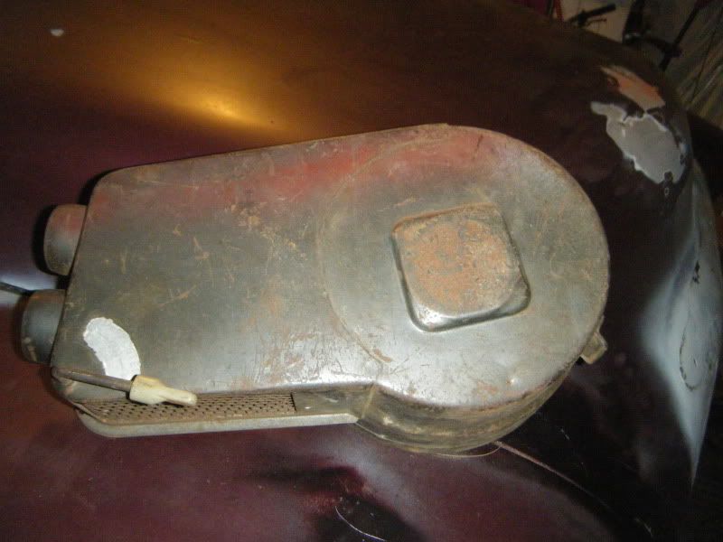

    Here's the new heater...
    And here's the heater switch...
    I'm trying to figure out now about the heater's blower motor. Apparantly, it's got a replacement motor with four wires instead of just one in the factory blower motor. My theory is that each of the four wires is for a different fan speed (the factory switch has a rheostat like your dash lights dimmer function that controls the fan speed). I'm going to hook each wire to power and see what happens. If it works like I think it should, I'll hook the switch up to the highest speed wire and go.

    So, when we left off last, I was trying to get some heat. I hooked both heater cores (the old aftermarket one that came in the truck and the "new" factory one I just got) up to the engine and they both leaked. I sure am glad I hooked the hoses up to test them before I went to all the trouble of installing them all the way. So I still have no heat. But, the good news is another hamber buddy is sending me a good factory heater core! All is not yet lost! If that one leaks, I can get one of the three repaired for about $65. I did get the heater switch wiring figured out and as soon as I have a good core I'll be able to get it going right away.

    You are definately right about the heater switch getting hot. I hooked it up momentarily when I was testing the motors and it got VERY hot! And it was only running for a minute or so. I think I have that taken care of though. More on that soon...
