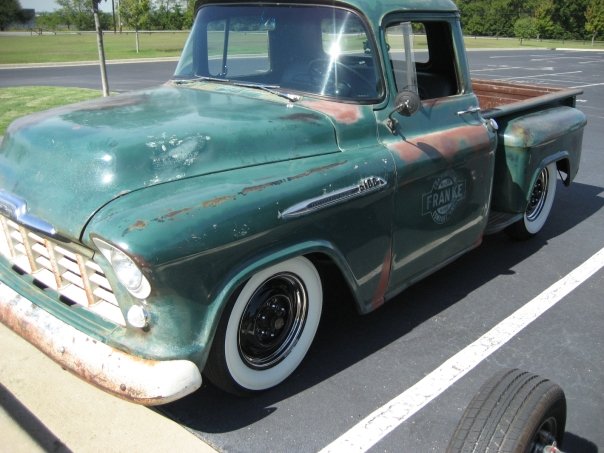

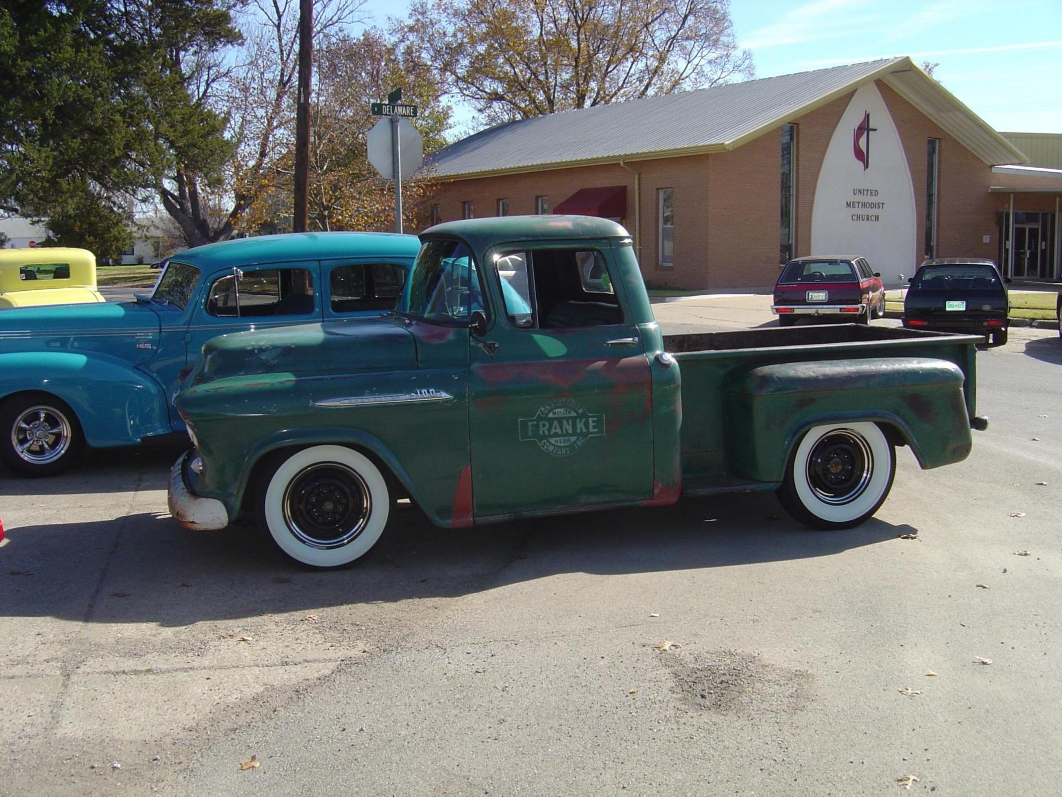

    It was 3wLarry's '56 Chevy truck, named Franke after the construction company's name painted on it back when it was new. It is a killer, killer truck. Do***entation all the way back to new. Special ordered truck, factory smooth dash with no radio hole and only a headlight and choke knob. Original paint and original door lettering. Killer stance with a straight axle up front. Definately not the shiniest or prettiest truck out there, but perfect in every way nontheless. My buddy Dustin (sin ticket) just bought it and it's on it's way to NC.
    Here's the for sale thread...
    http://www.jalopyjournal.com/forum/showthread.php?t=452028&highlight=franke
    And here's some pics I saved a while back...

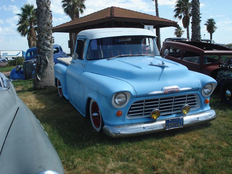

    ibcalaveras
    I like your thread. It reminds me of when I started building my 56 Trocka. The best part was going for a ride when I got something new added. Here is a couple before primer and Blue primered picts to help motivate....Best wishes and keep at it...:cool:

    I love your truck! I saved some pics of your truck in blue too a while back. It's a good look, love the fog lights! Do you have any other pics? And how about a better pic of that gold color? Do you know the name of the gold? I dig it! Thanks!
