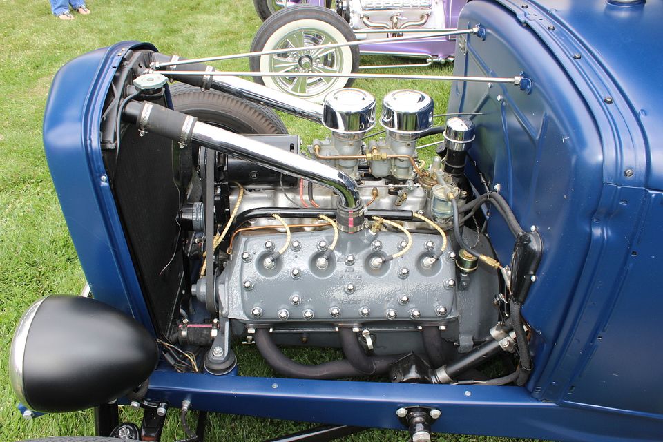

    While there are legit and honest reasons for running an electric fan I'd say that on that car a proper mechanical fan that can pull enough air will work fine Except that thick *** radiator (not a bad thing) might be taking up the space where the correct fan that fits that engine wants to be.
    Looking at a couple of cars I have taken photos of it may be seriously close.

    I guess what I should be asking
    is there an era of Ford or Mercury engine mechanical fan set ups that would be better for my tight spacing
    I wouldn’t be oppressed to an aftermarket set up
    I can research very well but would like to hear what works best

    Mr48, thanks for the pictures and commentary, it always helps to see the options.
    Lloyd, I get it, I’v thought about converting to a pusher and hiding it behind the grill,
    not sure about the look of no fan and the spacing is tight between the rad and grill

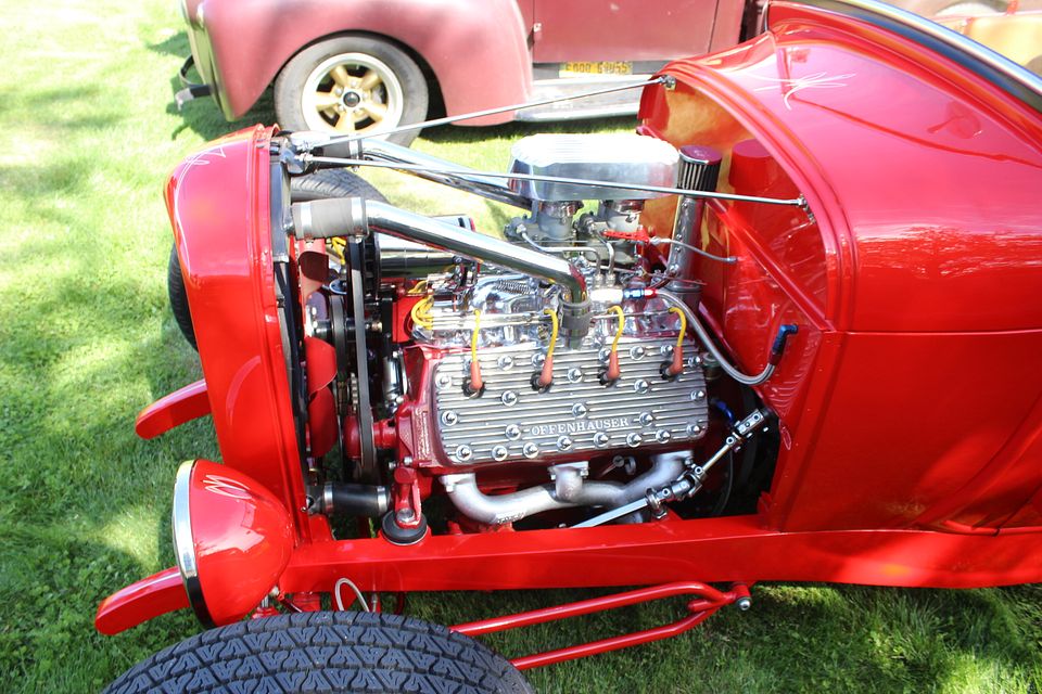

    Sidevalve
    Also I’m running a crab style distributor,
    not sure you can see it in the pictures but it may interfere with an 8BA style pulley system for a mechanical fan

  17. I think your first move in determining how or if is to get a 2-shive bottom pulley for your motor. Then a stand-alone fan mount that lines up with the new lower. There are a couple different styles and not all are a direct connection. I see your Gen mount is already set up to accept the Fan mount bracket. Chose a fan blade wisely.
    CSPIDY likes this.

  19. To some degree this is what you're trying to end up with. If it didn't have the offset Gen it would be a direct connection.

    This is more or less what sidevalve posted. I don’t late Flathead, I just happen to have this one sitting outside. As stated, the crab distributor may interfere with this style pulley. What pulley is currently installed? For the time being, i would be more worried about the way that generator is mounted to that earlier manifold. Maybe it’s the photo, but looks way up there!

    My generator does look like it is higher, lower pulley doesn’t have the second pulley like in your picture
    That picture shows what I need, that being said, the distributor will be a problem
