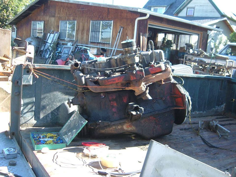

    I've got the industrial strength fan that bolts on that hub out in the garage.
    That one was on a flathead that was used on a wind machine in an orchard with a 12 ft wood prop on it. IMG_8114 (2).JPG
    The issue on my 48 is that on the 292 just as on the 250 the fan is way down there several inches lower than it would be on a 216.
    This being the before photo from tthe day I picked up the 292.
    this being a 216 from the net

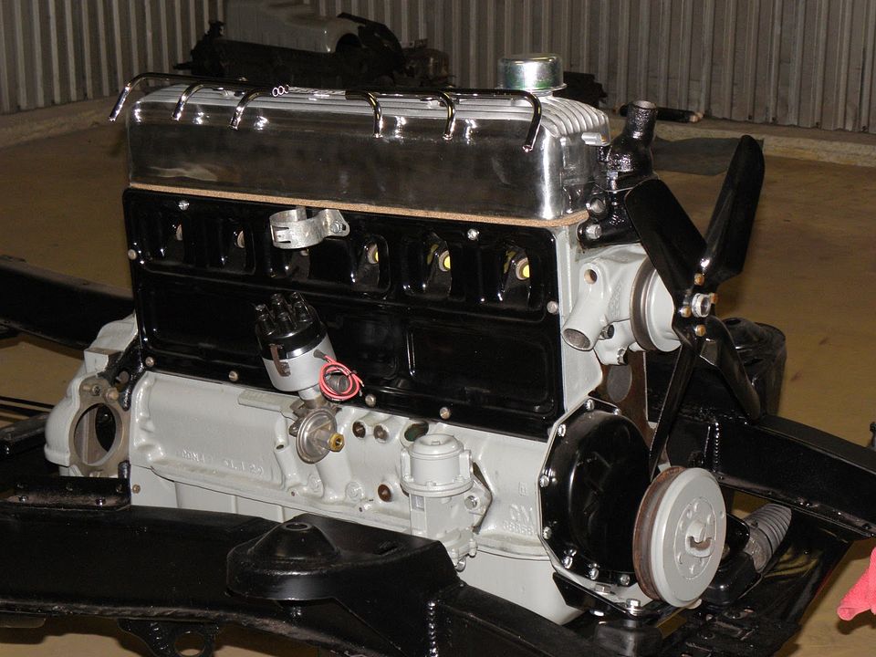

    I can give you a few more data points for comparison. I am using a late 8ba flattie with a mechanical 6 blade truck fan, the stock 5/8" wide crank pully, Drake truck pumps, a Superior aluminum rad in a '32 shell, alternator and running the stock hood. It does fit but is tighter than I would like. There is only 1/4" clearance between the crank pulley and the fan blades. In my preliminary mock-up, I had about the same clearance between the rad and fan blades. Not enough but when I re***emble the car, I'm confident I can move the rad deeper into the shell without too much trouble. In theory, the fan will flex away from the crank pulley.
    Nothing happens too fast around here but I'll let you know how it works when its back together. DSC07019.JPG DSC07020.JPG
