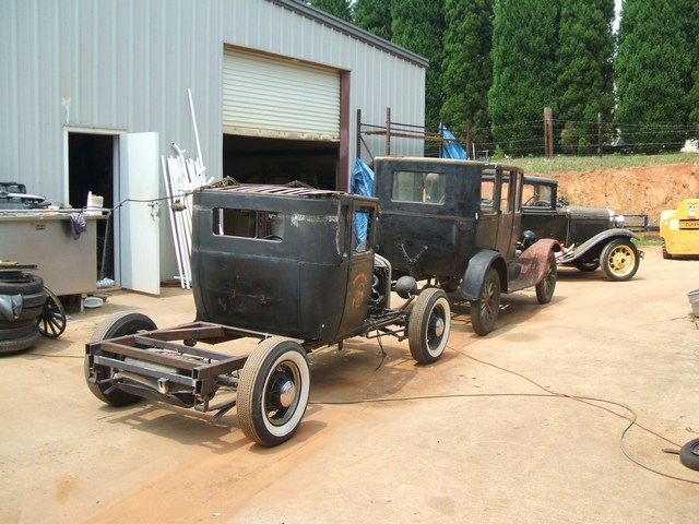

    The 27 T closed cab p/u is getting closer to being drivable. Here are some pix.

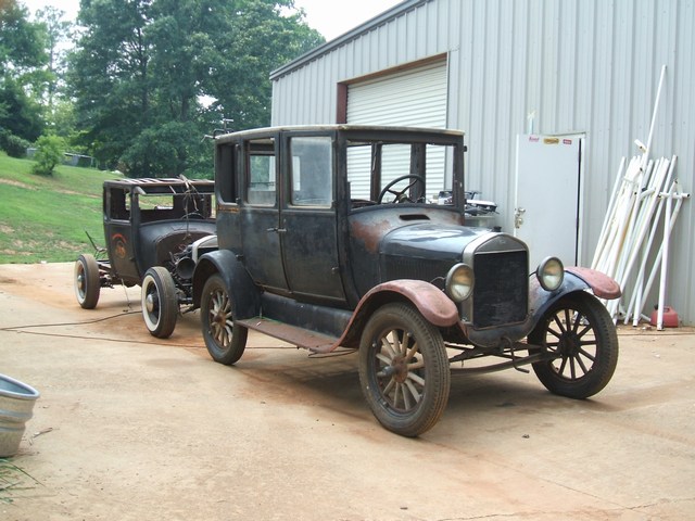

    Take off of a traditional Hot Rod. It is based around a Suzuki powertrain. With the looks of a traditional rod with the economy of a modern car. It should be able to average around 25-30 mpg. Some of the feature of the T-uki: 1.3l banger, fuel injection, 5spd gearbox, power disc brakes, heater, zoomie header. Original Henry steel with full fenders to be added, 5" chopped top, 16" 35 wire wheels. Everything except for the custom frame rails and sheetmetal is all 93 Suzuki Samurai. This little truck started life as a 27 T fordor. pix for comparison :D
