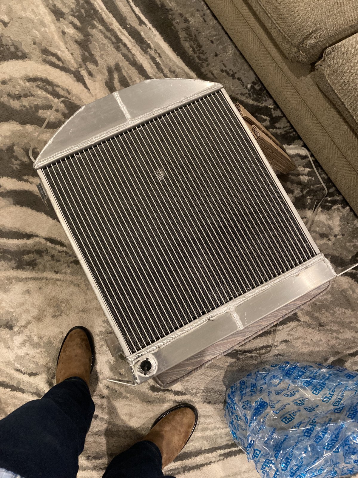

    IMG_0202.jpeg This is the radiator I am talking about. It looked welded to me, but maybe be soldered somewhere on the inside. Since my car is channeled it sits too high. I just have to cut and reweld those brackets 1-2” higher on that bottom part.

    Have you thought of fabricating brackets that would bolt onto the the lower bracket? Anneal the bracket that is there and fold it up after the new bracket is made.

    The tubes in the radiator are soldered in place. The outside frame is welded. Welding aluminum requires more heat input because aluminum disipates heat more quickly. If you concentrate the heat in a small area reasonably quickly, it has less chance to spread. So if you apply a "tack" with a MIG type of set up, it doesn't have time to spread. A TIG can control heat well for doing short welds and then letting it cool. The trick is getting it clean with a stainless wire brush and then being able to realize when it becomes molten. With a Mig you just have to get it set right before you apply the weld so that it doesn't blow thru, so find what setting works on some similar thickness aluminum pieces. Don't set them flat on a steel table, as the table will absorb heat and your setting will be too high when you do the radiator. Being its an expensive radiator, I'd probably recommend finding a good welder to Tig it for you. Probably $50-$75 if you have the brackets ready to fit up. Then practice Tig/Alum on some s**** stuff.

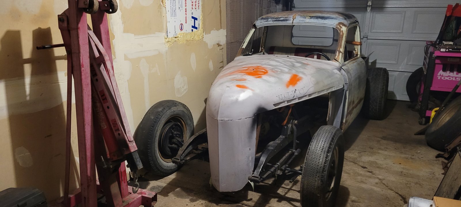

    Sometimes you just have to go for it, I was nervous as hell starting this 1951 ford, but the more you go the more comfortable you get with it.
    Seeing the end product is more rewarding then any bolt on part for sure. Yea cutting up an expensive part is hard but just take your time and measure 40 times before a cut and be careful, that will minimize any mistakes.
    Even if you cut something or it doesn't go right, sometimes the best way of learning, is by making mistakes
