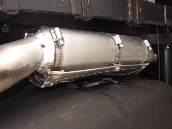

  8. 53CHKustom
    Joined: Jun 24, 2014
    Posts: 1,433
    53CHKustom
    I wonder if something like this could work. I don't know what type of material was used. Anyone have a clue?
  9. atomickustom
    Joined: Aug 30, 2005
    Posts: 3,407
    atomickustom
    You can put a heatshield directly on the exhaust like that photo you showed, but I would prefer your first idea which is to put the shield midway between the pipe and the master cylinder. It will do a better job of blocking the heat if it doesn't actually touch the exhaust.
    And like everybody else including you is saying, either reroute those brake lines or replace the master cylinder to get the lines on the other side. it is just too darn close - The longer you drive the car the more the heat will build up, and at some point your brakes will be dragging.
    Once the line is a little farther from the exhaust, you can also put a heat sleeve over it. I have something I got from Summit or jags that Velcro's over lines on one of my brake lines.
