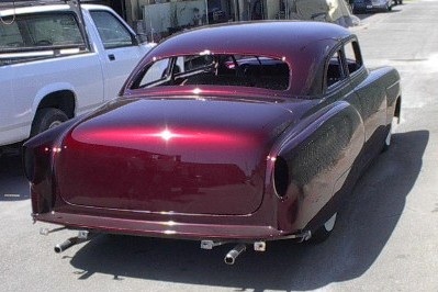

    The frame member forward of the bumper won't allow the pipes to run any higher. I saw Mike Ness' car has a bend just after the frame member like I'm suggesting.

    I did a hard google image search on Chopped 54 Chevy. I recall it coming from Cole Foster's website and it said it belonged to Mike Ness. I think he's the frontman of the band Social Distortion though I'm not really familiar much with that band's music.

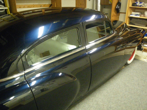

    That is a very nice chop. Really good flow. Any idea what the rear window is?
  24. 53CHKustom
    Joined: Jun 24, 2014
    Posts: 1,433
    53CHKustom
    Thanks. I'm not sure but the gl*** looks kind of flat-ish so I'm not sure how to even find that out.

    Other than asking whoever installed it there's probably no way to ever know for certain. Probably something 1949-52 but no idea what. Could be Chevy but I don't think so?
    I was just curious. Unless you break it you will never have any reason to need to know.
