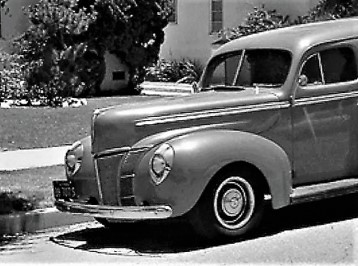

    When we bought our next hot rod project, it was fairly complete, but just needed a ton of work to get it to our standards. Drivability, safety and stopping were the most important things we needed to take care of in the rebuilding process. There were too many things wrong, but the initial purchase gave us a good starting point.
    My wife and I never had a car or hot rod that had A/C. So, this 1940 sedan delivery had a complete A/C unit on the 327. It was a York upright compressor. At the time, the rotary or axial compressors were not available for hot rod A/C conversions or installations. So, something is better than nothing. It worked, made the inside cave cold enough that people wanted to just get in the back to roll around on hot days.
    But, the upright York Compressor had problems and several A/C experts had a heck of a time figuring it out. The cost of a new, York Compressor was not in the cards, so a fix was in the works. Once it was sorted out, it worked fine and I had to recharge it when necessary.
    The York compressor had problems, but it was the one we had and we worked with A/C experts to keep it running correctly. My wife thanked me many times over as it was a mandatory thing for her to have when going places in the 40 sedan delivery, either with me or by herself.
