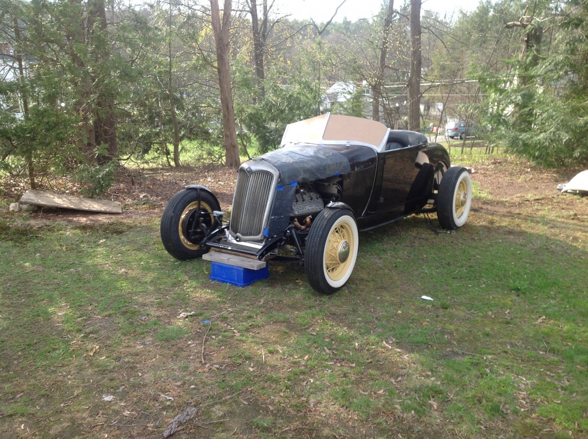

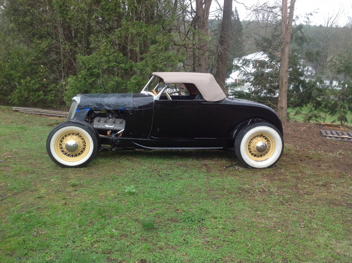

    IMG_1838.JPG IMG_1840.JPG After having a '32 grille on the front of my roadster for 20 years I want to change it by using a grille that has been hanging on my wall for a long time. I want the new grille to lean back like the windshield does and to be something like the grilles on old race cars. In trying to get the proper height and angle of the new grille, I ran a string along the side of the car, parallel to the lines on the top of the door. I am thinking that any line above this string (like the hood top) needs to fall as it moves forward. And any line below the string (like the frame rail) needs to rise as it moves forward, with all these lines meeting at some imaginary point out in front of the car.
    I'm wondering if this is a good way to get the lines right or if there is another, better way that gets the visual part of the car to be right. Thanks for any thoughts you might have.

    The "vanishing point"
    You have a good start on it

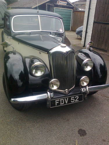

    Looks great,what type of grille is it? HRP

    English based Riley...sometimes things do work despite continental manufacturing divides...I think it looks awesome...;)

    28/29 have a shell that closely matches the height of the new/old addition and this flows with your windshield choice as eluded, so that saying...what is it?...go with the flow.

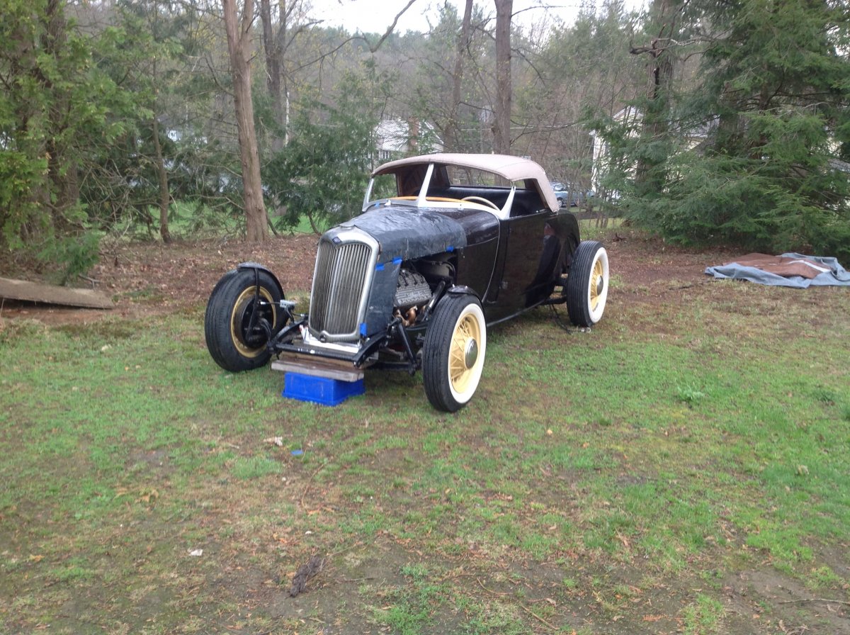

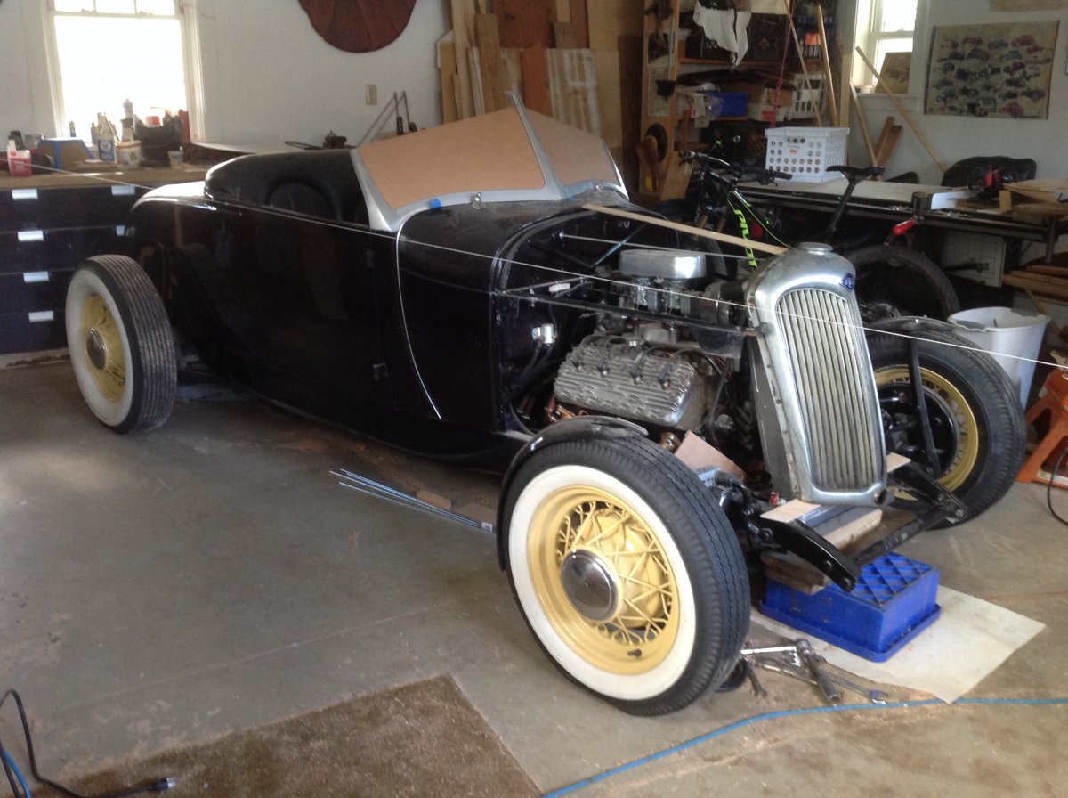

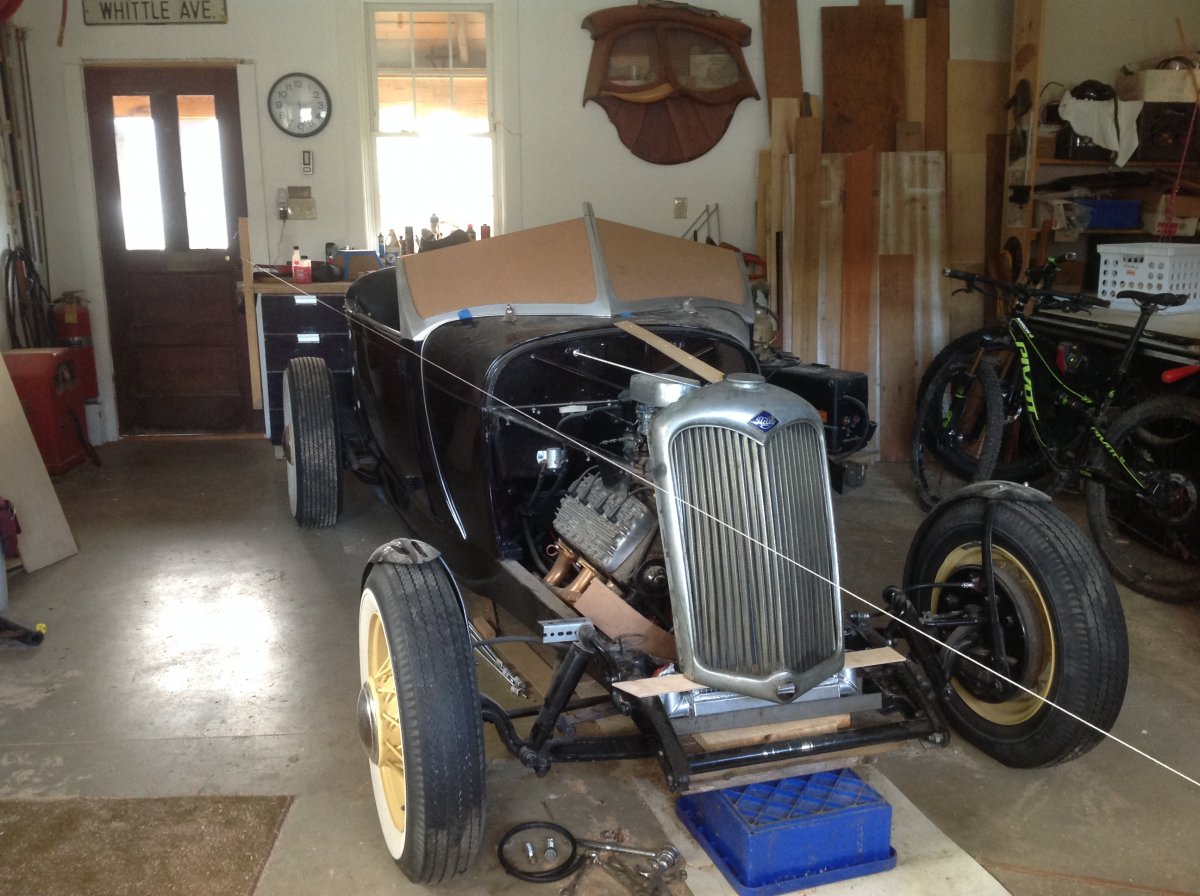

    IMG_1863.JPG IMG_1865.JPG IMG_1864.JPG IMG_1857.JPG I rolled it outside yesterday and made a quick hood using some plywood strips and black plastic. I tried different angles for the grille but I think this is the best one. I also checked it with and without the top.

    Perfect, p***es the fifty foot test in my opinion.

    that grill angle is perfect!
