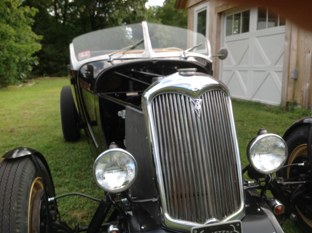

    IMG_1912.JPG Got the grille mounted permanently. The bottom of the grille didn't quite fit the panel below it so I made a small V-shaped piece out of mahogany and painted it black. Now I need to get some gl*** in the windshield.

    That is really, really pretty. How'd I miss this thread?

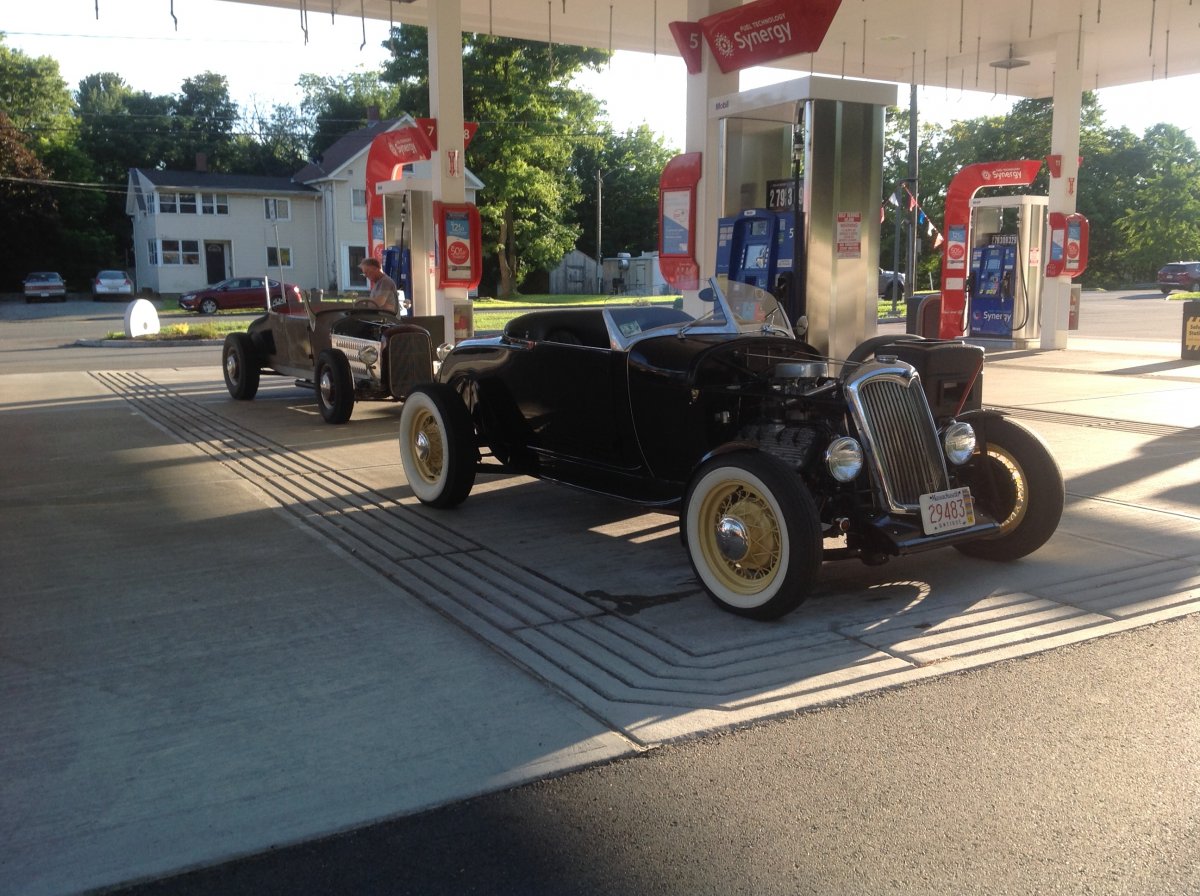

    IMG_2013.JPG IMG_2007.JPG Putting some miles on it now. The new smaller radiator is working. Temps rise when I'm climbing hills, but the fan holds the temperature at 195 or so. It's really nice driving behind the new windshield.

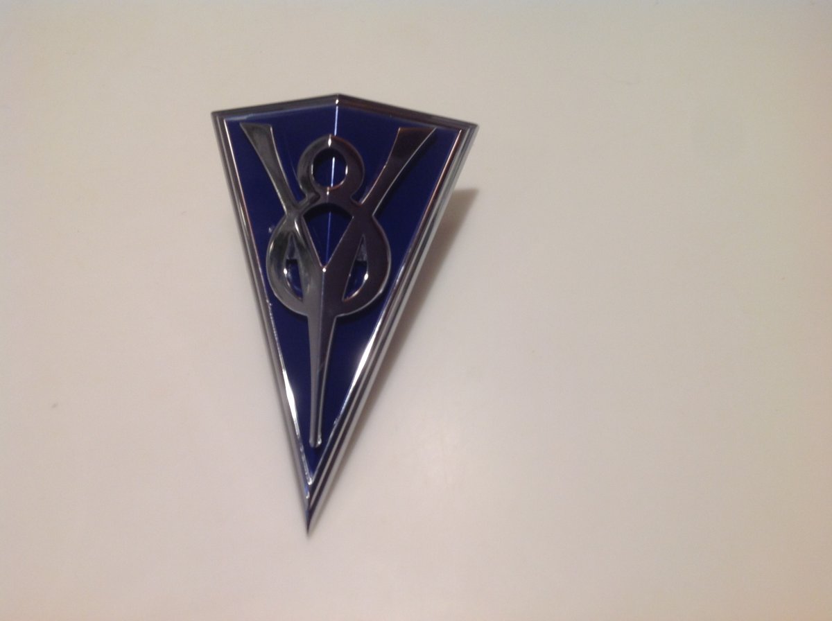

    IMG_2088.JPG IMG_2140.JPG IMG_2145.JPG Lately I removed the Riley emblem on the grille and replaced it with a v-8 logo on the grille bars. I have also made some hood side panels that hide the lower radiator hoses and the sides of the radiator.

    IMG_2090.JPG IMG_2089.JPG I have not made the hood yet. It just got too cold in my shop. But I have been playing with replacing the Riley logo with a v-8 logo.

    IMG_2506.JPG I first made a mold of the v-8 logo using bondo.
