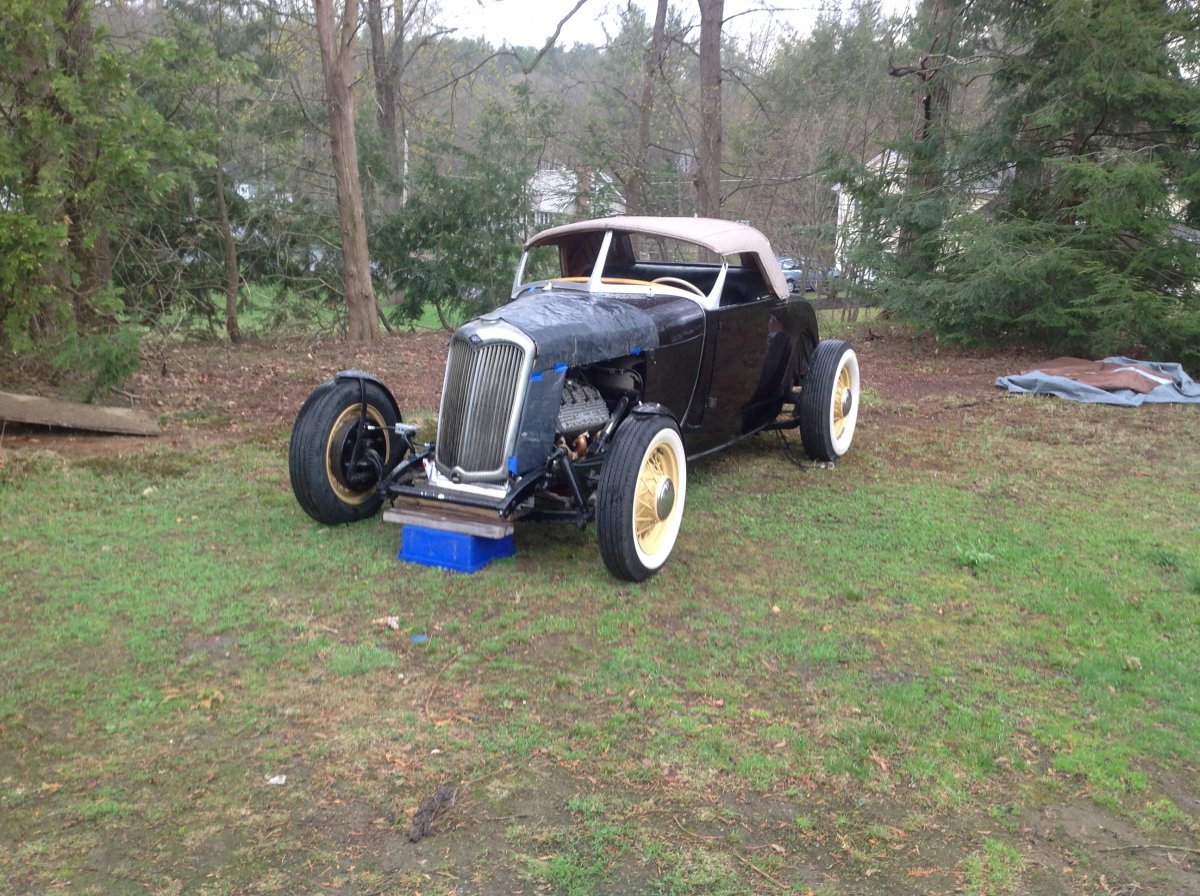

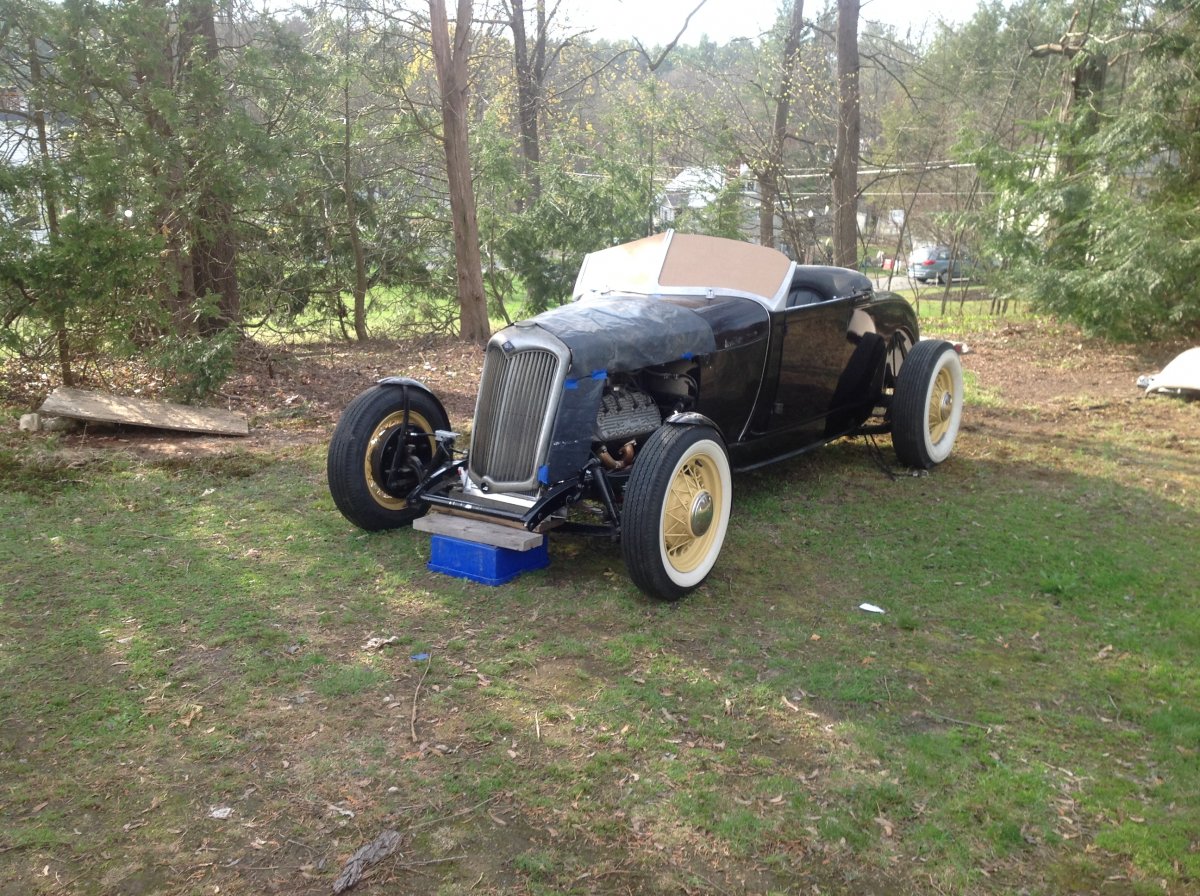

    IMG_2610.JPG I decided that the v-8 logo looked too big on the grille shell, so I mounted it back on the grille bars. I am finally working on making the hood.
  6. The37Kid
    Joined: Apr 30, 2004
    Posts: 32,763
    The37Kid
    I really like the way this turned out, nice work.
    Bob
    Stogy and hfh like this.

  8. Stogy
    Joined: Feb 10, 2007
    Posts: 27,391
    Stogy
    Good call on the V8 Badge...you know what they say...you know if it's right when you see it...
    It looked to large to me as well...you have a cool Hotrod there @hfh...enjoying your transformation...and it's great your on the road as well...

  9. ekimneirbo
    Joined: Apr 29, 2017
    Posts: 4,218
    ekimneirbo
    I think the third picture is about right. Don't know about reaching a vanishing point with this particular car though. The hood needs to continue the same line or plane as the cowl, and it appears to do that and be slose to parallel to the ground. I think that looks great just like it is. Don't know if its just the ground its sitting on, or the blocks under the front end, but I think just a hair lower in front.....but it still looks great right now.

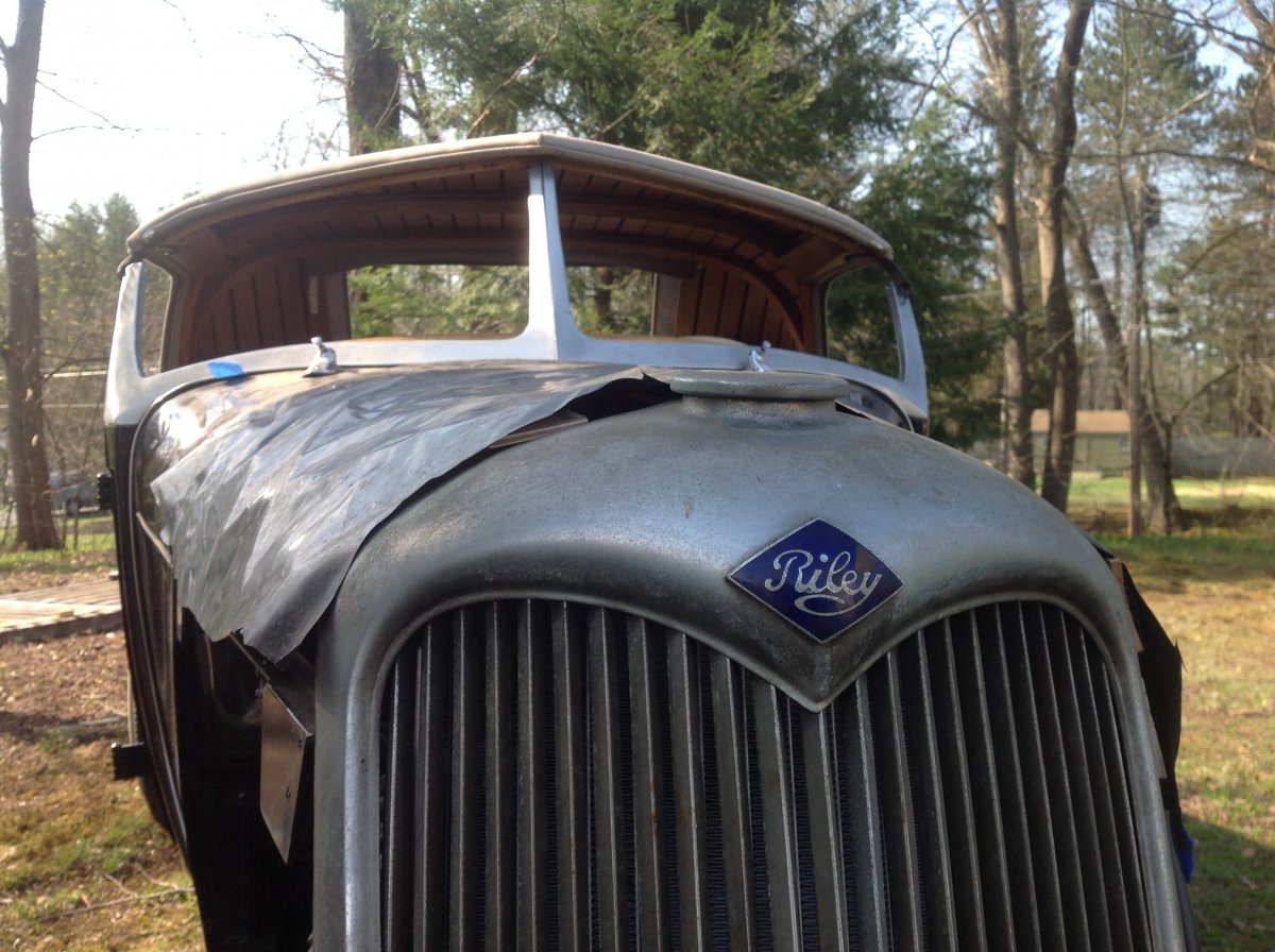

    IMG_2614.JPG I don't know if this is the best way to make the hood parts but I started with a piece of cardboard that was almost the right shape.
    Stogy likes this.

    IMG_2616.JPG Then to that I added smaller, more easily cut pieces to get the edges to fit the grille and cowl. I will trace this pattern on the sheet metal and attempt to cut accurately.
    kidcampbell71, brEad, Stogy and 2 others like this.

    I buy s**** metal....called off fall from a local metal supply warehouse. If you buy aluminum or sheet metal, they have a type of cardboard that's more like a thick sheet of paper. Probably about .030 thick is my guess. I think it would really work well for making a pattern as it's pliable and doesn't have the corrugated stuff. Since you need to buy sheet metal for the hood, you might check and see if your metal supply store has some. It's free when I buy sheetmetal.
    hfh and Fabber McGee like this.

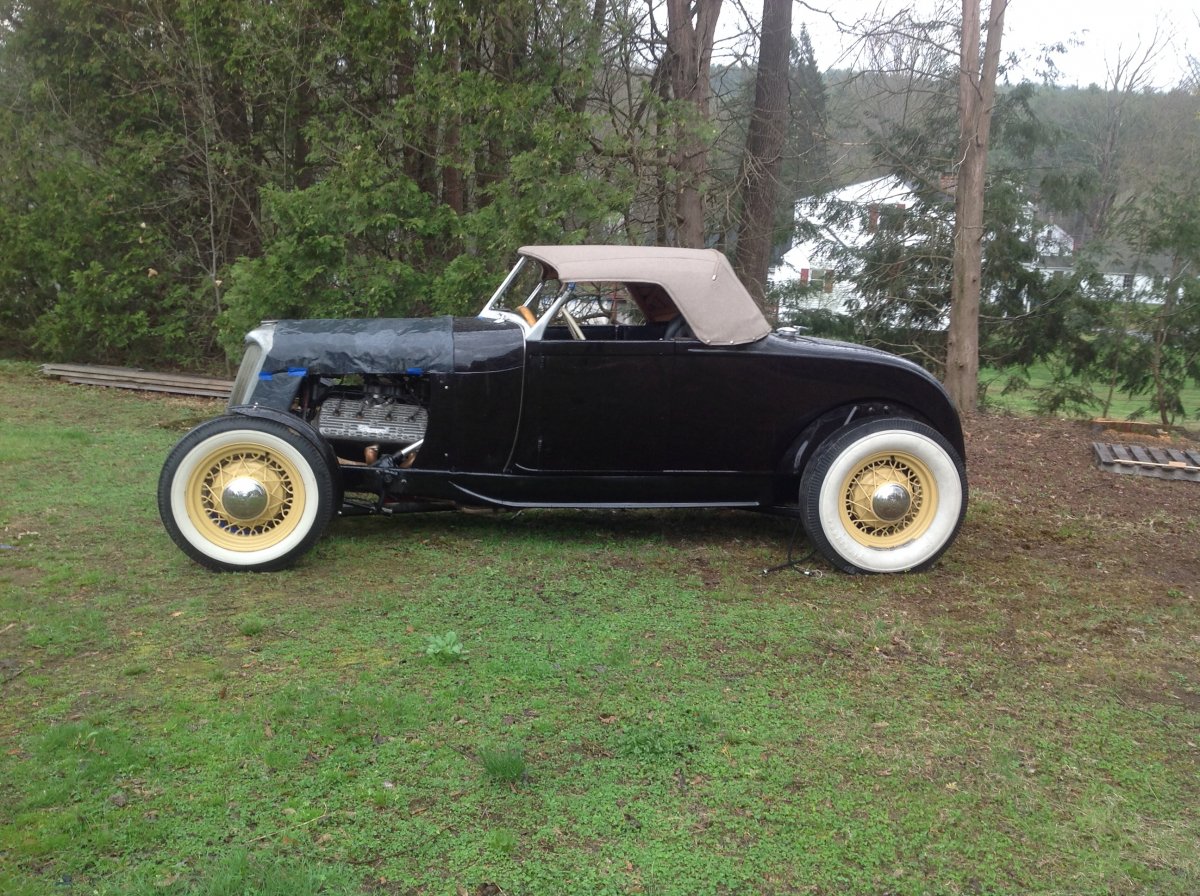

  16. hfh
    Joined: Oct 22, 2012
    Posts: 513
    hfh
    from Western MA
    IMG_2687.JPG IMG_2686.JPG Back to using my strings again. Working on louvers today.

  17. 1-SHOT
    Joined: Sep 23, 2014
    Posts: 2,910
    1-SHOT
    from Denton
    I like the grill with the V8 emblem. The grill and windshield go together nicely and tie into the coach line on the cowel. It almost calls for 33 curved louvers in the sides of the hood just my 2cts worth. I would like to have a Riley grill for my 29. Frank

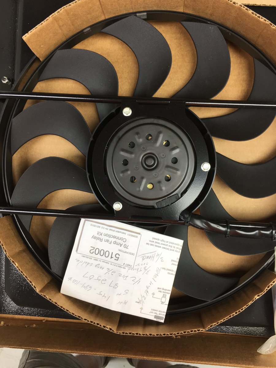

  19. 1-SHOT
    Posts: 2,910
    1-SHOT
    from Denton
    IMG_2345.JPG IMG_2344.JPG IMG_1575.JPG IMG_1251.JPG What temperature did it run before. My tub runs around 180 in traffic and the electric fam turns on and it cools down on the toad it runs about 165 to 170 with a full hood. I have new Drake pumps on mine. When the fan spindle broke and the fan ate the radiator when I was running 75 MPH it came thru the radiator and out the front. I had it recored at a shop that does over the road and heavy equipment radiators because most of the radiator shops now can only crimp plastic Tank's on. That's why electric fan. Here is what I used. Frank

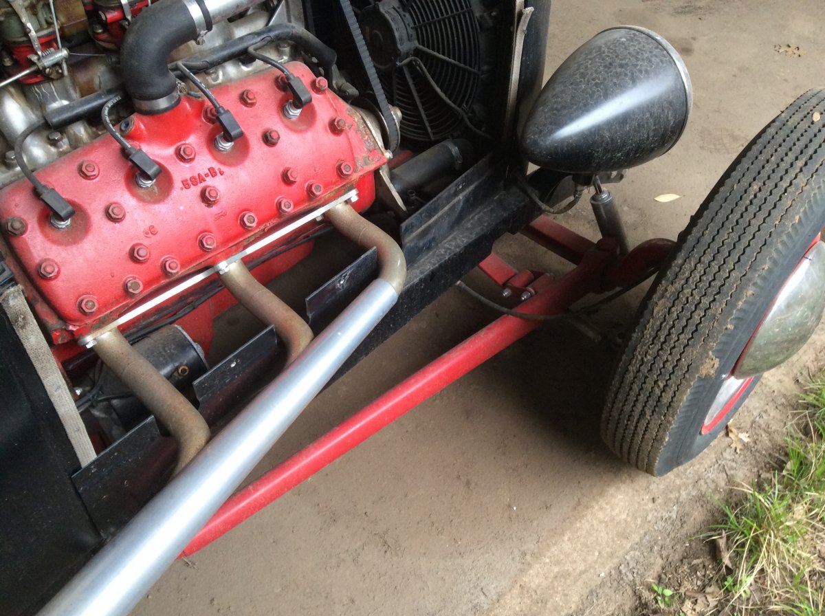

  20. hfh
    Posts: 513
    hfh
    from Western MA
    Frank, that's a nice tub that you have. From your pictures I can't see that you have any louvers. It's great that your engine runs that cool. I think I need to drive mine a bit more and to be more scientific before I panic. ( I think I like the look better with no louvers).My old gauge might not be that accurate. To use the Riley grille I needed to have a smaller than standard radiator made. I think the fan is 16" in diameter and it is set to come on at 185. I also have an airscoop to direct air to the bottom of the radiator. The fan does come on when I am in traffic or climbing a long hill but it does not run when I am moving down the road.
