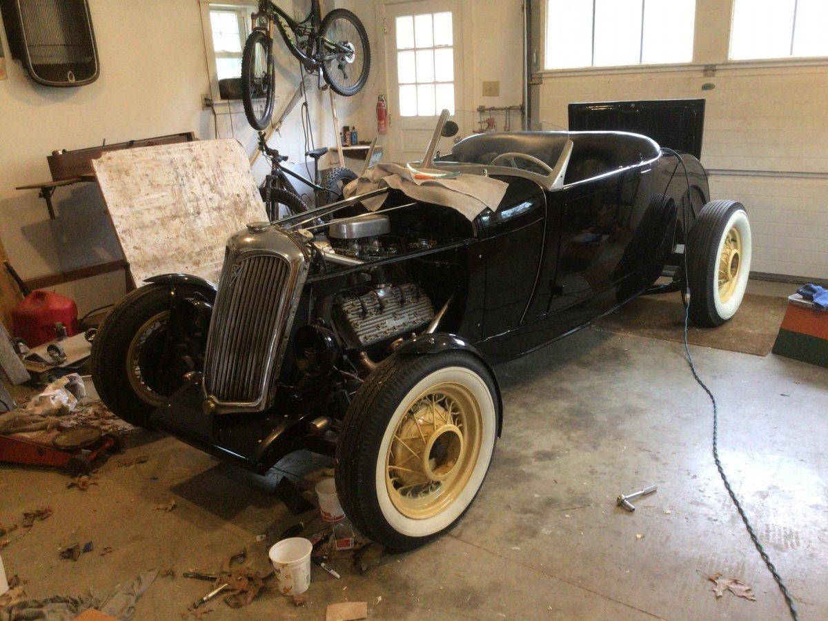

    The new sheet metal parts around the grille needed to be painted and since I can’t match the 20 year old color we decided to paint it black this time. Got it dis***embled in January and sent it off to be recolored. B57B4CB3-0CFE-4CC8-A827-386A249B3E04.jpeg 1929429C-FACB-4BE5-9C88-9C63DA4D5797.jpeg

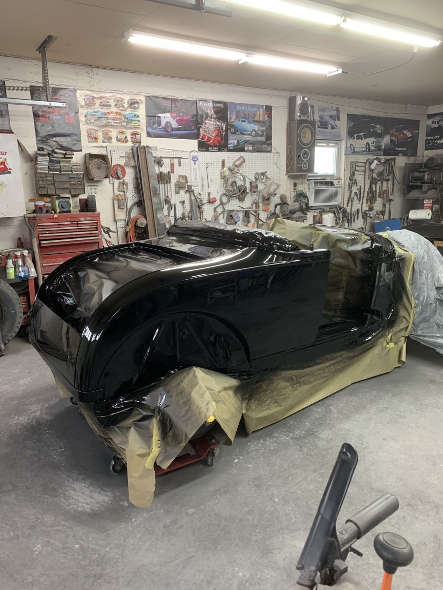

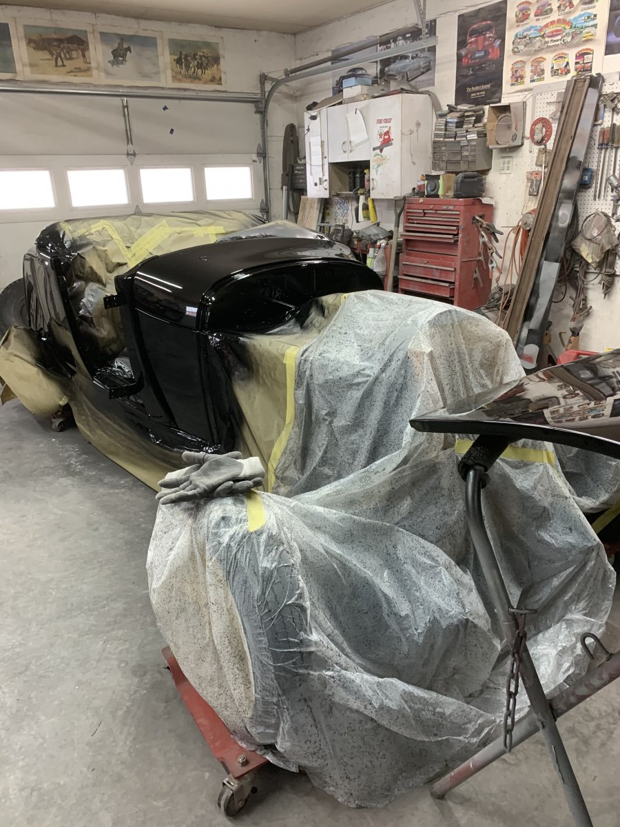

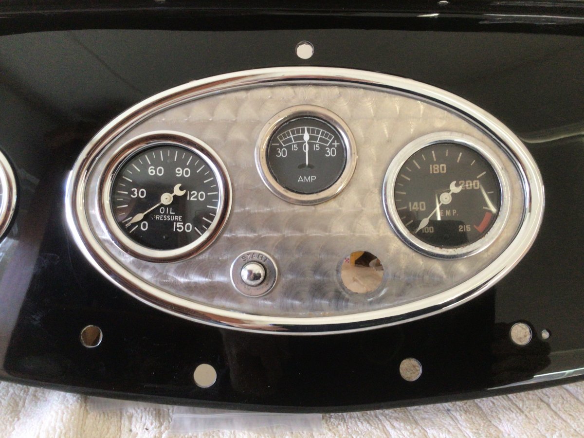

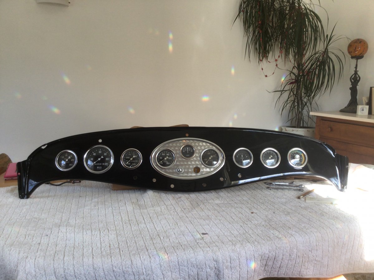

    I dis***embled several of the old instruments so that I could get bezels replated. This meant also replacing some scratched lenses, and using 4777177C-2086-48E9-9E00-42E8F84FD556.jpeg EBFF4BA6-B3B2-483B-A965-836A56B9DD0A.jpeg new gaskets and retainers. All back together now.

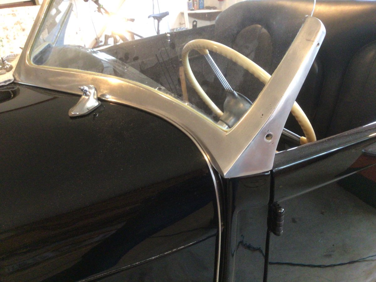

    Slowly going back together now. I like having the chrome fender welting going under the windshield and down the joint in the cowl. I like calling attention to this line and connecting the windshield to the body in this way. My wife was a tremendous help, pushing and holding the welting in place on the outside, 2421E37B-470F-4C94-B8F8-A0F8F1901338.jpeg while I tightened the fasteners inside the car.

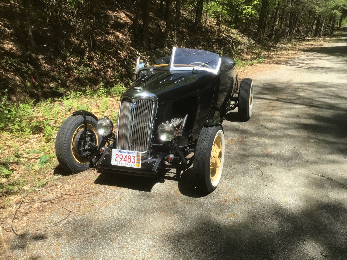

    Finally getting a few miles on it with the new paint. Had to replace a leaky wheel cylinder on the left rear.

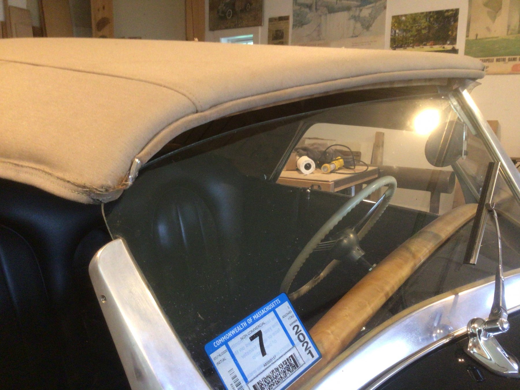

    Many years ago when my roadster had the bronze windshield I made a top that was reminiscent of the tops in old woodies. B7038A79-54FC-4E99-9931-9E3497C63C7D.jpeg
    Stogy, Tman, Elcohaulic and 2 others like this.
  15. hfh
    Joined: Oct 22, 2012
    Posts: 513
    hfh
    from Western MA
    But the old top doesn’t work with the new windshield shape F0D17144-A587-4C87-B166-8ABED222B31E.jpeg

    Hi Frank, thanks so much for all your positive comments. I think the top needs to have a shadow over the top of the windshield. I’m going to make a steel piece that helps me to achieve that, then see if I can adapt it to the old top. It’s all fun for me however it works out. I only drive the car 300 miles a summer and don’t need a top really. But it will be fun to see if I can make it look the way I want it to be. Howard.

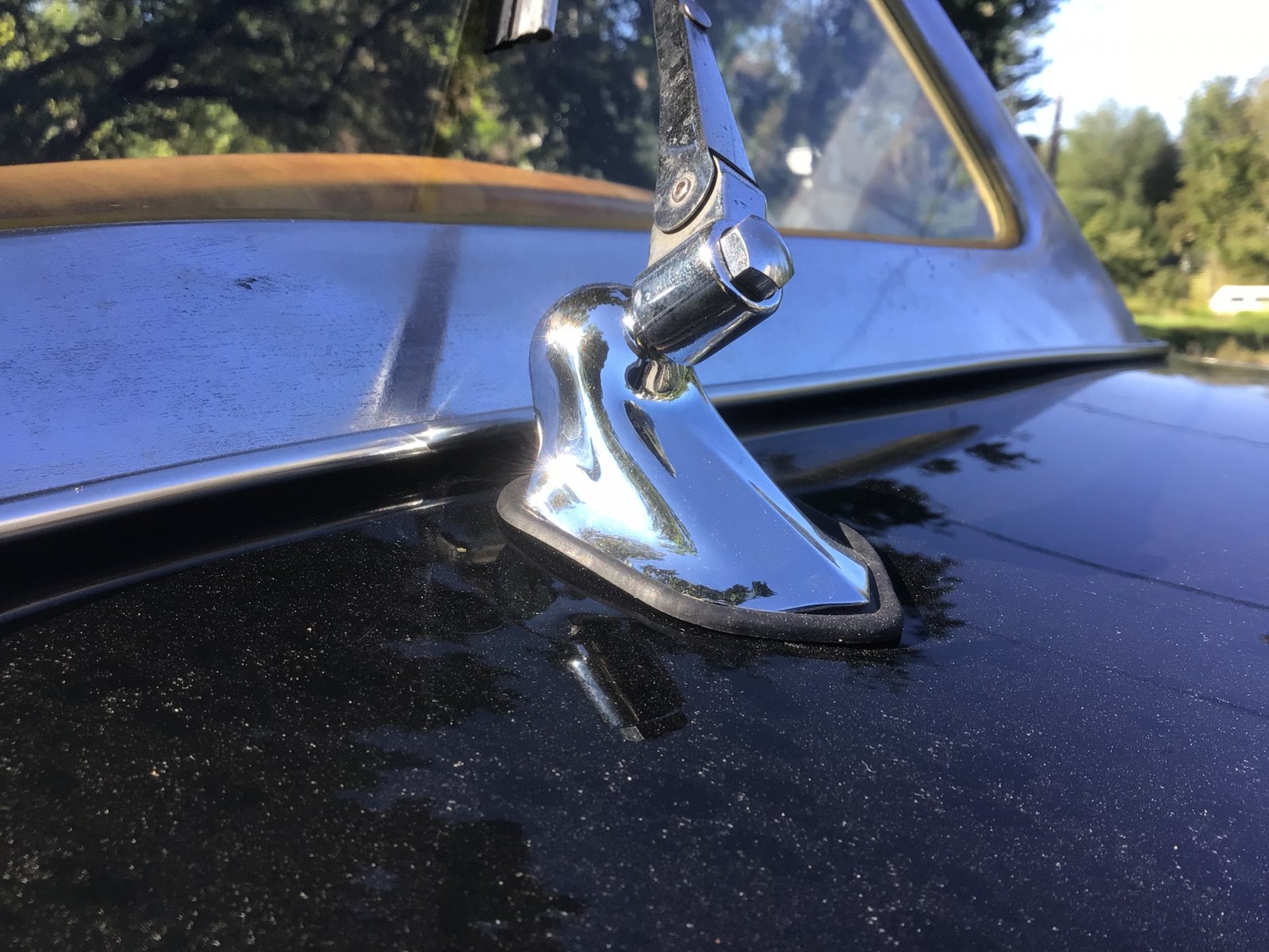

    Hi Frank, the wiper towers are ‘37 Ford. I had to reshape them to fit the shape in the cowl. I think I did that with a file. I still haven’t gotten very far with the top project. But I have some ideas that I will work on this fall I hope. Maybe I will do some pictures in the morning. Hope you are well, Howard.
  25. hfh
    Posts: 513
    hfh
    from Western MA
    This is how the towers fit for the first 20 years. They had the shape that fit the ‘37 cowl. I really didn’t have time then to fit them then. 207B9A39-A2A9-4D94-96D2-D937A7C3F8C0.jpeg

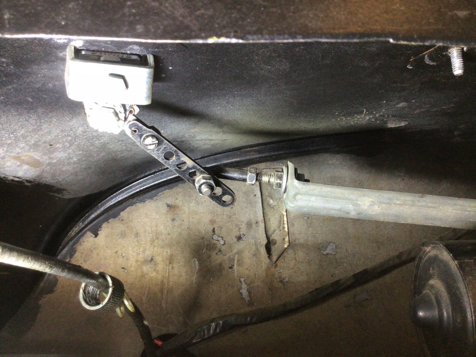

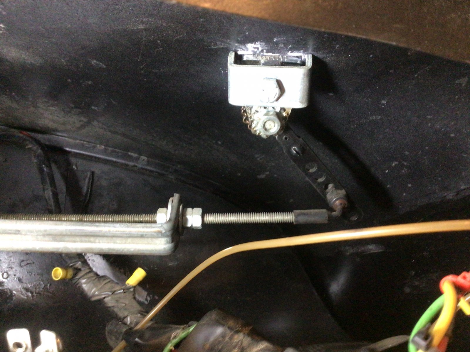

    The wipers are driven with an old VW electric motor. My friend extended the levers on the bottoms of the towers and made many adjustment holes so that we could dial in the sweep of the wipers. 368D3998-FFB4-44B3-97EE-6AA0CD272C77.jpeg E0984BF9-2FF1-475A-822B-42D1BA644F1A.jpeg E0984BF9-2FF1-475A-822B-42D1BA644F1A.jpeg E0984BF9-2FF1-475A-822B-42D1BA644F1A.jpeg
