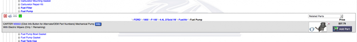

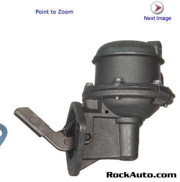

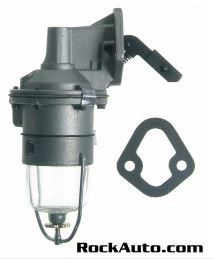

    Im looking for a new (mechanical) pump but i see two different types that are apparently compatible. Can someone tell me the difference if any and advantages of one over the other? Screen Shot 2016-04-12 at 11.25.07 AM.png Screen Shot 2016-04-12 at 11.25.16 AM.png

  7. The rock auto pump is shown upside down. The once with the glass bowl is a ump with a sediment bowl, it is good only if you don't have a filter and are willing to crawl under there and empty the bowl once in a while.
    yes a bad pump will make one hard to start and show a distinct loss in power. probably a good idea to change it.

  12. Both of the pumps you show are for 6 cylinder motors; the V8 pump has a longer lever arm. And neither has the vacuum diaphragm half you should have to help operate your vacuum wipers... unless the wipers have been converted to electric.

    I think that might be the stock photo they use. ... I hope cus i just bought the damn thing just before i read your post. :/ And yes the wipers have been converted.

  14. If your information is for a Y block you should get a pump for a Y block and getting one with the diaphragm vacuum pump is going to be pretty rare you almost have to go NOS these days to find one with the vac pump built in.
