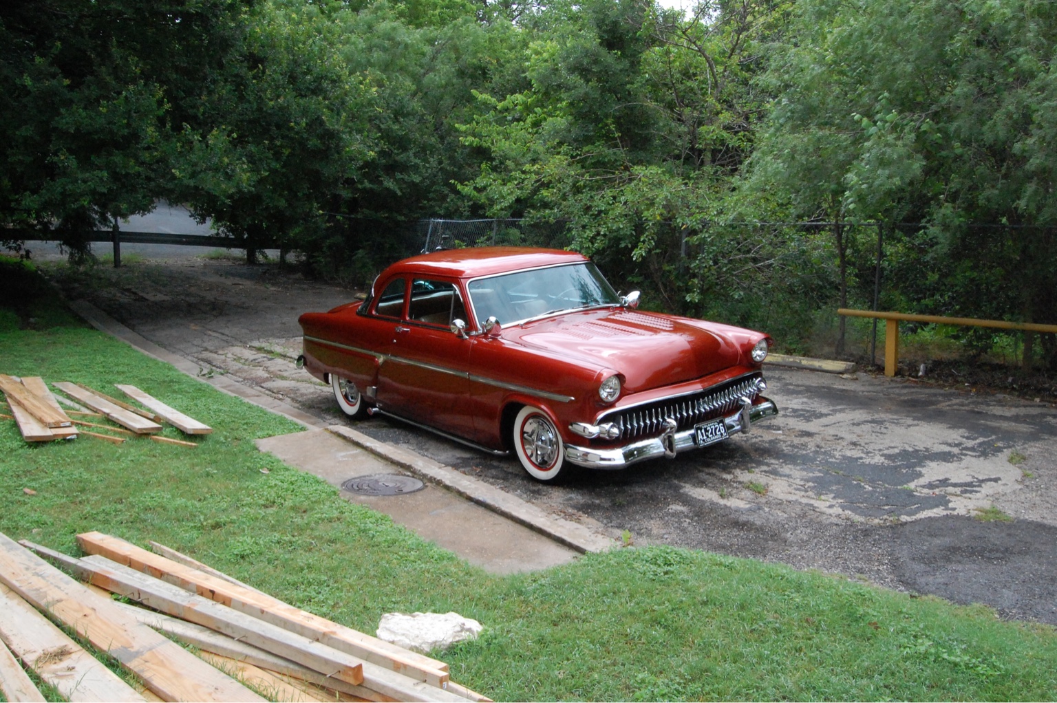

    She's on her way to the shop. We shall see what the problem is real soon. [​IMG] [​IMG]

    Update***
    I took it in to the shop and the carb was gaumed up. They rebuilt it and adjusted the valves and set the timing. She's running but 2 cylinders aren't firing so my options are to rebuild or a "new"er motor.
    But on the upside I've had time to treat the exterior. Here she is now. [​IMG]
  17. Atwater Mike
    Joined: May 31, 2002
    Posts: 11,618
    Atwater Mike
    I have a '54 Coupe also, but my 'Custom' was a '53 Vic. (my '54 is a 'businesslike street toughy')
    Your Coupe with its custom appointments is as striking as ANY Victoria, convert, etc.
    Everything looks just so right. Get those mechanical problems ironed out and enjoy.
