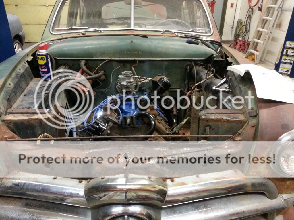

    We've began to pull the engine. I also buffed a small area of the paint, just for the fun of it and to shoe the kids how easily paint can be restored.

    As we begin our engine teardown, does anyone have any suggestions about a budget rebuild for an occasional driver? We're not looking for big power or anything. Just want it to run and drive! I'm seeing options for 3 ring and 4 ring pistons. I'm going to mic everything and determine what we'll need to do. If we could get away with just new gaskets and rings I'd do it. We shall see...

    Yeah, I think we just have a compression issue. We didn't narrow it down to what exactly, but we could only get 1 cylinder to 100psi and the rest were under 70. We did MMO and regular oil in cylinders. Tried over a few day period. So we figure a tear down would be good. God experience either way. Clean out the crud. We had already replaced all of the ignition components. If it would have ran, it should have.
    On a bright note, I know that there are a few flathead motors at the local wrecking yard. What is the going rate for a complete Ford flathead? Maybe we could snag a few at a good price...

    On a bright note, it did spin freely right off the bat with little effort. Starter worked. The ignition system worked. I did pull plugs to check and we had seemingly strong spark.
    If we do a teardown, do you guys think we should stick with stock pistons if they are within specs? If not, any suggestions on a cheap/smart option on what to replace them with? Again, we're on a tight budget. We're not trying for anything super special, but don't want to shoot ourselves in the foot either by cutting corners.
