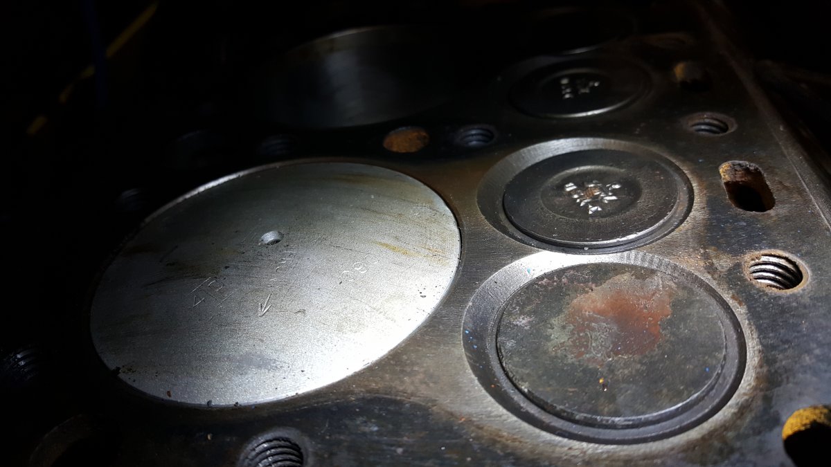

    Got the head off. I cannot see a glaring problem, but the intake valve is obviously not seating.

    As long as you have the head off try this. Open the valve, paint some bluing on the seat, get some lapping compound and a suction cup lapper and close valve and try and to rotate valve enough with the tool to grind off bluing. Then you will be able to see if valve and seat grind match. try both valves in that cylinder. It might be impossible to turn valve but it's worth a try. Worst case is dis***emble guide and spring etc Ralphie
  22. I'm a big believer in Lapping compound. I also make sure it all gets cleaned off. It's way to abrasive to leave on anything inside a motor. My thoughts are, it's time to double check all valves. I'd do that by setting the motor with head gasket surface level and turn motor till I had gap at lifter and squirt solvent on top of valve and watch for them to leak into ports now that you have the Heads off. Way way back when I was just cutting my Teeth I was taught if you can't turn the Motor by hand with a flywheel tool you aren't going to spin it fast enough with a starter to fire it up. Maybe give that a try and see how things feel.

    Perhaps the students previously ground the valves at the incorrect angle? The lash is perfect. Maybe we'll pull all the valves on that side for now, hit them with blue dye (and the seats?), and give them all a good lash.
    We had low compression on all cylinders. Like 20psi on all except 80 on cylinder 2 if I remember correctly.

    So, slowly but surely we are lapping valves. They definitely were not right. Lots of low spots visible after a little lapping. We've been back and forth between the cl*** and shop so it is a slow process.

    Well, it's been a while... We lapped the valves. They looked great, in my humble opinion, but when it went back together, we still had no compression. I had them ***emble the valve on intake #1 and I poured water down the intake runner and the water seeped out from around the valve. Now, the lapping job looks really good, but obviously it is not sealing. I'm looking for a next step? Grind the valve seats again?

    Do you know what angle the valve and seat were cut at?
    Can you get a pic of each after lapping?
    And when lapping, it shouldn't take much on fresh cut valves and seats.
    When they did the seats, did you verify the pilot tool was a nice fit, I wonder if it was loose and you "egged" out the seat?
  30. gijoe985
    Joined: Jan 7, 2015
    Posts: 173
    gijoe985
    Sadly the seats were done like 3 years ago, so I cannot verify what happened. We'd have to borrow a new pilot tool. We borrowed the last one. Both should have been cut at 45.
