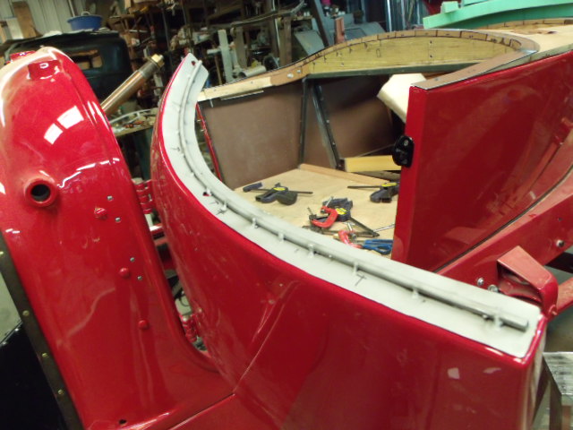

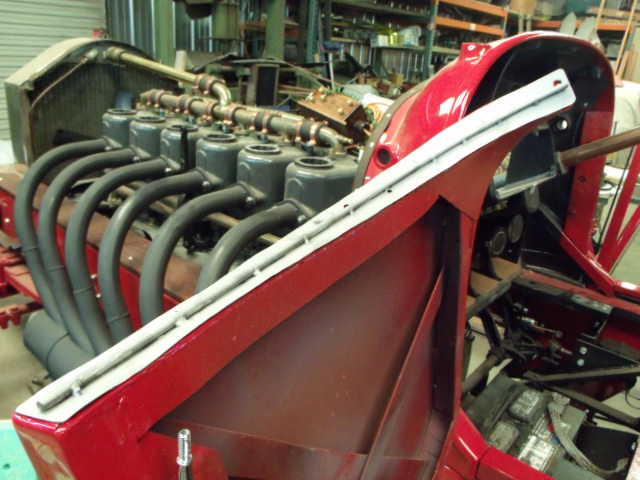

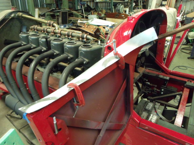

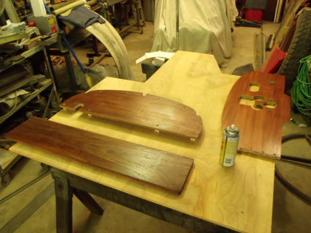

    I'm getting the dash and firewall and rear wood thing (the piece of wood that caps off the back of the ch***is) ready for spraying with clear urethane. To do this I'm taking them over to a vacant unit I've got and setting the pieces up in a little office. It's the only place I've got that's relatively dust free. Once that's done I can permanently mount the dash and firewall. I've been waiting for the sign shop to print out the stencil so I can etch the instrument panel. Once the dash and firewall are installed I can wire up the engine--which shouldn't but a day--then actually start up the speedster and drive it. The sign guy says he'll get to it this week. Other than that I'm also making the metal to hold the roll on top of the door. It's got a real good twist to it so I can't make it out of the same heavy stuff I made the piece behind the ****pit. Therefore I used a 1/4" rod to give it a little stiffness. Seems to work. Once the roll and routing are done I'll get back on the upholstery.

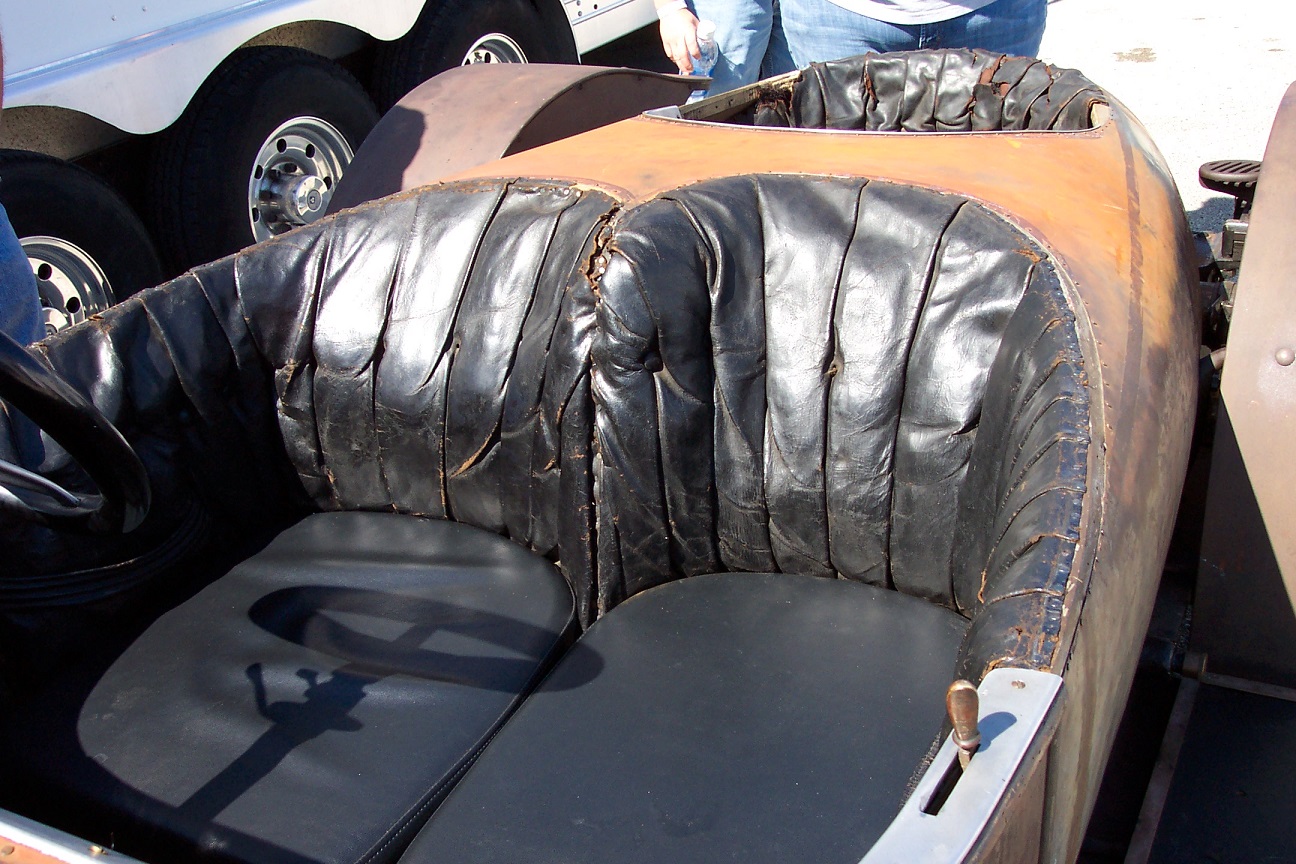

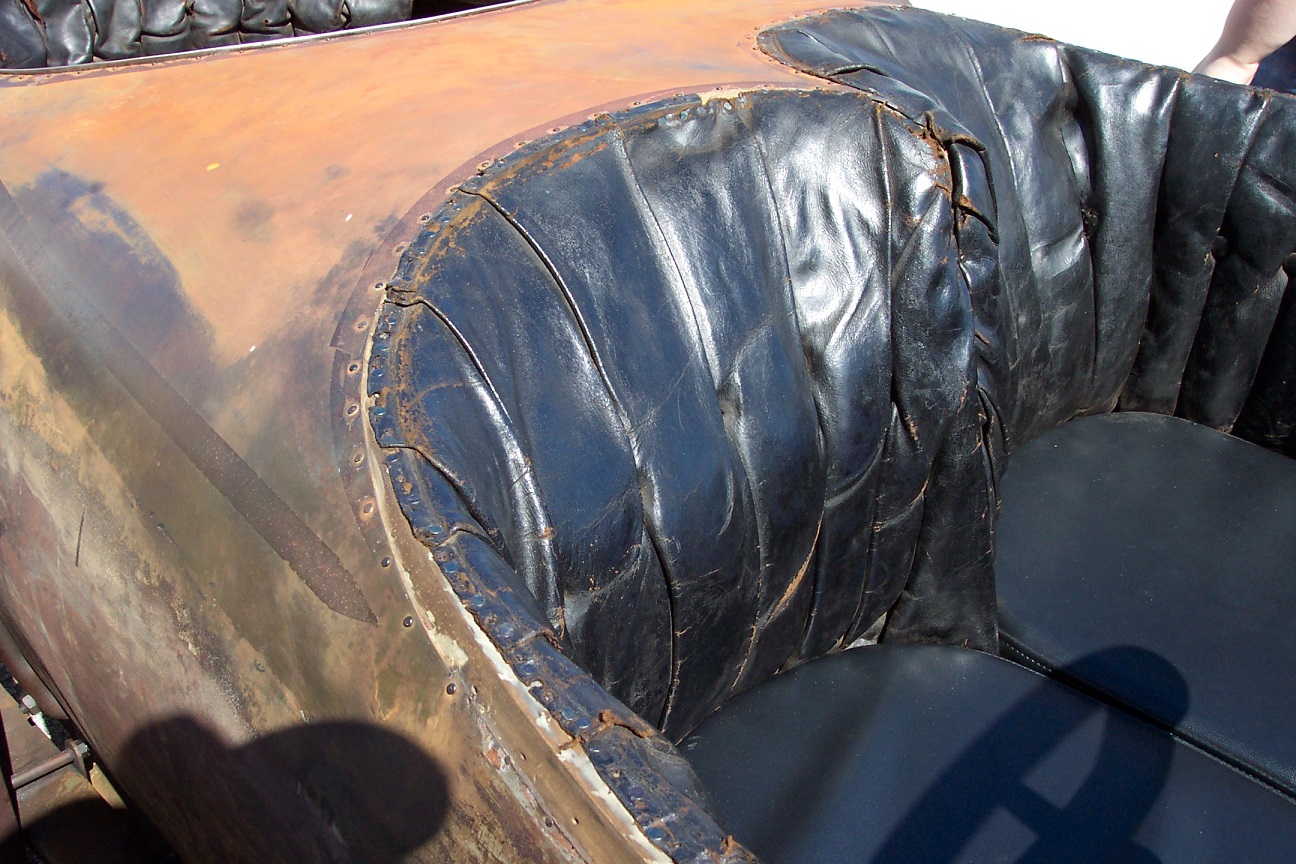

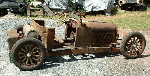

    I took some pictures of a Hispano Suiza speedster at a Miller Meet some years ago for upholstery ideas. Looks like a simple overlap, and a ****on halfway down.

    yonahrr
    Awesome speedster! I don't know why I'm trying to be fancier than Hispano Suiza. Probably should have stayed with my original rat rod concept.

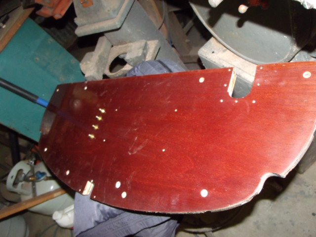

    I sprayed the dash and stuff today. I'll have to wet sand and buff them still. Left my camera at home so you'll have to try and imagine what the pieces really look like. Then I worked more on the roll retainer (you like that name?) on top of the door. One more to go. They're a pain to make! Still waiting on the sign guy.

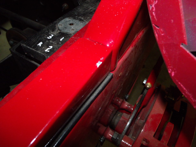

    @#$%! Chip!
    I chipped the paint! I knew it would happen. Here's how it came about. I was mounting the right door and as I shut it gently, it touched the bottom sill and chipped the paint. There will be more. The rest of the day I spent wet sanding and buffing the wood pieces. I could have mounted the firewall but the rod connecting the radiator to the firewall had to have longer threads cut on it and then repainted. So tomorrow maybe I can get things mounted.

    Have you thought about finishing your wood with a varnish or other oil-based finish? The reason is that with poly the finish will not age - it will always look the same - as opposed to generating a patina.

    Really? I'm going to spray some of that on my face. Wait, my wife says it's too late. Damn! The varnish just took forever to dry and I'm a man in a hurry. The firewall is in. Pictures tomorrow.

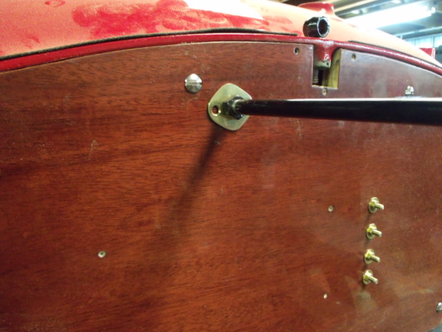

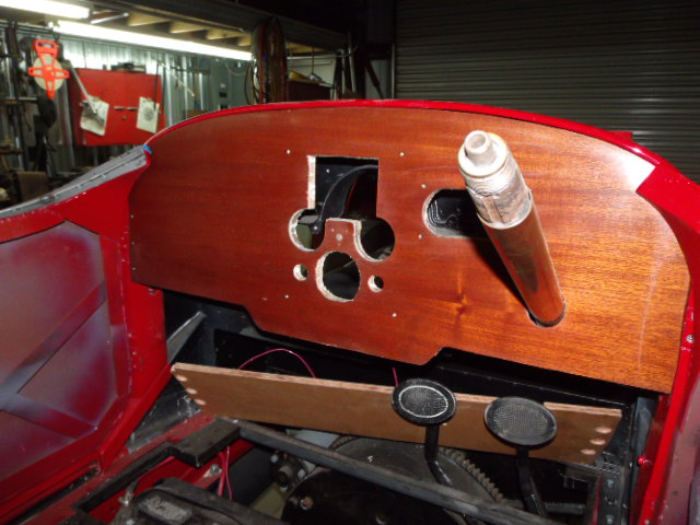

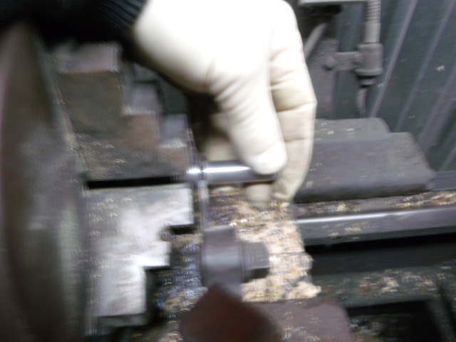

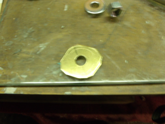

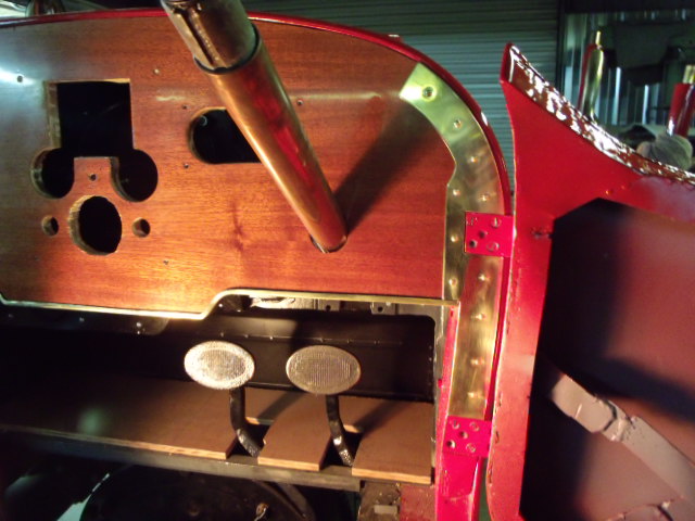

    Two days of work and not much to show for it. I got the firewall in for good which meant I had to mount the rod that stabilizes the radiator. It can't just mount to the wood so I had to make a little sleeve that went through the firewall and hit the aluminum cowl. Then I had to make a fancy br*** plate to cover the sleeve. The rod wasn't threaded long enough so I had to extend the threads. Ever try and hold a 3/8 rod and thread it without ******ing up the rod? I clamped it in the lathe chuck. Of course the paint got ruined so I had to strip it and repaint it. That took all day. Today I made up the br*** plate on the other side of the dash. I had it fashioned by lunch but there was some interference between it and the door so I spend hours adjusting the hinges and grinding here and there to make the thing acceptable. I've about given up on the sign guy and went over to retrieve my instrument panel. I want to go for a drive! He was closed. I'll see him Monday.

    Next time try adding a drying agent. Japan or somesuch.
